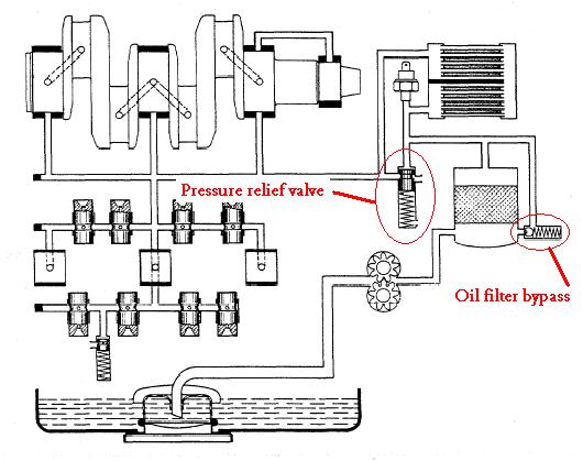

For full flow on a TIV you do what?
Plug or modify the oil filter bypass valve that I've circled below? Then what?
Modify the oil pressure relief valve (new spring I guess) to accomodate higher pressure? Then what?
At what pressure does the stock cooler blow open like a pan of Pop-Magic pop corn?

Oh boy…you can get several different opinions on this one…
“I” would plug the filter by-pass and put a T1 (single relief, heavier) spring in for the pressure relief valve. This I have done with no ill effects.
On my new engine I’m going to stretch the other relief spring (small one by the lifters) a ¼” or so. I’m also planning on reaming and match porting my oil galleys as much as I can.

It seems that there are a couple of methods here (bearing in mind this is a 914 application that will have the factory cooling shroud,etc.):
Method 1) Plug the existing oil filter bypass valve. Compensate on the oil pressure relief valve with a stronger(stretching exisiting also) spring.
Method 2) Some sort of external plate or plumbing that takes the factory filter housing away and sends oil to an external filter and/or cooler. Does this mean that you've blocked off the factory oil cooler and completely rely on the external cooler?
Am I getting it yet?
Kevin
OK... the oil filter bypass valve is just a safe guard in case the filter becomes plugged. All modern filters have this function built in and if you have a major failure (such as a flat cam) it will send metal shards straight to the bearings. There is less chance of this happening with the filter bypass disabled.
The stronger pressure relief spring is to compensate for the increased oil pressure of the 30mm pump.
No, you can do this without removing (the function) the factory oil cooler and have an external filter and/or cooler.
On the upright conversions that Jake does, he uses a Gene Berg pressure relief cover (part # GB 239), this cover makes sure that the oil pressure never exceeds the burst point of the cooler.
BUT this cover is hard to use with a stock engine mount (the part that bolts to the case), as it's in the way.
I plan to build a new (modified) mount to get around this problem. Then you do away with the stock filter housing and use a plate or fitting to return the oil.

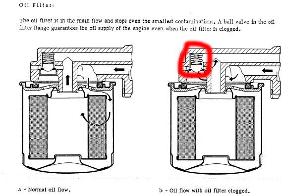

In the Grassroots Motorsports Magazine "Project 914" story on their engine they say this:
Shine Racing Service "removes the oil filter bypass assembly. From the factory, Porsche provided a ball-and-spring assembly to allow oil to flow around the oil filter should it become clogged. While this sounds great in theory, adding something as simple as an external oil cooler will change the pressure to this bypass, causing the oil to simply go around the filter. While we are not presently using an external oil cooler, this oil filter bypass modification is something that Shine does to every 914 engine he builds."
The specific location that they show in the picture is in the top of the oil filter mount. From what I've seen elsewhere about this it simply a matter of taking a punch of some kind and closing up the space.
It seems to me that if you are already in the habit of changing your oil & filter regularly and generally watching over your baby (like adjusting valves regularly and always inspecting the oil screen for debris) that no longer having the relief would be no big deal because the likelihood is so low that you would ever have a clogged filter.
kdfoust

Hey Ernie:
Is this what they work on (circled in red)?
Kevin

Kevin - That's the place! From the picture in the magazine it looks like they did more than just use a punch to close it up because the surface looks very smooth. Unfortunately the text I quoted previously is all they say about it and the web page about the project doesn't add any more (http://www.grassrootsmotorsports.com/914.html) I'm not sure where I saw something about just using a punch.

It doesn't take much pressure to open the bypass, as the spring isn't very stiff.
I removed the ball and spring assy, inserted an aluminum plug and tig welded it shut, on one for a customer. The aluminum doesn't weld too good though - crappy casting.
