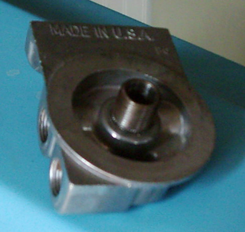

Although the mann filter I have does thread onto a remote filter adapter, I doubt if the Oring lines up on a stock housing.
When I talk about a remote filter adapter this is what I mean:
Mark Henry
post Mar 24 2004, 11:55 AM
Post #23
that's what I do!
Posts: 20,065
Joined: 27-December 02
From: Port Hope, Ontario
Member No.: 26

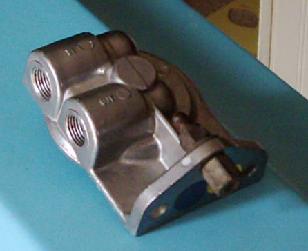

You do away with the stock filter mount and mount this in line to your external cooler. All aftermarket shite.
BTW extra oil in the line (or filter) is not the same as extra oil in the sump. If you have a stock engine stick with an OEM filter, not a FLAPS brand.
