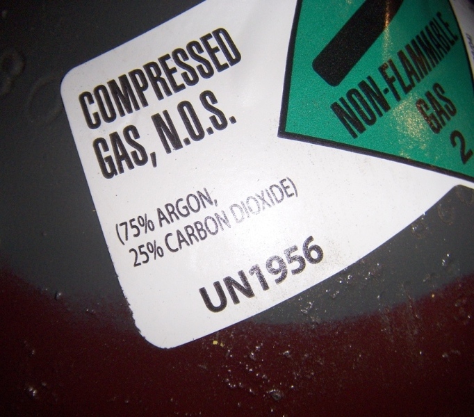

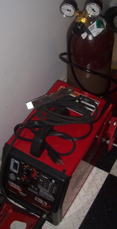

its $35 for a refill of Argon/CO2 on my half bottle. A few pics and the mix ratio from the local Airgas dealer. I ordered a cart after checking the price versus building one. It's not as portable as it was before
