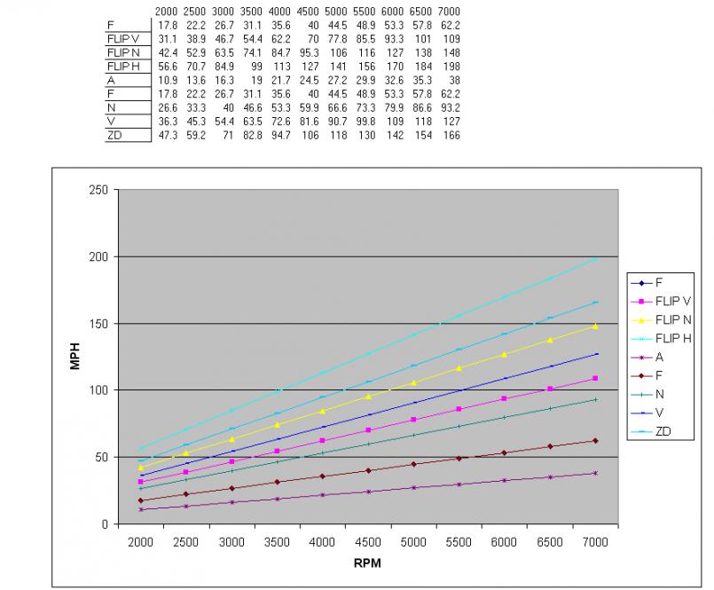

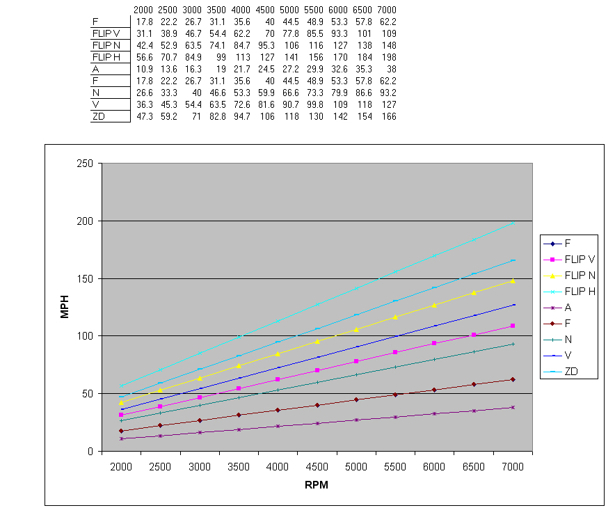

post Dec 21 2009, 10:50 PM
Posts: 848
Joined: 23-May 08
From: Sequim, WA
Member No.: 9,090
QUOTE(wallys914 @ Dec 21 2009, 07:13 PM) *
You guys think the NOS will blow the trans? Even if applied from a roll, in 4th and 5th?
There are some guys running 400hp on a 901, right?
I used to think it was all about the HP, I spent an hour or so on the phone with Rod Simpson one day. He made it real clear thru the many, many conversions he has done, rate the transaxle on torque. anything over 375 ftlbs tq, I would need a 915.
The No2 is fine if your on a drag strip, and have a trans and engine to handle it.
