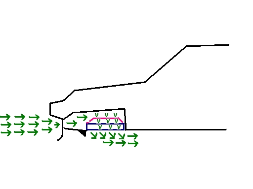

Ok guys... I've seen the renegade radiator arrangement. By all accounts it cools fine but there's absolutely no storage area left after the install. I've been pondering a horizontal placement very low in the trunk cavity with dual fans pushing air down and out. It's reminiscent of the placement of most aftermarket air-conditioning condensers I've seen. I also plan on spotwelding sheet metal several inches above the fans so that I can at least store the spare tire up front. Additionally, I plan on fabricating not only the front air dam, but also a secondary dam just forward of the cut-out to create a low-pressure area below the radiator to help suck air out at higher speeds. Any thoughts?

The only thing that leaps out to me, is that you are now creating a high pressure region right under the nose of the car. At high speeds, this could lead to instability...
Just my 2 cents.... (I am interested in this thread, as I am doing a conversion to water pumper also. Just the subaru instead.) I would love to keep a front trunk!

Interesting concept, but Brett has a point about creating a lift situation and I'm not sure how much storage you're going to save by the time you mount the radiator, hoses, shroud and fan. Having said that, I think it's worth laying out, at least on paper. If nothing else, it might result in a cleaner looking front trunk. If you go for it, of course we'll want pics.

A problem you're likely to encounter is that of creating a sufficient amount of pressure differential to attain enough air flow through the radiator.

Isn't the path of least resistance through a vertical radiator (airstream and all) with the hot air (rising) out the fender wells or up through a cut-out in the hood?
I would think that one could channel up and out the hood with some sheet metal or even fiberglass. However, that still does nothing for front trunk room.

I think that the air pressure thing would not be any different than a teener without the air dam and coolant air ported thru the trunk floor. If you look at the sketch (nice artestry work there Street (IMG:style_emoticons/default/biggrin.gif) ) it would seem as much air would flow under the car without the dam as thru the trunk and with the dam. I think if air pressures were an issue, it would have shown up with the aftermarket A/C systems.
I know there were "low flow" rads used in heavy trucks in the 80s and early 90s. The rad had a separator running along the header of the core in line with the tank, sort of dividing the core into two separate cores. The design was eventually dropped as it was too efficient, it would drop the engine temp below normal operating temperatures on a downhill grade. A normal heavy truck uses around 2" - 3" inlet and outlet lines engine to rad, these low flow units used 1" - 1-1/4" coolant hoses and for a 200 - 300 hp diesel engine that is not much coolant flow. I found this http://www.truckradiator.com/install.html and just wonder if anyone has tried this in such an application.
Andys
Bob,
Did you check the thread in The Paddock entitled "Solving V8 Conversion Overheating?"
