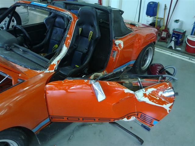

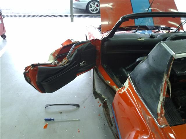

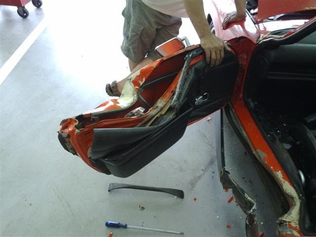

I got a request for parts from this individual in Malaysia who wrecked his 914. I fear that the damage is worse then he thinks and may be difficult if not economically practical to fix the car.
It looks to me the the drivers long is crushed and I would not be surprised if the whole car is bent.
Your opinions please.

rick 918-S   Hard to really tell from those photos but if they ...   Dec 30 2009, 10:33 PM

SGB   I say anything (almost) is repairable. Feasible? ...   Dec 30 2009, 10:47 PM

rick 918-S   I have personally fixed worse wrecks than that. If...   Dec 30 2009, 11:04 PM

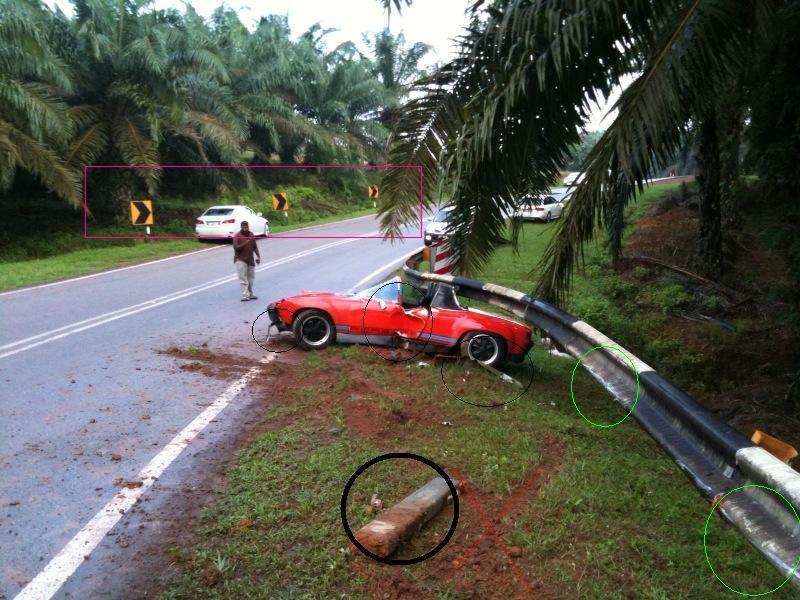

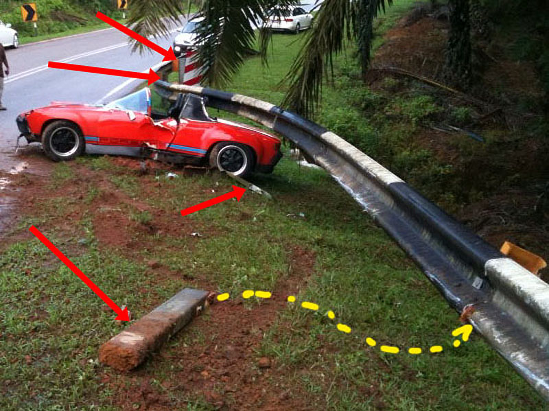

jim_hoyland   Accident photo. There are two 914's in Singapo...   Dec 31 2009, 09:23 AM
jim_hoyland   These may show better detail...   Dec 31 2009, 10:43 AM
zymurgist   Was there a passenger? It looks like that side to...   Dec 31 2009, 10:53 AM
jim_hoyland   Was there a passenger? It looks like that side t...   Dec 31 2009, 12:59 PM
Socalandy   If you look at the accident scene photo you can se...   Dec 31 2009, 11:06 AM

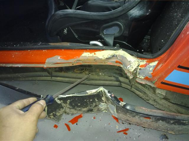

kwales   Ouch! Damage back behind the drivers door at ...   Dec 31 2009, 11:59 AM

Mr.242   Fixable. my .02 worth. Here is my "crash i...   Dec 31 2009, 02:24 PM
Elliot Cannon   Fixable. my .02 worth. Here is my "crash ...   Jan 1 2010, 02:27 AM
messix   [quote name='Mr.242' post='1256844' date='Dec 31 ...   Jan 1 2010, 02:37 AM

bcaschera   The body vamage is for sure fixable, or at least r...   Dec 31 2009, 10:43 PM

johannes   Me says there is some engeneering issue with that ...   Jan 1 2010, 03:01 PM
jimtab   Me says there is some engeneering issue with that...   Jan 1 2010, 04:51 PM
johannes   [quote name='johannes' post='1257073' date='Jan 1...   Jan 1 2010, 05:04 PM
