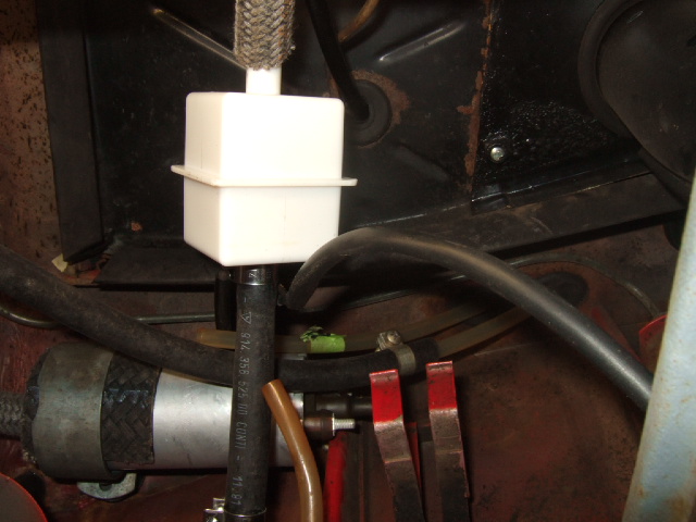

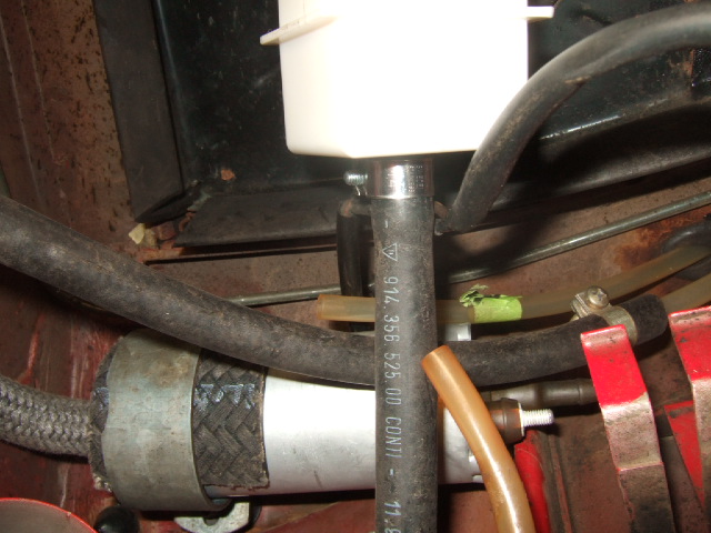

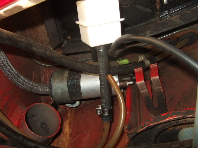

> 75 fuel pump in 73 location. Needs some advise, Captn? anyone whom might have some suggestions
tod914
post Jan 9 2010, 02:19 PM
Posts: 3,755
Joined: 19-January 03
From: Lincoln Park, NJ
Member No.: 170
I just roughed out the placement of the 75 pump in the 73 stock location. Not the best fit. One problem the fuel filter can't be secured in the 73 filter holder. I also think the plastic lines might have to be trimmed. You guys have any suggestions? I'd rather not move it up front. Capt'n is this the way you have done it? Thanks for the help.

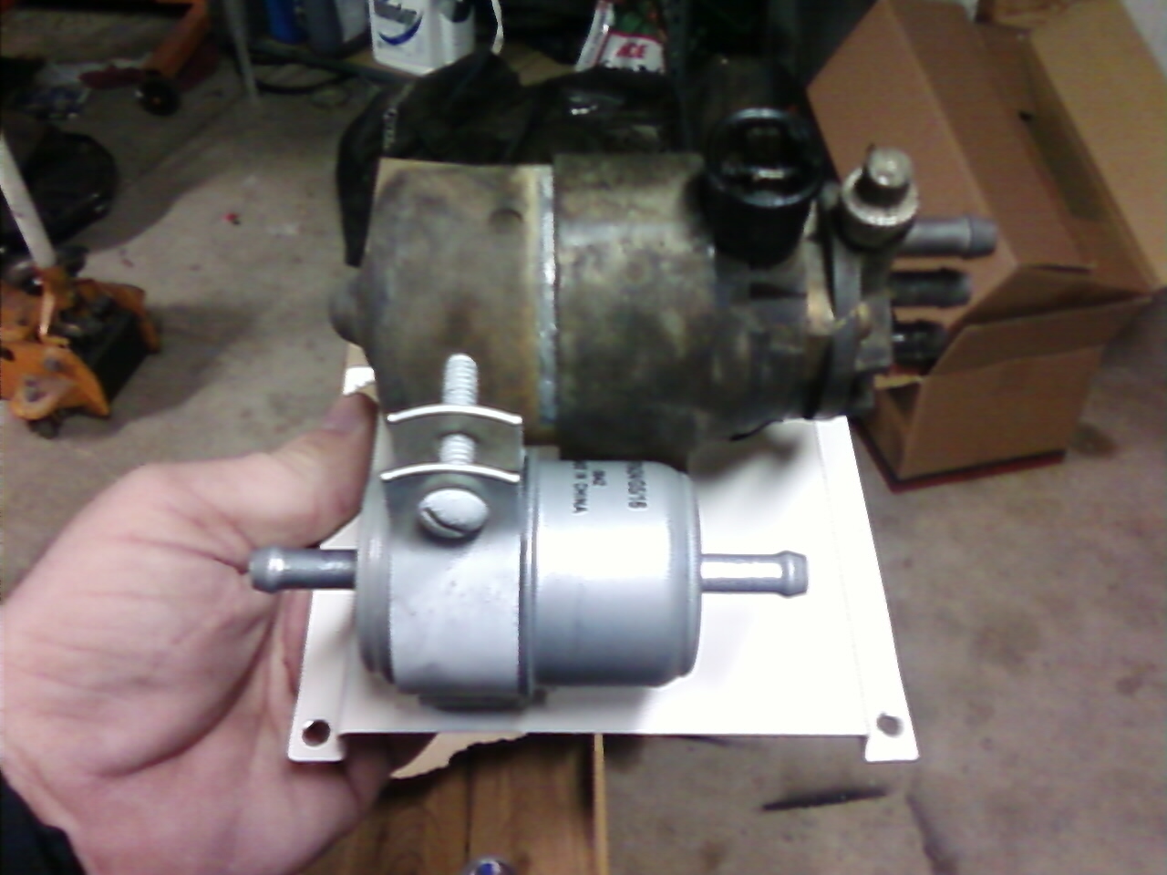

I don't agree with the whole vapor lock thing on a FI car, and it's not really pulling much cause the tank will gravity feed all the fuel out of it. Any way, I made a mount and put it on the lower fire wall. I use a metal filter with 5/16 in/out. The filter clamp is actually a conduit clamp, and it fits perfect.

Think I found a solution without turning it into a major project. By using a set of 1 1/2" brackets attached to the mounts, then another set of mounts attached to the bracket then the pump holder, I can extend it out and pivot it. I'll post shots once I get better brackets. That should give me the clearance I need in the stock location.

Rob, http://www.mcmaster.com/#catalog/115/1362/=5bv148 has the vibration mounts. I was thinking 2 pair of M6 double male ends with "A" having a 1" length and a pair of Z brackets. Probally will order a combo of sizes with male & female to see what works best. Was under the impression this was an easy stock fit. Not the case without getting creative. It seems there are 2 fire walls, so drilling though both of those and removing the back pad is more work than I want to do. One of PO's used sheet metal screws on the fire wall to hold the pump bracket. Pump was ready to fall off. So, the z-bracket solution should be fine.
I'm heading over to Lowes and Homedepot to see what they have. Still have the dangeling fuel filter to resolve. I'd rather not cut the oem plastic lines, but I think I might have to.
Open to suggestions if you come up with something better. I'll take shots once it's all done with a hardware list. Be a few weeks before I'm done with it.

How did you end up mounting it to the wall? Have a shot of the work? Love to see how you did it.
914_teener
post Jan 18 2010, 02:52 PM
Posts: 5,270
Joined: 31-August 08
From: So. Cal
Member No.: 9,489
QUOTE(tod914 @ Jan 18 2010, 07:56 AM) *
Hey Tod,
Yea I will. Basically I used a 1/8 galvinized plate which I mounted with Tek scews and permanant loctitie. Then I used a galv. clamp that Underthewire used for the fuel filter. I carefuly routed and replaced all the fuel lines. The supply from the tank I routed right behind the wirng harness where it comes out of the firewall.
