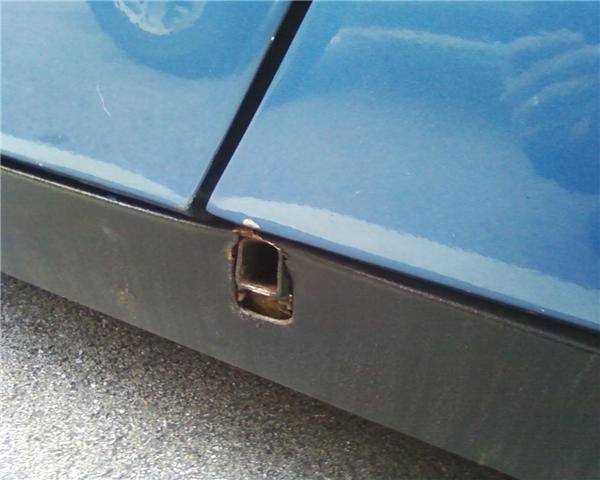

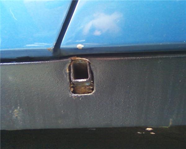

Thanks for the offer Zach, not sure what i am going to do at this point. I am still in tears, the day is shot to hell already. I figure probably have a dropped seat like the world says, my car is in baltimore, 1 hour from my house, my house is in boxes, including most of my tools, since i am in the process of buying another house.
And then i walk to check my car out on my lunch break and find this (IMG:style_emoticons/default/wacko.gif)

Everything can be fixed.
Get the tow bar eyes. You can borrow my tools to install them, and tow the car to your folk's house or something until you close next month. I'd lend you mine, but I think you need to have the car re-aligned after putting them on or taking them off, as you have to unbolt the front of the A-Arms.
I'd say you could park here, but I'm at my limit of vehicles outside.
When you get settled, we can pull the car back home and pull the motor out of it. This is incentive to get the 2056 done. Don't put any more time or money into the 1.8. Drive the Benz, and we will get the 2056 sorted.
As to the jack point... Don't use it as a jack point. Don't worry about it right now. Anyhting broken can be fixed. You can open the doors, and I have gotten into the car without it groaning. I gave it the big butt test when I welded on your battery tray. Whatever rust may be there, it is not terminal.
