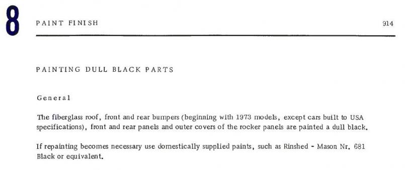

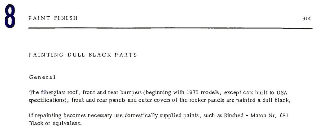

This from the factory manual:

Jeff - the page which you posted above specifies: "...except USA models..." - so was there a different finish on USA spec vehicles??

QUOTE(Jeff Bowlsby @ Jan 19 2010, 12:11 PM) *
Oh wait - DUH - Brain Fart!
They're referring to the Bumpers changing to Black after the 73 MY, not the lower sheet metal nor to the Targa tops.
