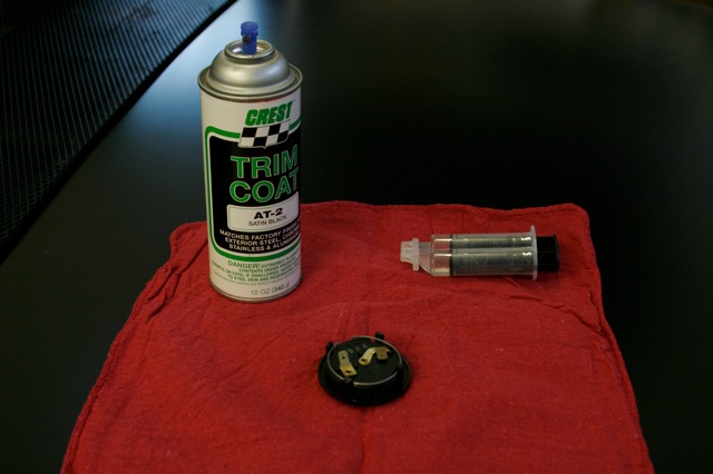

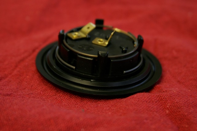

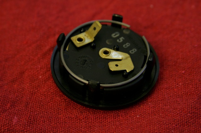

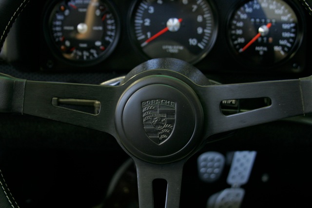

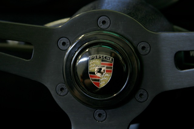

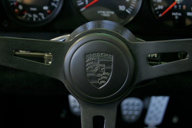

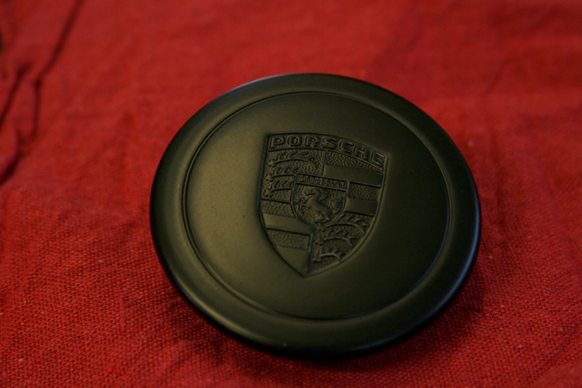

Simple modification I thought of trying. I never liked the MOMO center horn button on my wheel and I was looking for other options. I kept thinking of Fuchs wheel caps but I could never find a Three prong old style center cap (With no holes) in good condition. I found one last week!
To do this all you have to do is grind off the three mounting tabs on the back of the center cap and fit using a 2 part epoxy a slightly modified (grind the edge of the button down 1/8") MOMO horn button. Ben

wow... very nice!

That is a cool mod!
Love your gauges too. Mine are going to look like that as soon as I get my butt in gear and make it that far down the "to-do" list.

Yes, looks much better than the previous button.
A second to the gauges as well, does your engine REALLY rev to 10k? LOL

That is sweet!

Very nice! How about some shots of the work in between momo button and new finished product. (IMG:style_emoticons/default/poke.gif)
