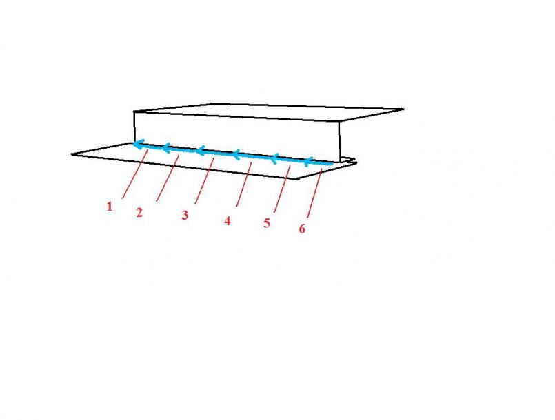

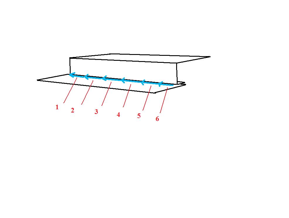

No point in Beveling sheet metal to increase the weld. Even the smallest mig bead is larger in ga than body sheet. Here's a tip for Seam welding. If you have two body panels that are already spot welded and you want to seam weld it to help with chassis flex issues, use the back step method. This reduces the stress in the chassis. I used to weld crane turn tables with this method. Start at the right and move left, start at the right and move left, etc...
Sorry for the crude sketch. (IMG:style_emoticons/default/screwy.gif)

The sketch is not bad, but I do not understand the logic. Do you go back to lets 6 to 5, then back inbetween at the blue point to go back over to 5 again laying a second bead over? Then repeat?

Start at 1. From the right arrow to the end. Then move to two, from the right arrow to where you started for section 1. Then move to 3, from the right arrow to where you started at section 2. Continue till you are done.

Oh ok. That makes sense. That gives the metal a chance to cool, instead of laying a continuous bead.

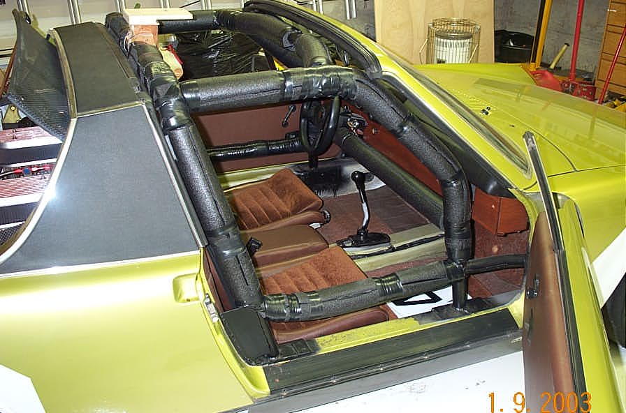

The only time I had shrinkage problems is when I originally put in the cage.
I got carried away ( my first run through with car welding) when I put in backing plates for the tubes.....1/4 inch plates, full fillets & plug welds. Too much welding, too much heat too quickly.....shrunk the door opening on the pass side. That made for some rework.. (IMG:style_emoticons/default/dry.gif) Fixed it and learned from it.

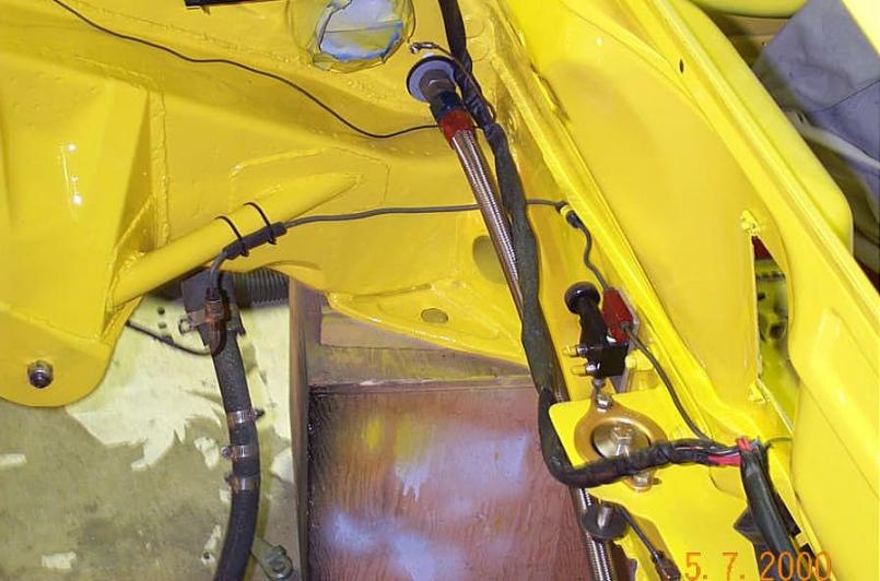

I can show pics of what/where I seam welded. I went after the areas that break/ crack most commonly ( to the best of my knowledge, at the time).
The date on the pic is right for once.

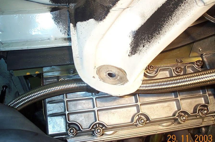

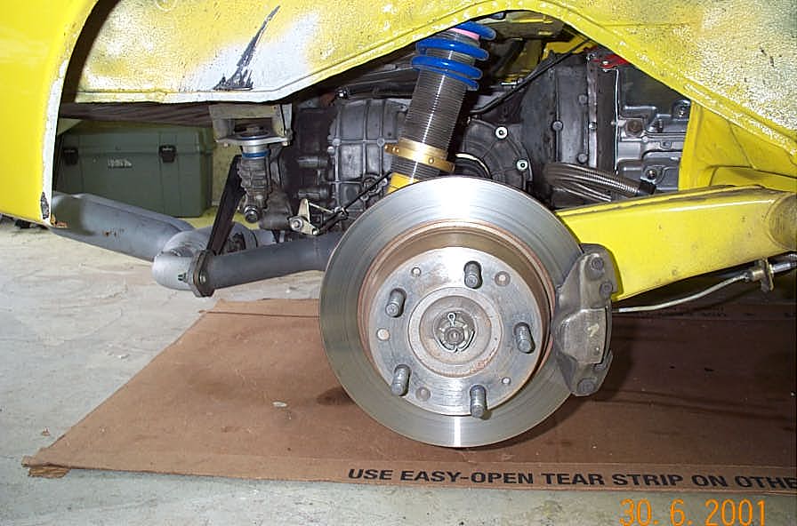

Here's a couple that will keep ya busy.
The first is the pinch seam that runs the length of the long. I welded the sucker together where the 2 halves come together.....from the front firewall just past the trans mount. Grind the 2 halves even....oft times they are not and ya need them clean anyhow + about 1/4 inch up, then do a simple overhead weld without lighting yourself on fire more than is survivable. Lightly grind the the resultant fillet smooth to eliminate kerfs (stress points).
Since you're there, go all around the inner ear using the same method. The arch over the axle & the inner ear are both failure areas. Hitting the small land (bout 3/32 wide) is quite an exercise in puddle conrol.....not too hot (molten globs down your shirt to your belt......BTDT......AAUUGH) & not too cold (no penetration).
If ya get good here, you can weld anywhere. (IMG:style_emoticons/default/biggrin.gif)

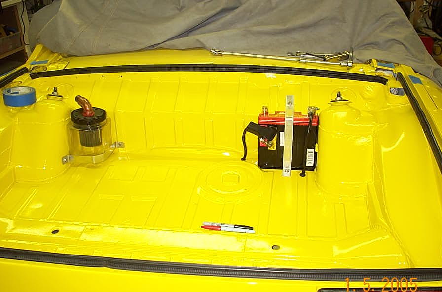

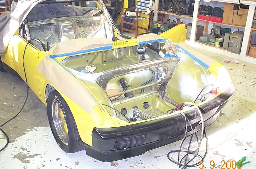

Easier stuff in the engine room, front & rear trunks......practice,practice, practice. (IMG:style_emoticons/default/biggrin.gif) The inner ears are reinforced. The car is built stout and has held up to 10 years of autocrossing on very rough venues.....still going strong, I might add. IMO, you can't make the flexi-flier too strong.
