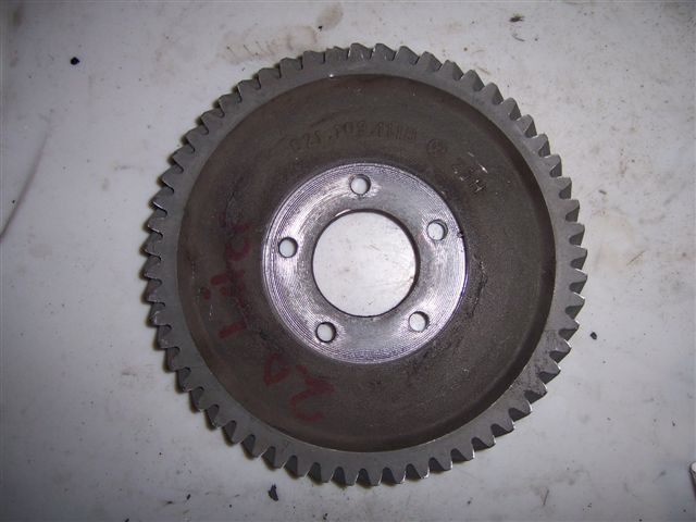

> 021.109.111B, camshaft timing gear

The pic in post 1 is of a -4 size. The numbers indicate size offset from standard, in 100ths of a mm. This is to accommodate differences in the dimensions of the crank and cam bores in the case.
