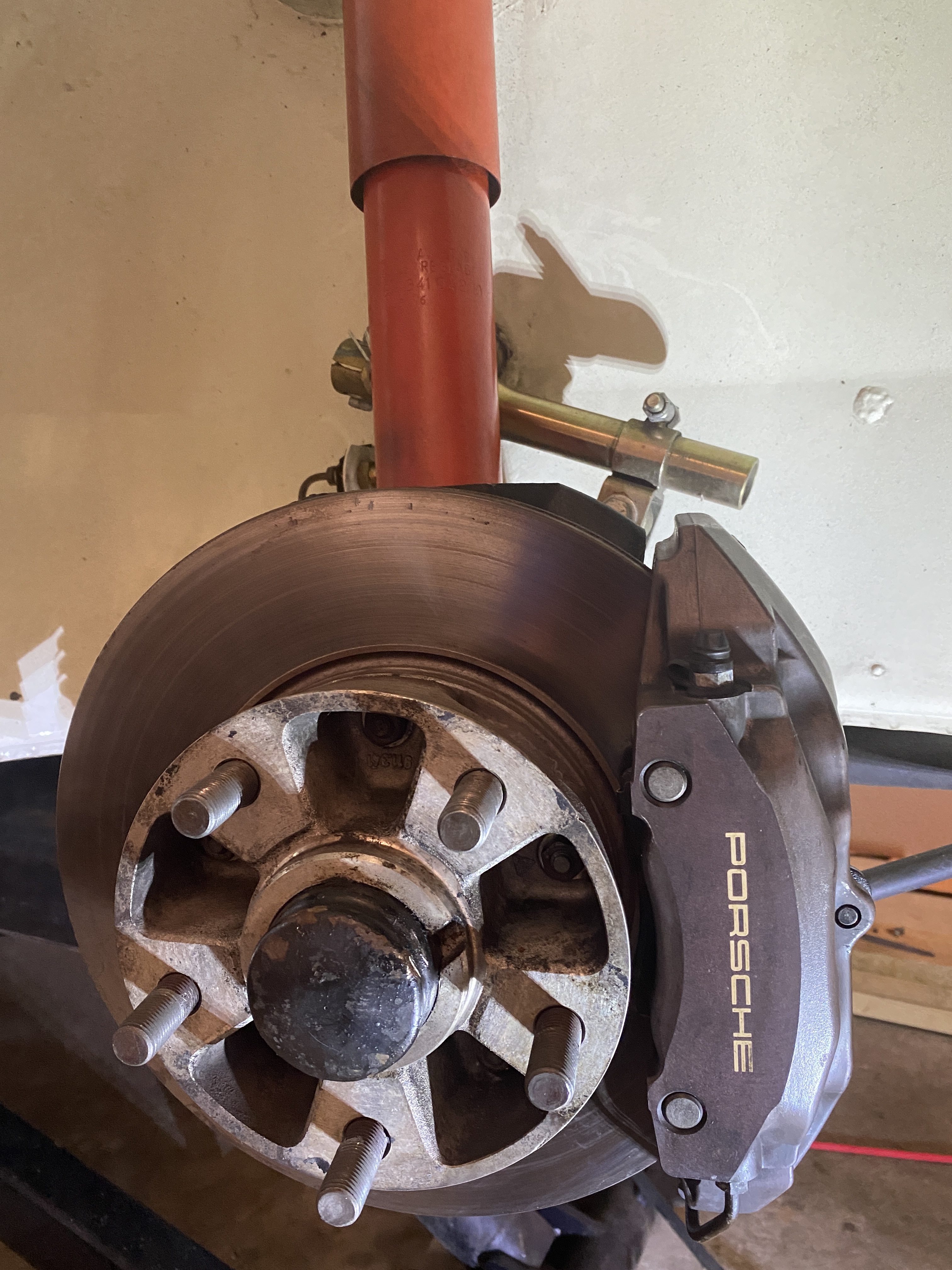

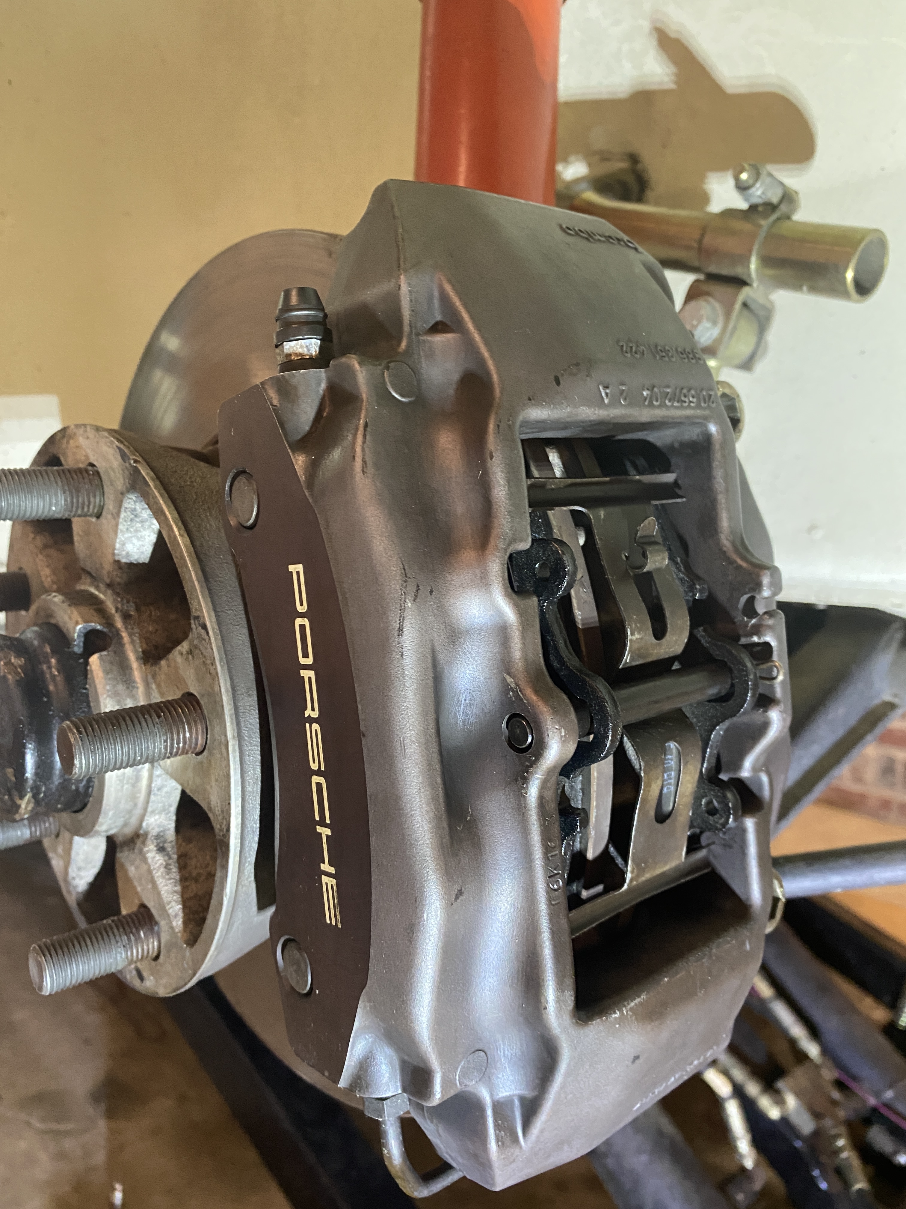

Just adding another data point here. Not nearly at precise as Eric’s work (I only had digital bathroom scales), I installed Boxster non-S, black front calipers at around 6.7 pounds each with the adapters. I already had 24mm rotors with Carrera calipers, so this move saved weight over my existing set up and added braking capacity. Dual pistons and maybe 25% more pad area. They also fit under 15” rims.

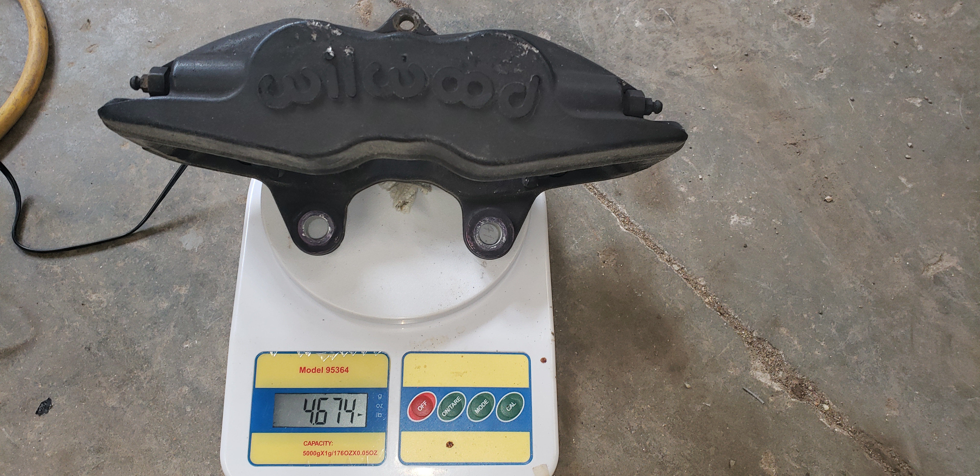

For the track car I'm using Wilwoods at just under 4lbs 10oz. Rotors with hats are 9lbs. My adapter plate adds maybe 8oz...

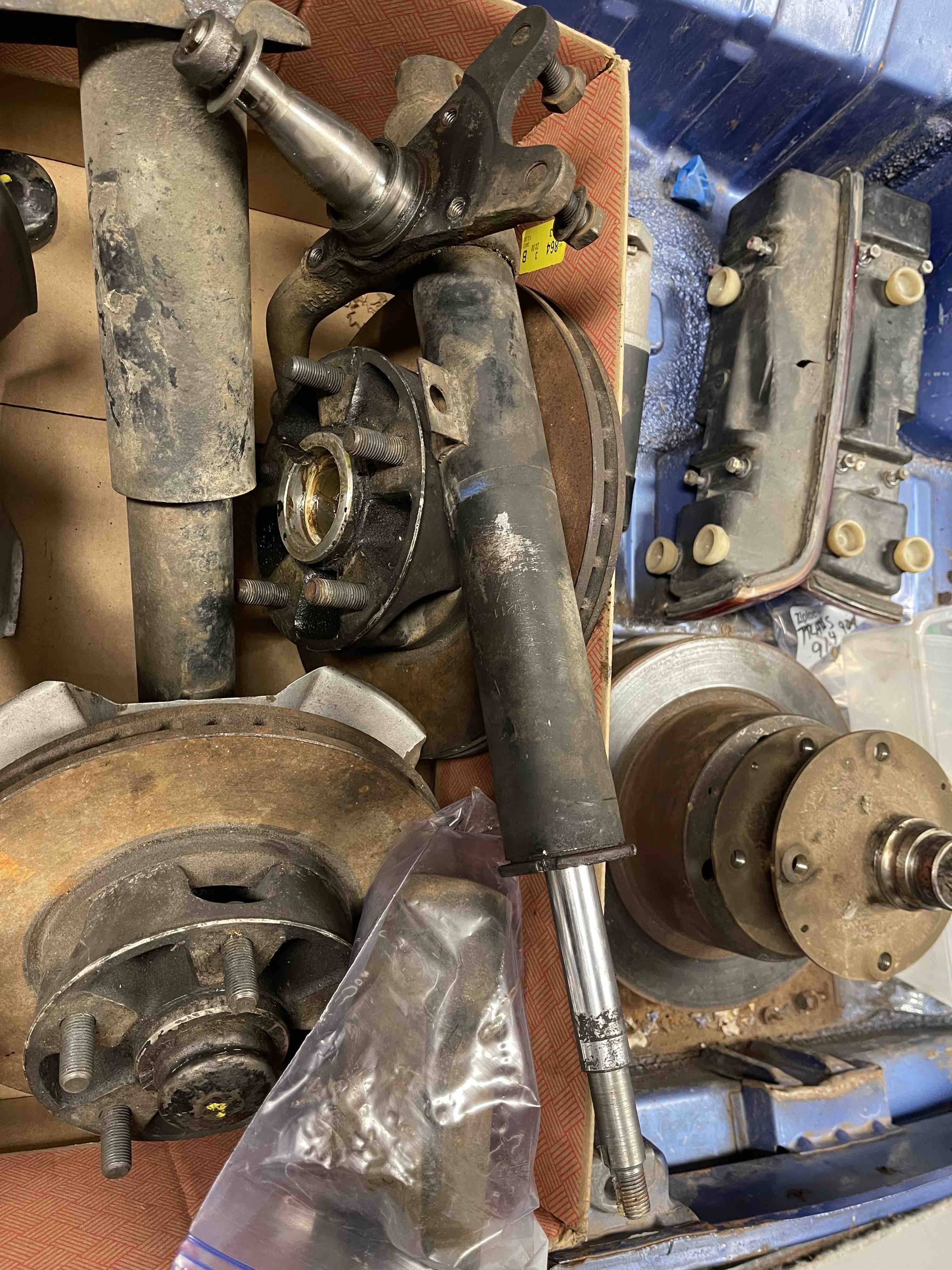

I'm moving over to a 5 lug and converting my '75 front suspension/brakes to use 20mm rotor with a brembo caliper. This is an M- caliper set-up. The easiest path for me was to pick up these early oil filled 911 Boge struts. These are already set-up with a 20mm rotor.

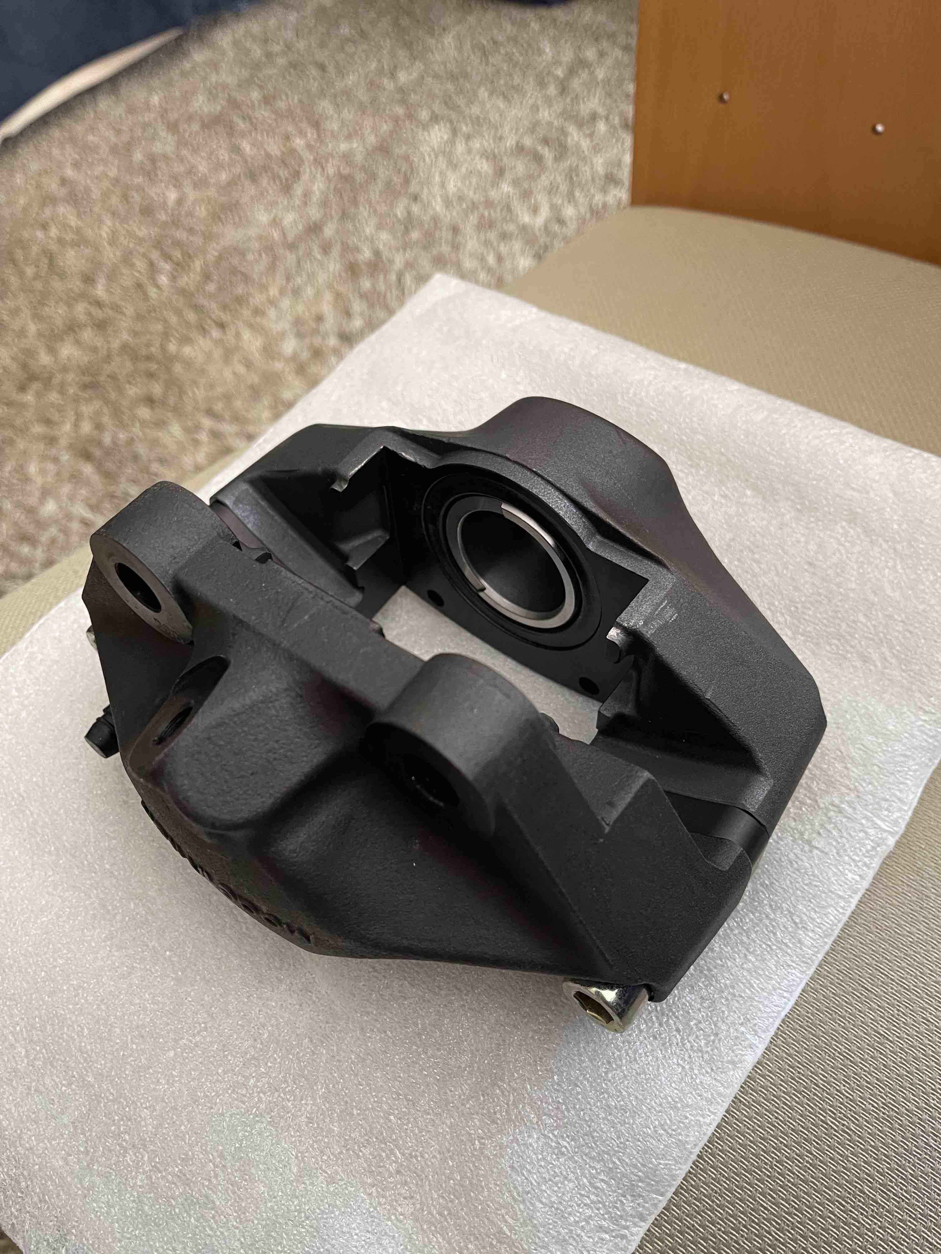

They are from a 1971 911 and have the 3" M Caliper spacing. I did a quick check with the 911 struts in my 914 when I got them and they really are a drop in. I also receive the calipers yesterday and took a quick picture:
The 4lb reduction is a big difference in the caliber weight. These new calipers have a 3" spacing and just bolt on. They use a larger pad from a BMW 320. This is one of the few upgrades that I've done that drops in.
I'm getting the 20mm vented sport rotors from PMB, which are $88 for a pair. That was cheaper them getting the 911 rotors resurfaced and cleaned. I've got the Boge knuckles and hubs over at PMB for restoration. There are Bilstein B6 inserts for the Boge struts that I've got on order to finish up the conversion.
