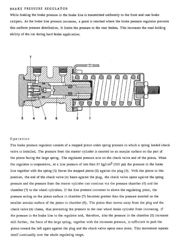

Eric's ad selling the 912 rear calipers started a discussion about the brake pressure regulator. I'd like to continue that discussion. Eric mentions that he wouldn't replace the regulator with a 'T' fitting. What I would like to know is how could you test the regulator off of the car? At $300 - $400 a piece from the dealer I would like to test mine before I purchase a new one.
Also, Eric mentioned that the front calipers shouldn't be used on the rear, even with the regulator. Is there any problem installing a set of rebuilt rears on and not installing the parking brake cables?
Any thoughts and suggestions are welcomed. BTW, I'd like to keep this discussion only for the 4-lug wheels.
Also, what are the thoughts about replacing the master cylinder with the larger one how does that effect the brake biasing?
-- Rob

Eric_Shea   I can't type all that crap again so I'll j...   Mar 5 2010, 07:44 PM
watsonrx13   Thanks Eric for the update. -- Rob   Mar 5 2010, 07:51 PM
Eric_Shea   Also... disconnecting hand brake cables would have...   Mar 5 2010, 07:54 PM
Eric_Shea   Read this...   Mar 5 2010, 07:58 PM
watsonrx13   Thanks Eric, very good description. BTW, is there...   Mar 5 2010, 08:08 PM
Tom_T   Great dissertation from the Guru of Porsche Brakes...   Mar 5 2010, 08:09 PM
