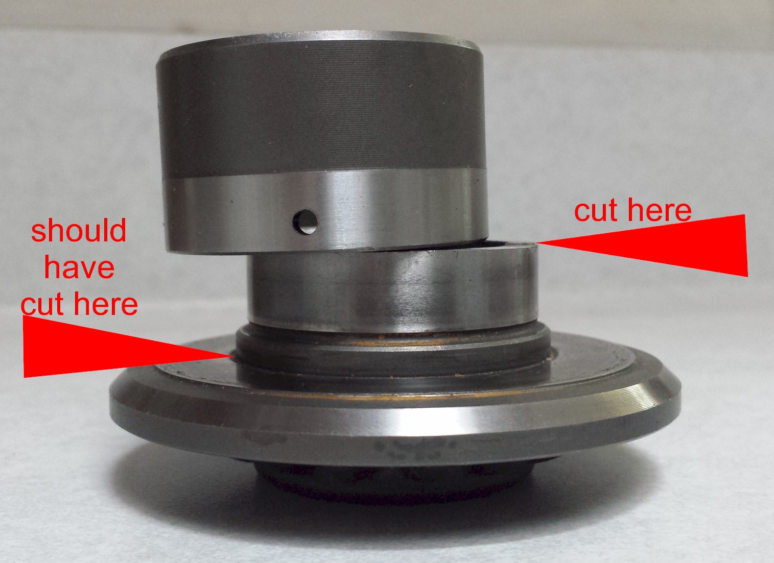

oops. can this be welded (AS IS, short length) and used with some washers?

more pics of the 2 pieces I will have welded after we make a jig to keep them centered to each other and spaced correctly. in pic I have the inner section resting on a tall socket to keep it up high inside the larger outer piece, for the pic, and to should closer to what finished part would look like.
the factory machined end goes deeper in trans and the cut end goes towards the nut. so i am thinking some spacers on the tail end/nut end will suffice?

my coupler. hope it holds together. one weld at top.
