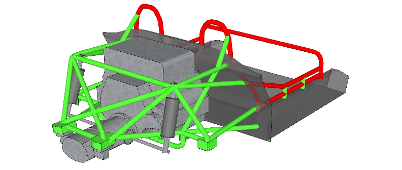

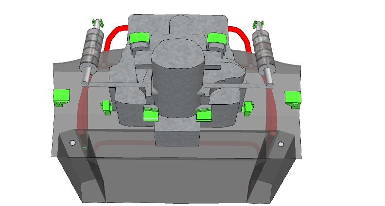

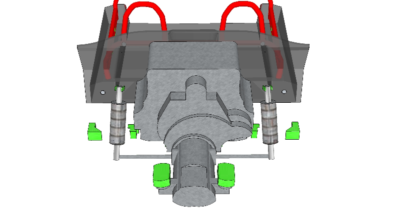

So I have been playing with the idea of adding a couple more tubes to the back of the Anklebiter. If you were to replace the back half of a 914 with tubes where would you put them? Here is a rendering of the original cage (red), drivetrain (Grey), and points that need to be tied in (green).
What would you do?

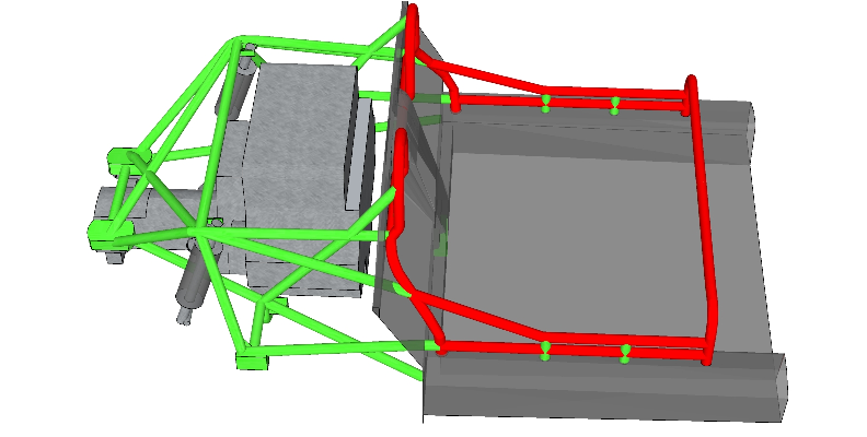

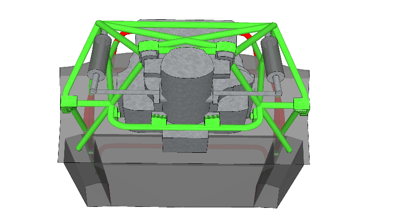

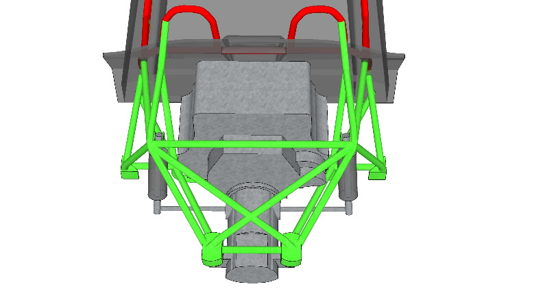

Here is my first draft, any thoughts?

I would like to keep the passenger compartment intact, I know it seems like a contradiction but I would like a nice stockish interior with a pretty stock passenger tub.

QUOTE(plymouth37 @ Mar 8 2010, 05:57 PM) *
any thoughts?
Overkill? (IMG:style_emoticons/default/confused24.gif)

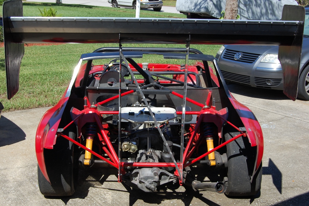

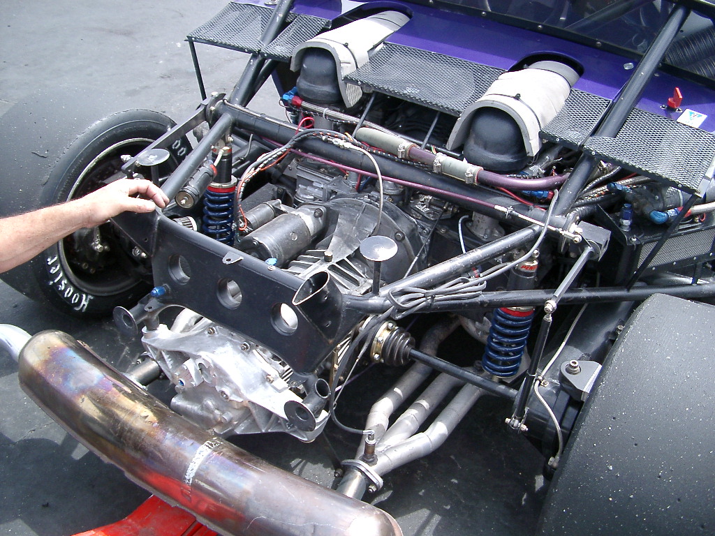

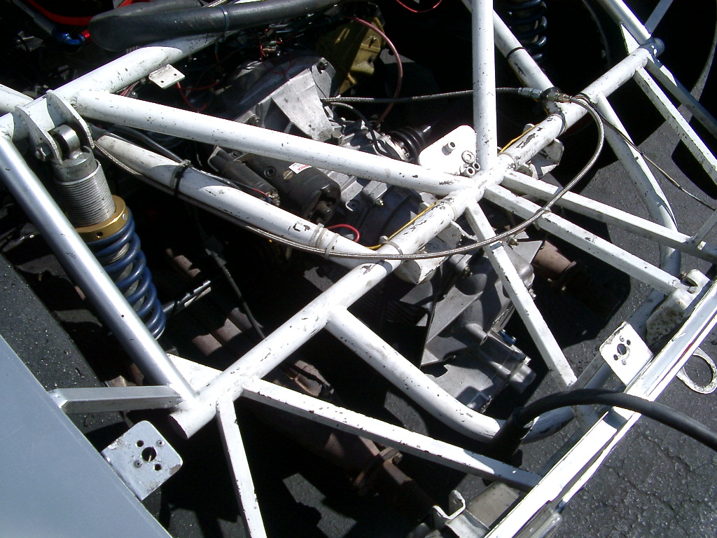

URY914
post Mar 8 2010, 08:28 PM
Posts: 130,443
Joined: 3-February 03
From: Jacksonville, FL
Member No.: 222
URY914
post Mar 8 2010, 08:29 PM
Posts: 130,443
Member No.: 222
post Mar 8 2010, 08:32 PM
Resident German
Posts: 42,396
Joined: 21-January 03
From: Oakland, Kalifornia
Member No.: 179
Ury, that stock starter looks heavy ... (IMG:style_emoticons/default/shades.gif)
Aha, i see you replaced it in the second pic ... (IMG:style_emoticons/default/happy11.gif)

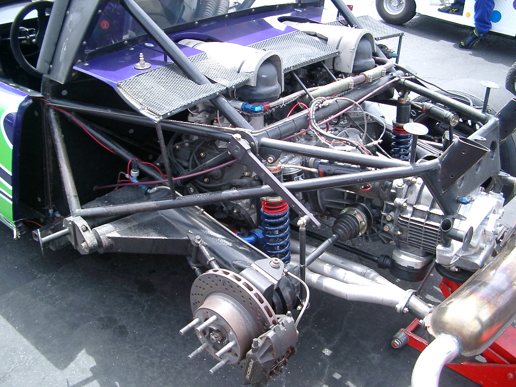

I was thinking of yours when I was working on this Ury, it is amazing how much more complicated things get when you cut off the rear frame rails.

QUOTE(plymouth37 @ Mar 8 2010, 06:27 PM) *
I want it to be able to handle at least 500hp but I don't want to add unnecessary weight by going over board.
For example, i think in the rear going from the top of the shock towers to the transmission mounts, just the X brace should be plenty as long as you still have the stock cross member where the transmission hangs off of.

The plan would be to eliminate all sheet metal behind the firewall but I would replace the stock cross member with a tube between the mounts.

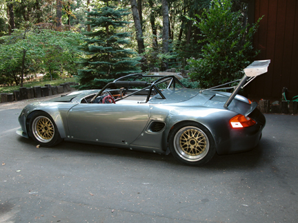

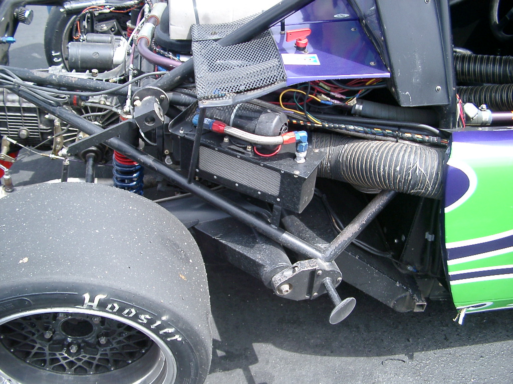

More examples, some better, some not so much (IMHO), just food for thought ...

I like the design you posted. You really do need many of the bars because of the load paths, but IMHO it isn't overkill as long as you use correctly sized bars. With sparing use of .035 and .049 wall tubing you can keep the structure light in incredibly rigid. (IMG:style_emoticons/default/smile.gif)
Crazyhippy
post Mar 8 2010, 08:54 PM
Insert witty comment here...
Posts: 1,659
Joined: 28-July 05
From: Home of the Coyotes, AZ
Member No.: 4,493
The tube from the long too the motor mount wont be doing much the way it is, and would be better served meeting the cage w/ the other tube.
Likewise, the inner vertical from the motor mount up to the hoops will not be as strong as if they go to the "shoulder"
Last (and probably way overkill, but i've been doing Baja Trucks) would be a support from the upper shock mount down to the motor mount.
Could probably lose the bar between the trans mounts, there wont be any stress in that direction back there.

Tube wall thickness is another factor, I like the concept of using more light tubing versus less heavy tubing. No need to worry about racing rule books so any size that is appropriate is fair game. I like Jim's ideas, I was thinking 1.5 dia. what wall thickness would you guys use and where?

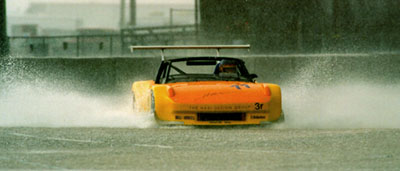

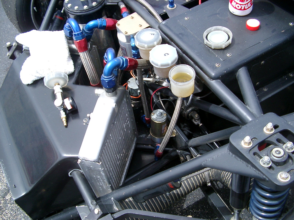

Cost no object I would go the route Hari Matsuda went. Not to shabby for a 72 year old. Actually these pics are a few years old.
Hari ran a few different cars but he did things with a 2.0 186 HP four / 1730 lb car that others running six's COULDNT do. The four cylinder was 100lb lighter than his later 3.4 car. The light weight car just by weight alone was 1-2 seconds per lap faster than the heavier cars. I am a believer in light weight versus BIG Horse Poo. Quicker and faster to a stop.
The orange car in the pics is the 3.4 that weighed in at 2080 lbs. Evil on the track.
When Hari was 69 years old he considered converting this car to street legal.
Jeff Hail

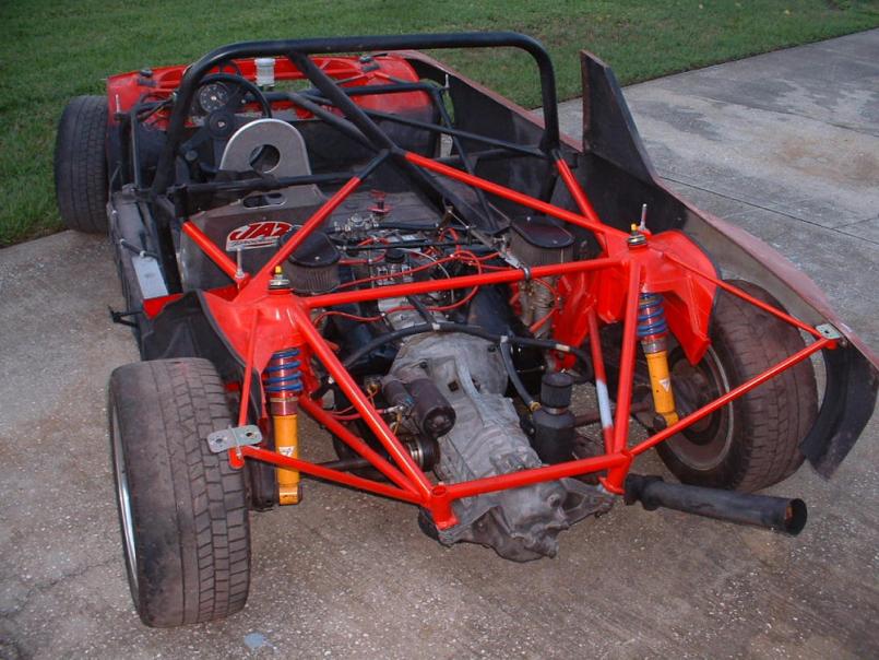

Hari's latest configuration was this.

QUOTE(plymouth37 @ Mar 8 2010, 06:32 PM) *
... complicated??? that photo should simplify things for you based on your drawings... he doesn't have half ( if any) of the triangle bracing you've implemented in your cad drawing. however those sharidon bodied 914 photos Andy put up are when you have a 3.6 track monster and probably need the extra bracing... you don't need to re-engineer the wheel, these cars have been around for some time now. take a tip from the track guys. if you can find some photos of that otto's venice guys' car, he knows his stuff too. did you know he has the fastest time at the streets? last time i stuck my head underneath the rear fender there were a bunch of Ace Hardware washers off-setting he rear 930 calipers to the rotor. its not rocket science mate, lots of these guys are running with early 1900's lotus logic.
