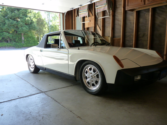

basically a trim matte or satin black with a plasticizer mixed in. Came out better than I had expected. (IMG:style_emoticons/default/biggrin.gif)
Just enough difference in the appearance to distinguish between the bumpers and the gloss black valences and rockers.
Cell phone pics don't do it justice....tomorrow I will take some better pics with the good camera. (IMG:style_emoticons/default/smile.gif)

Nice job on the rear valance mod too! .... looks like it could be a OE option! (IMG:style_emoticons/default/biggrin.gif)

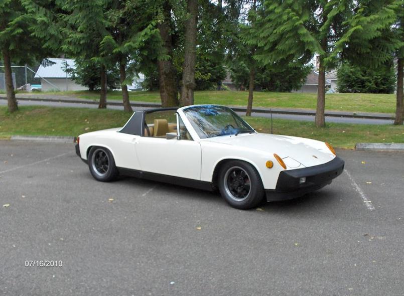

car is now a driver...
did some little things today.
cleaned up dash face and installed new stereo head unit. tomorrow the speakers and all the wiring will be done.
center console, none of the gauges were working so had to do a little wiring today.
Had to run 12V switched, 12V constant, ground and temp sensor wiring from the tunnel to the gauges...
but they all work now with lighting and everything (IMG:style_emoticons/default/biggrin.gif) even the clock is keeping good time (IMG:style_emoticons/default/flag.gif)
Some DPO had all the lighting done, but no power to the gauges... (IMG:style_emoticons/default/confused24.gif) (IMG:style_emoticons/default/confused24.gif)
couple of shots of car cleaned up a bit and in the garage. (IMG:style_emoticons/default/smile.gif)

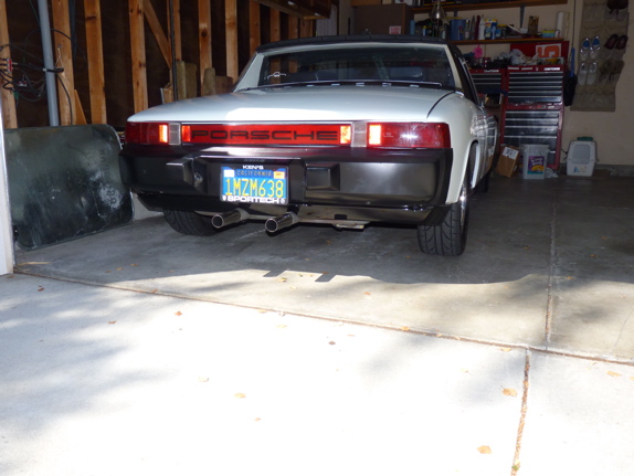

intact front plastic targa top holders in the trunk placed along with the nice repops of the rear rubber holders by Mikey914(Mark) (IMG:style_emoticons/default/biggrin.gif)
Rain tray cleaned and ready to install once I get the proper hardware for it and the down tube funnels.
Got a spare tire washer and hold down and now the spare is solidly in place in the front trunk. (IMG:style_emoticons/default/flag.gif)
Rewired my foglight/headlight switch so the fogs now come on with the parking lights and the headlights, not just the headlights.
Reworked my rear deck lid latch pin so the trunk would not pop open over bumps...needed to square and redefine the little ledge on the pin.... (IMG:style_emoticons/default/sawzall-smiley.gif)
Next up will be the carpets which should be here in the next day or two.... (IMG:style_emoticons/default/idea.gif)
While the seats are out for the carpet install I will do a little work on some of the vinyl. It is loose in a couple of spots so a little adhesive and it should be good until I find some better seats or get these rebuilt/upholstered.
things are starting to be the way I want them overall.... (IMG:style_emoticons/default/biggrin.gif)
