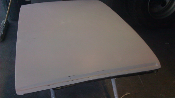

no pics yet, but I should be getting my good top from the body shop on Friday.
The top has been completely smoothed and then painted with matte black paint...should match the overall look of the sail panels....hopefully. Anyway it is a very straight clean top and will also have new seals on the sides and rear from Mikey914.
Anxious to see how it looks.
will post pics of the top as soon as I have it. (IMG:style_emoticons/default/biggrin.gif)
I am also going to make a guage panel from some black ABS sheeting. It will be mounted to the stock console upper bracket. The gauges will mounted horizontally under the edge of the dash instead of vertically like in the console.

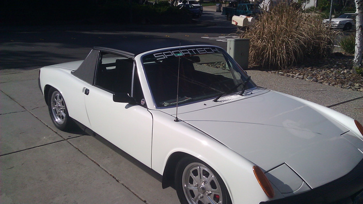

top is now smoothed and primed...underside is already painted (IMG:style_emoticons/default/smile.gif)
will be painted by this afternoon.

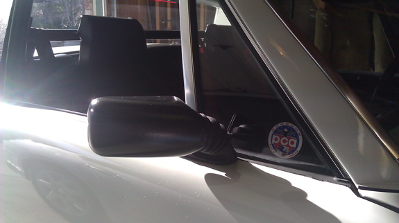

Also decided to try my Vitaloni mirrors for something a bit different.
These are mounted to the factory spots using the factory captured nuts in the doors.
I cut a piece of old bike inner tube for a gasket between the mirror base and the paint on the doors, so they won't leave any marks if I decide to remove them.
If I don't like them then I will go back to the factory mirrors...
they give the car a slightly different look (IMG:style_emoticons/default/biggrin.gif)

You know Dan...I'm liking the baby turbo mirrors. Hmm, wonder if I could pick some up for my 914? (IMG:style_emoticons/default/idea.gif)
DanT
post Jan 21 2011, 06:36 PM
Post #308
Going back to the Dark Side!
Posts: 4,300
Joined: 4-October 04
From: Auburn, CA
Member No.: 2,880
I have had those around for years....took them off of one of my first 914s and replaced them with something else...
Anyway I decided to give them a try....they look pretty good and go with the top and the bumpers...
If I get tired of them I will just go back to the factory mirrors...
Just like to change things up once in a while (IMG:style_emoticons/default/biggrin.gif)
I might mount up my Monza 4 tip exhaust this weekend for a little more retro feel... (IMG:style_emoticons/default/happy11.gif)
Dan, if you get a pair make sure to mount them to the stock holes...just need some longer bolts and a couple of washers to make them work with the factory captured nuts. Easy on and easy off.
I had to modify the base of each mirror a bit so the mirror head would sit level....I have seen a bunch of these over the years with the mirror head sticking up at the end because the base was not modified... (IMG:style_emoticons/default/dry.gif)

Looks good! I modified the base on my baby turbo to fit the curve of the door. My mirror is not in the stock location, but a couple inches down. I taped some sandpaper to my door with the gritty side up and slid the mirror back and forth on the paper till it had the correct curve.

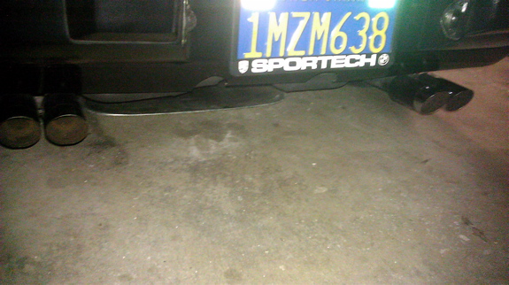

Well, got bored again and decided to put the Monza 4 tip exhaust on.
Definitely sounds different than the stock muffler twin piped...not better or worse, just different (IMG:style_emoticons/default/biggrin.gif)
Next I will be mounting up a Bursch that will have the exhaust pipe modified to clear the valence with no stock opening...
Once I decide which one I want to keep long term I will modify/repair the valence to match. (IMG:style_emoticons/default/smile.gif)

Did some minor work to the twin pipe muffler and repainted it in High Temp paint...
now reinstalled on the car and the Monza resides again on the garage floor (IMG:style_emoticons/default/biggrin.gif)

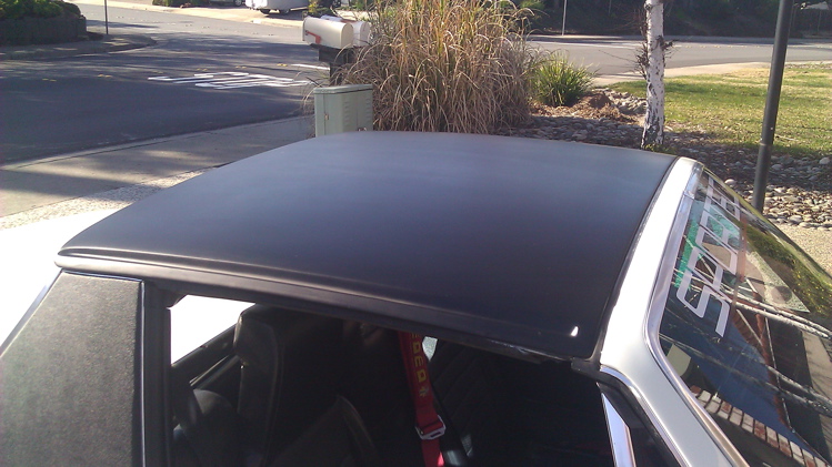

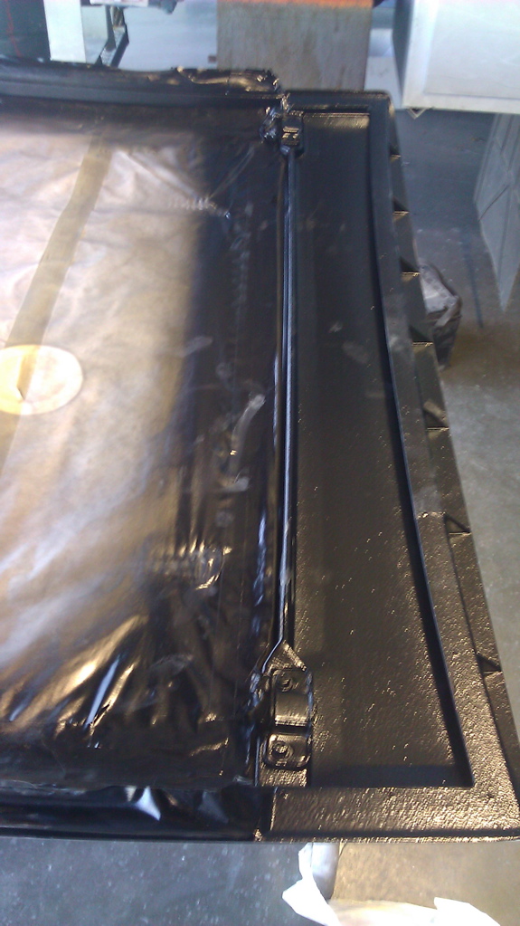

got the good top back from being smoothed and painted.
finish is black with a matte clear coat....
came out just about the way I had envisioned as far as finish color.
I am quite pleased. Now just awaiting my new rear and side targa top seals to finish it off. (IMG:style_emoticons/default/biggrin.gif)
one thing that I did notice, the new top is noticeably lighter in weight than the old top....I guess that pebble finish had some weight to it (IMG:style_emoticons/default/smile.gif)

The top turned out really nice Dan, I like it!
I haven't ever sanded a top smooth before, but had a 914 that someone sanded smooth and painted. I noticed the same thing, it was lighter.

Thanks Dan....I am very pleased with the way the roof turned out...and it is much easier to wipe over to keep clean without the rough surface of the original finish. (IMG:style_emoticons/default/smile.gif)

Got a wider angle shot? I'm liking the matte top, but I'd like to get a real overall impression.
I am truly loving your disregard for 'general knowledge', and trying out all the things that people tell you to throw away. It's always great to have people question the status quo. (IMG:style_emoticons/default/thumb3d.gif)

WOW! - that really looks nice & you really can't tell it's not pebbled from that 6-10' distance! (IMG:style_emoticons/default/drooley.gif)
... and you know that for my personal tastes on my car, I'm an OE-kinda-guy! (IMG:style_emoticons/default/biggrin.gif)
That almost could've been an alternative considered by the factory back in the day for lighter weight, less work/process steps in mfgr., etc. - but still goes well with the rollbar vinyl. .... maybe it was considered back in the day - who knows!? (IMG:style_emoticons/default/confused24.gif)
I know that often aircraft are left unpainted aluminum to save weight, because it adds several 100s to 1000s of lbs., depending on the size of the aircraft. So the lighter weight without the pebble finish layer(s) makes sense.

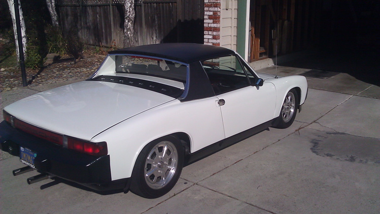

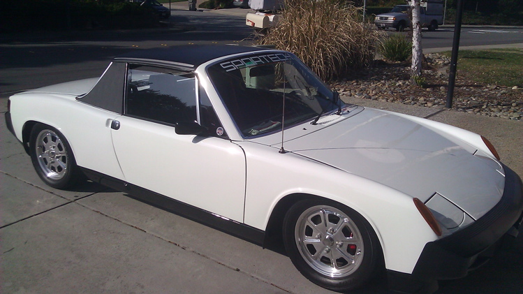

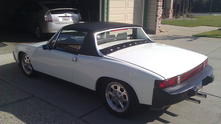

Here are some shots of the new top and also you can see the baby turbo Vitalonis as well. (IMG:style_emoticons/default/smile.gif)
Car is coming together as I had originally envisioned for the most part.
As a side note. I coated the inside of the front turn signal buckets with the aluminum foil tape just as I did with the tail lights. Definite improvement in light emitted. (IMG:style_emoticons/default/biggrin.gif)

and a couple more....sorry (IMG:style_emoticons/default/smile.gif)
