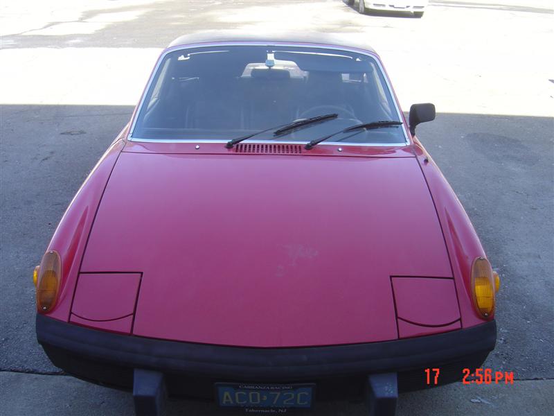

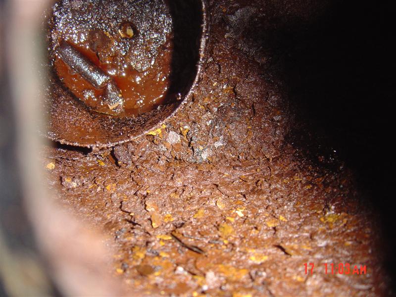

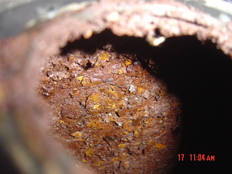

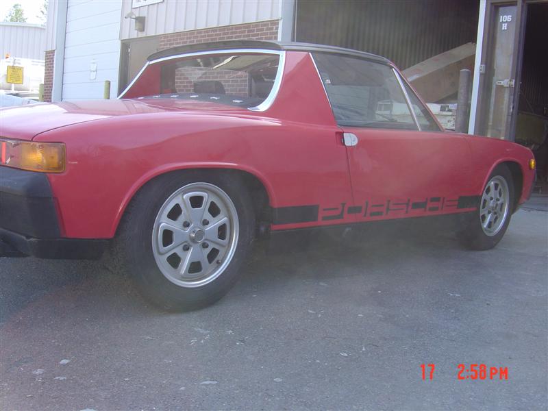

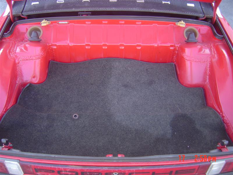

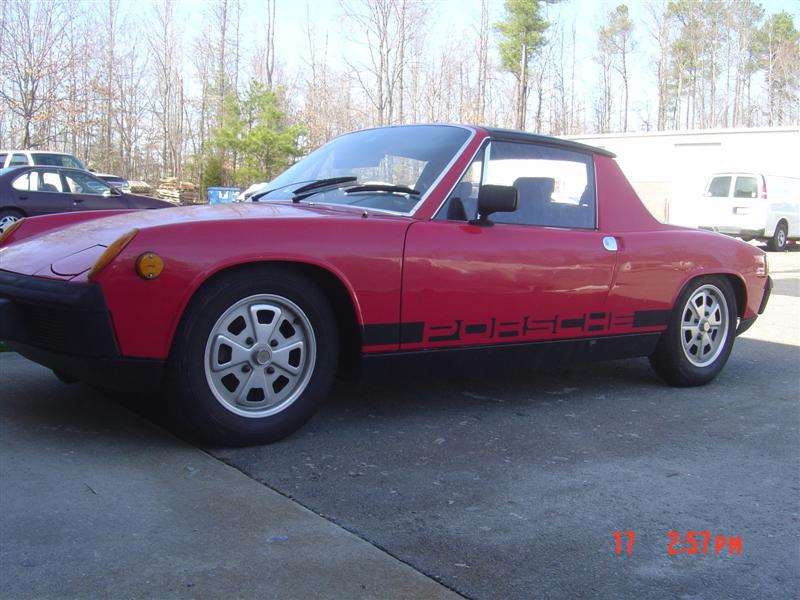

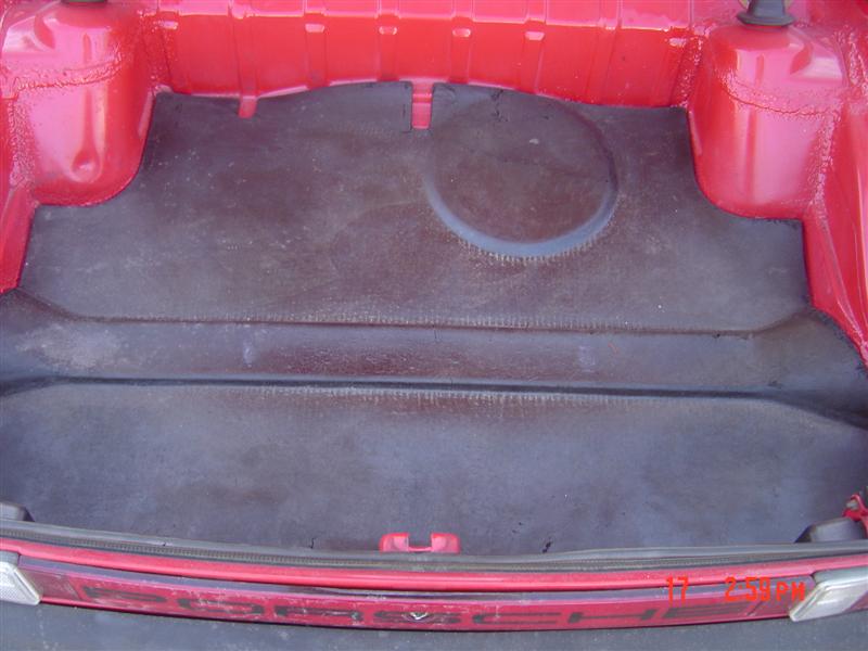

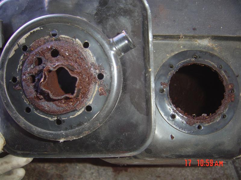

Mark the group buy king, dropped his car off last week. I will get a good run at it next week, but for now I will post the beginning pics. I pulled his tank to take to the refinishers and OHHHH BOY what 20 years does to gas (IMG:style_emoticons/default/barf.gif) More pics to come next week (IMG:style_emoticons/default/shades.gif) Since there seems to be very little rust to deal with it will allow me to spend more time than usual on the body and paint work (IMG:style_emoticons/default/smile.gif)

type47   I've never noticed a vent like that one in the...   Mar 18 2010, 03:05 PM
tat2dphreak   :agree: A/C car?   Mar 18 2010, 03:08 PM
SirAndy   :agree: A/C car? Nope, stock on early /4 cars ....   Mar 18 2010, 03:12 PM
tat2dphreak   DOH! I see now, it doesn't have the side v...   Mar 18 2010, 03:15 PM
Zundfolge   Andy is correct, my '70 has one of those vents...   Mar 18 2010, 03:19 PM
mepstein   Car is a '74 2.0 that was restored in '85 ...   Mar 18 2010, 04:31 PM
SirAndy   Car is a '74 2.0 that was restored in '85...   Mar 18 2010, 04:56 PM

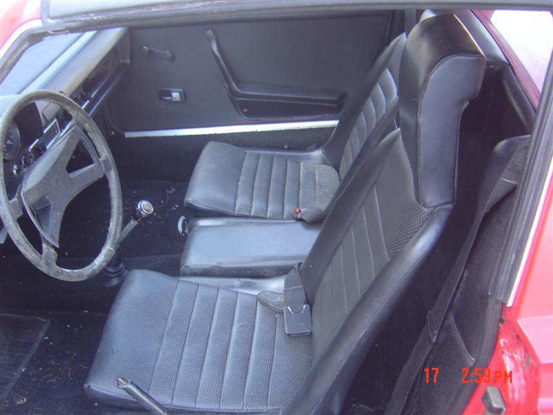

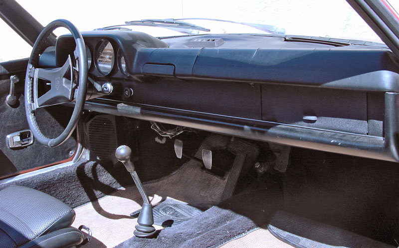

bigkensteele   Mark, your dash is missing its cracks.   Mar 18 2010, 07:18 PM
mepstein   I'm sort of shocked. Title says 1974. It's...   Mar 18 2010, 09:40 PM
kg6dxn   I'm sort of shocked. Title says 1974. It...   Mar 18 2010, 09:48 PM
markb   It looks like early seat belts.....   Mar 18 2010, 10:10 PM
bigkensteele   Not sure when they switched to the late dash with ...   Mar 18 2010, 10:28 PM
mepstein   It doesn't have retractable belts. Question is...   Mar 18 2010, 10:39 PM
bigkensteele   Car was restored at Carranza racing in NJ. This...   Mar 18 2010, 10:48 PM

JmuRiz   Makes me scared to think of what's in my gas t...   Mar 19 2010, 08:29 AM
Jake Raby   I require fuel tanks to be professionally restored...   Mar 19 2010, 09:38 AM

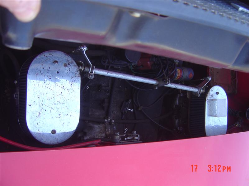

scotty b   Nope, engine is a 1.8 block with 40 IDAs on it. :...   Mar 19 2010, 08:32 PM

Steve   A 1.8 is just bigger pistons and cylinders on a 1....   Mar 20 2010, 09:23 AM
mepstein   Just got off the phone with Scott. He said it had ...   Mar 20 2010, 11:13 AM
ghuff   Just got off the phone with Scott. He said it had...   Mar 20 2010, 11:53 AM
type47   ... at least it is clean :) Well, except for the...   Mar 20 2010, 12:31 PM
hot_shoe914   Just got off the phone with Scott. He said it had...   Mar 22 2010, 08:12 PM
mepstein   Just got off the phone with Scott. He said it ha...   Mar 23 2010, 08:12 AM
mepstein   I knew the tank would be bad. 20 years of sitting ...   Mar 20 2010, 12:46 PM
ghuff   I knew the tank would be bad. 20 years of sitting...   Mar 20 2010, 01:02 PM
dr914@autoatlanta.com   I knew the tank would be bad. 20 years of sitting...   Mar 20 2010, 01:11 PM
mepstein   Thanks for looking it over with a trained eye. I k...   Mar 20 2010, 02:06 PM
type47   Fix the tank and you'll be back on the road in...   Mar 20 2010, 03:31 PM
mepstein   If I can convert 40's to 44's then I will ...   Mar 20 2010, 03:38 PM
type47   ... Raby build ...Webers are good to have. ...go...   Mar 20 2010, 03:40 PM
mepstein   ... Raby build ...Webers are good to have. ...g...   Mar 20 2010, 04:15 PM
type47   No. Just for fun. :) stock FI is fun... (cheape...   Mar 21 2010, 07:50 AM
