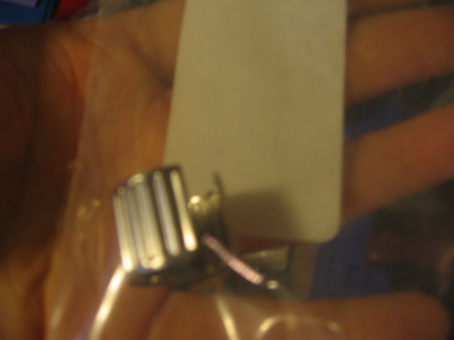

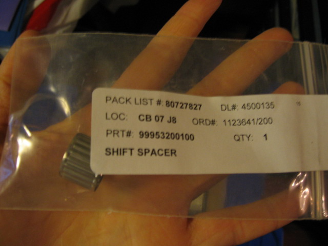

PET 701-00 #13 Qty. 1 (914-6/4)
Holds the stock shift knob to shifter. I think you have to replace it every time you remove the stock shift knob.
note: PET says "spacer", parts label says "shift spacer".

Note that 911 shift knob utilizes a simular one it's slightly larger, but works.

999.532.001.00 spacer
PET 701-05 #19
NLA at Pelican Parts 9/2010
