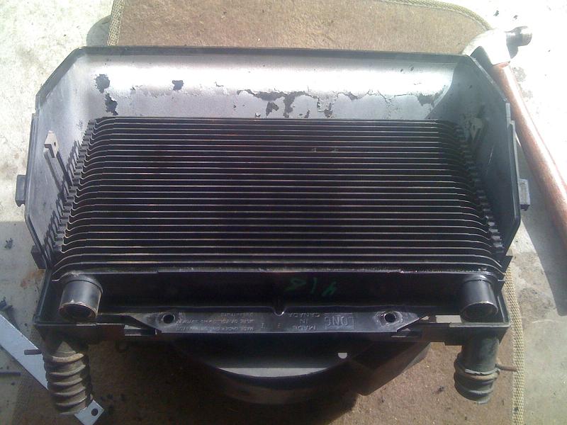

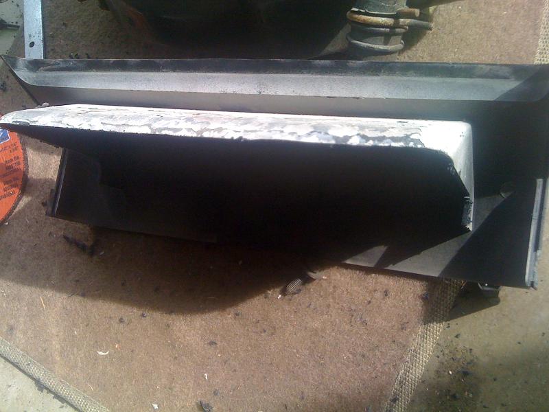

It gets cold here in Northern California often in the moorning. So I decided to build a liquid heater. First, I spent some time measuring the inside of the fresh air box. I figured I could fit a core 11x6 maximum. my son and I spent several hours at the local Pick and Pull junk yard. I settled on a Transmission cooler from a late model Ford Truck. Cooler measures 10x6.

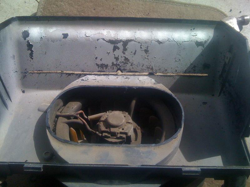

I quick placement and I realize I need to cut! The water dam for the fan must be cut down. Make sure not to cut all of it so that it will still keep some water off the motor.
The finish cut to the dam. Ready for the lid? Not yet.

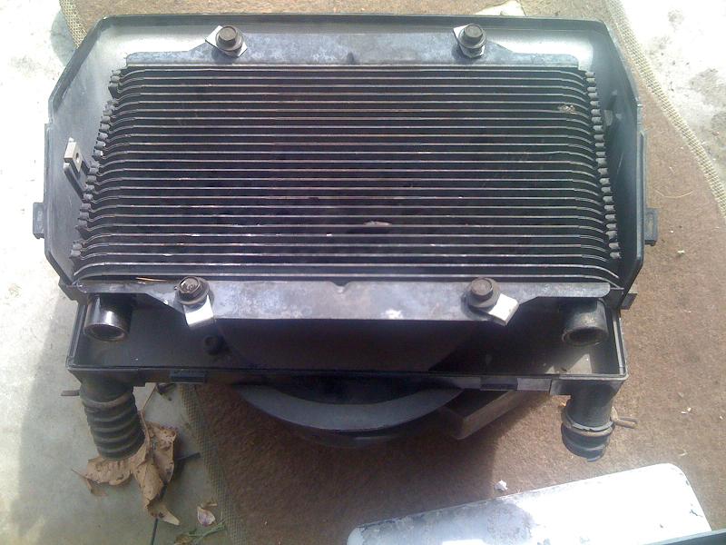

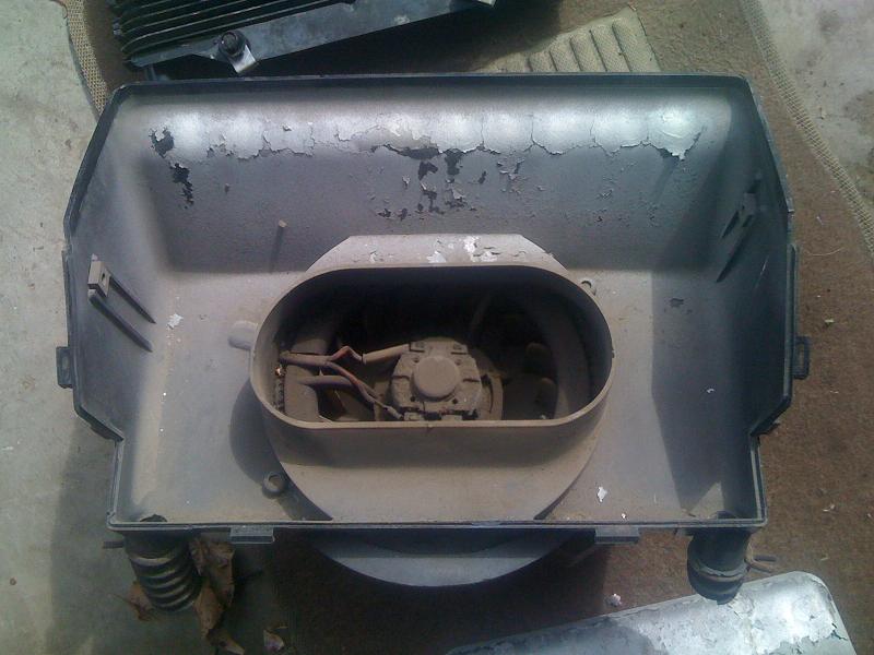

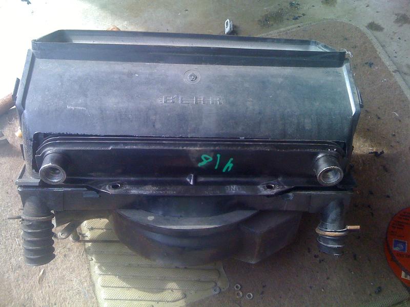

So now the core fits on the fan base.
The top must be shaved down too. Leave as much as possible for the rain cover. I don't park or drive in the rain but weather happens.
Now the core fits into the air box. Need to test fit in the car and seal the box.

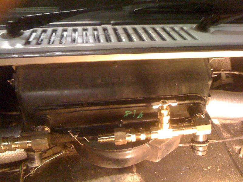

In the car! Just need to plumb hoses to the rear. I picked up a Volkswagen rabbt heater valve to control the water. I will use the red handle to open it. The diverter valve will not be needed fo the stock heater, so I will juggle the heater cables around to suit.
I added a petcock to vent out air.

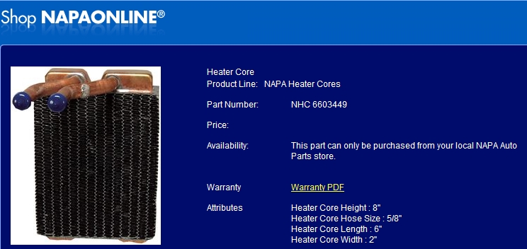

Here is a link at NAPA:
http://www.napaonline.com/Search/Detail.as...6+50028+2028008
Dimensions:
Heater Core Height : 8"
Heater Core Hose Size : 5/8"
Heater Core Length : 6"
Heater Core Width : 2"
They are pretty cheap (IMG:style_emoticons/default/smile.gif)
