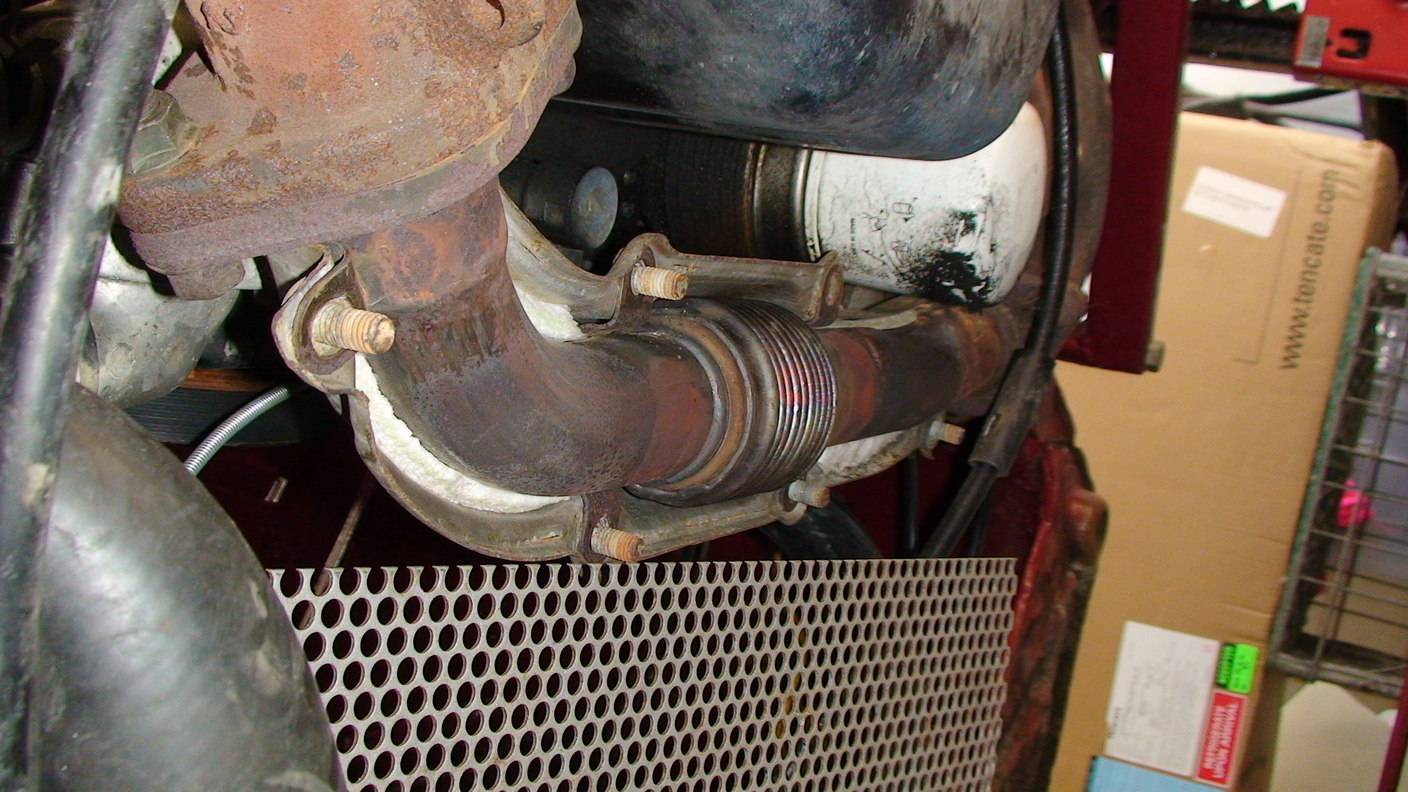

In order to get fast heat, I keep going back to the exhaust heat exchanger.
I picked up some perf sheet thinking I could attach it to the header x-tube and make a shroud for air to pass through.
Not sure where I am going with this yet???

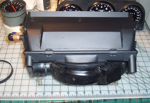

(IMG:http://www.914world.com/bbs2/uploads_offsite/inlinethumb08.webshots.com-2912-1269693793.1.jpg)
(IMG:http://www.914world.com/bbs2/uploads_offsite/inlinethumb29.webshots.com-2912-1269693794.2.jpg)
Do these work good, for anyone that has used them?

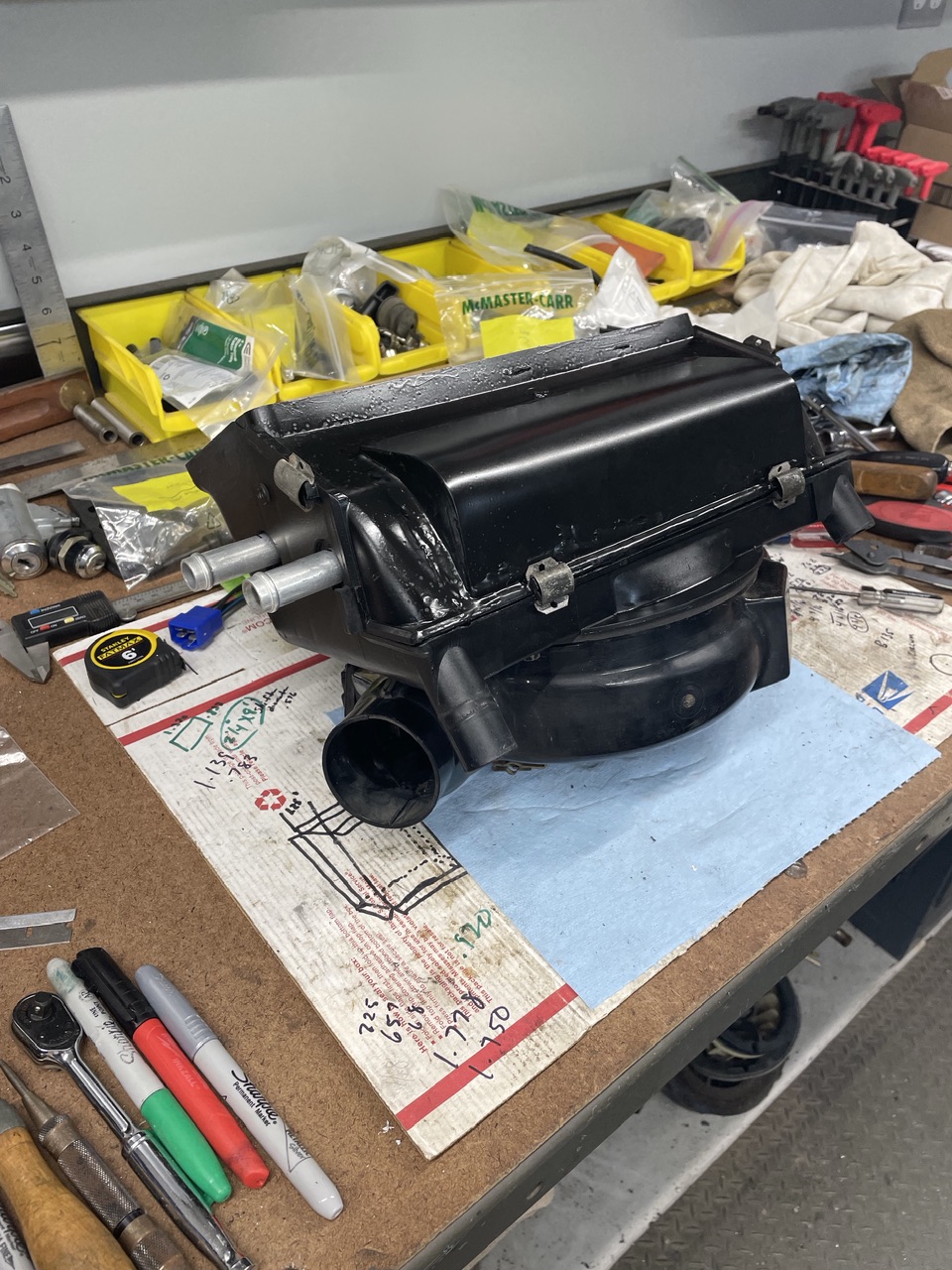

For my project, I bought an inexpensive "hot rod heater". I smoooshed it into the engine bay and will route the hot air via the existing heater tubes..... We'll see if it works (IMG:style_emoticons/default/biggrin.gif)

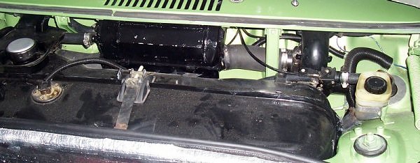

More of the same for my Subaru conversion, but with a Mazda 626 heater core.
