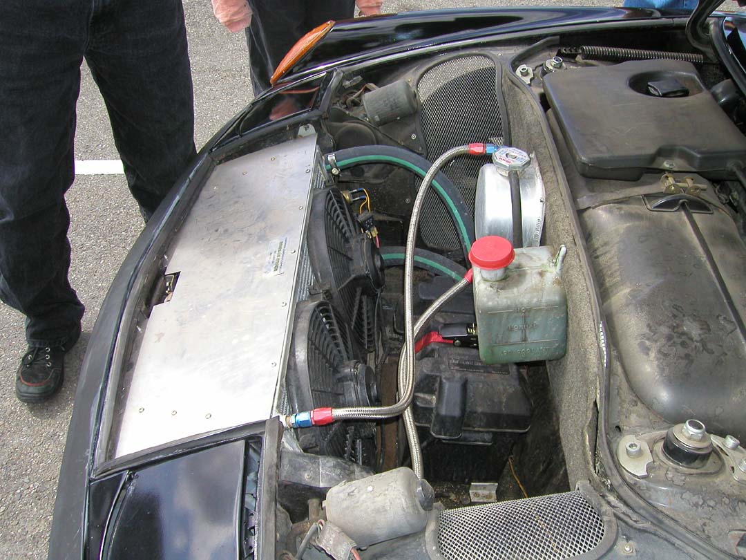

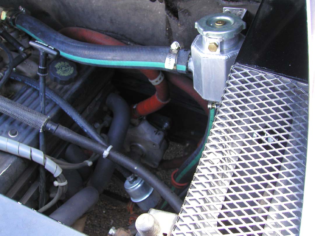

neo914-6   Howard, Brad and Chung installed the RH rad in my ...   Mar 30 2004, 12:23 AM
neo914-6   Someone's front mounted expansion (RH also)...   Mar 30 2004, 12:24 AM
