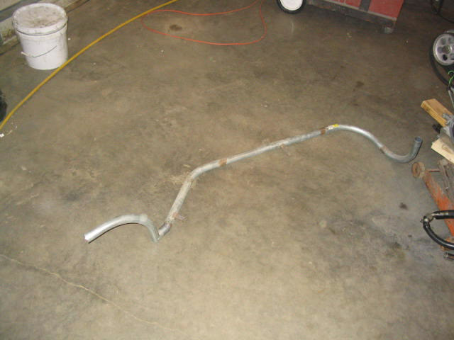

I like the rubber. It bounces back when you hit it with something instead of "crimping" the line and frying your engine before you figure out what the problem is.
Rubber lines: 100$ and 1 hour install.
How long does it take to install hard lines ??
B
The galvanized tube sits nicely in the recess inboard of the pinch weld. I spend about 6 hours fabing a nicely curved tube. It runs inside the boxed rail under the gas tank. The second one will take about an hour. No one is paying me to build may car so My labor is free. I highly dought you could ever hit a tube hard enough to crush it It far more ridgid than the chassis. You'd have some serious suspension damage first. Just an option for the thrifty.

QUOTE(Brad Roberts @ Mar 30 2004, 09:46 PM)
I'm not a huge fan of the rubber... but it is easy on the time during install.
Why not run copper ??
B
If you bottom copper you may rip it. It's much softer, less rigid. Also hard to get long sweeping curved pieces without crushing the tube. If you bottom steel you may ding it but you'll probably drive away. Here' the right side for my car in the rough.

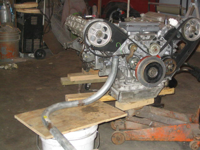

rick 918-S
post Mar 31 2004, 12:18 AM
Post #25
Hey nice rack! -Celette
Posts: 21,022
From: Now in Superior WI
Member No.: 43
end next to motor...
