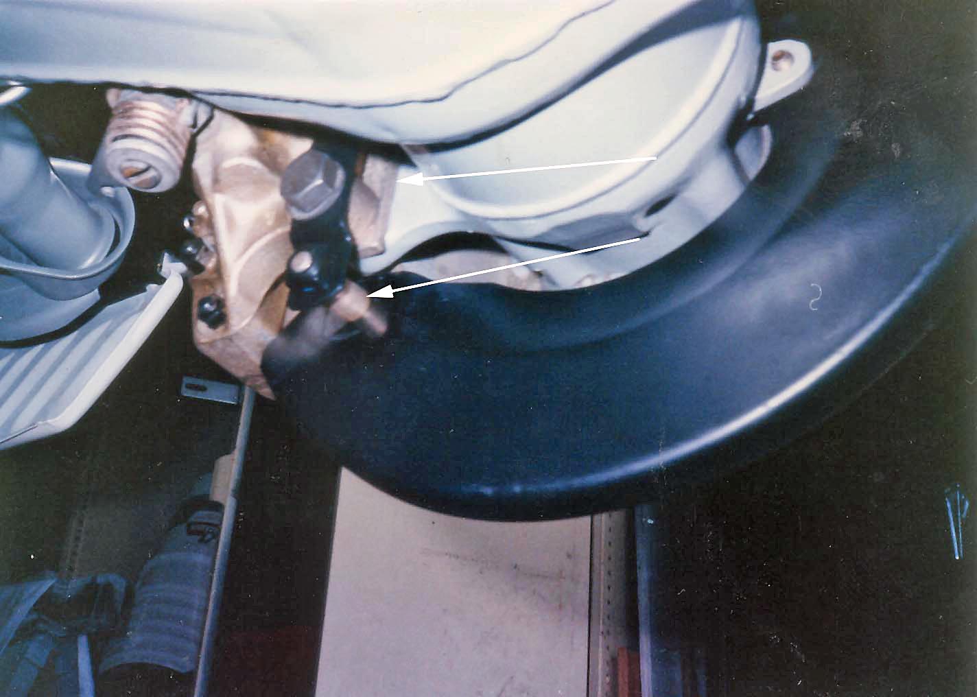

I did this many moons ago ago..911 rear rotors, 911 rear M calipers split with spacers and the 5mm spacer between the caliper mounting pad- no grinding needed- I guess I was lucky. See how I used the stock dust shields.
