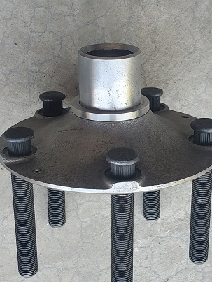

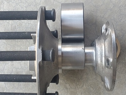

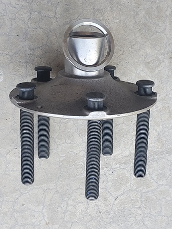

The hubcentric hubs have a raised area on the hub face that fits inside the wheel itself, virtually locking the wheel to the hub rather than relying on the wheel studs to keep the wheel centered. They're wider where the bearing sits so it needs a 5mm spacer to keep the bearing within the correct placement in the trailing arm. I'm in the middle of this operation now so i snapped some pics for you.Attached Image Attached ImageAttached Image

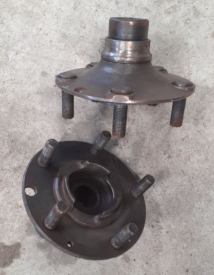

Thanks, that's much clearer now.
That's the wheel hubs I'm about to purchase, from a 69-73 car I believe.
I guess they'll not need the spacer (the raised part on axle side looks higher than yours).
(IMG:http://www.914world.com/bbs2/uploads_offsite/i.ibb.co-21433-1596572758.1.jpg)
The SC parts I might use are the 100mm stub-axles.

These are the remainings of the old bearing, you have to remove anyway before you can install the hubs.

Of course, but I was referring to the raised part underneath the inner bearing part.
