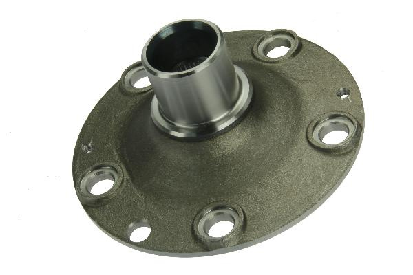

What if you could get a 5-lug rear hub that's a direct bolt-on, and uses 914-4 stock axles?
Announcement for part number 914 331 605 5 LUG coming soon!
4 months later counts as "soon", right?
Any ETA/price on these?

QUOTE(Piledriver @ Mar 1 2021, 01:05 AM) *
QUOTE(UROpartsman @ Nov 4 2020, 08:52 AM) *
These are up on the PMB website from $80 up.
PMB announced it on FB last week.

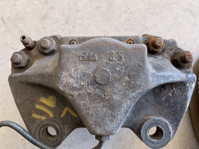

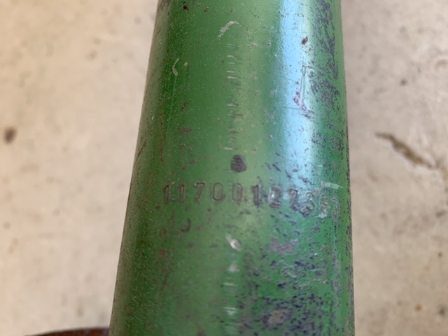

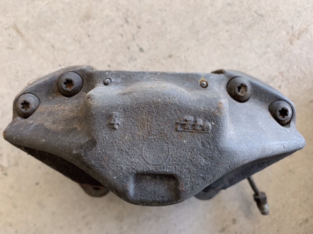

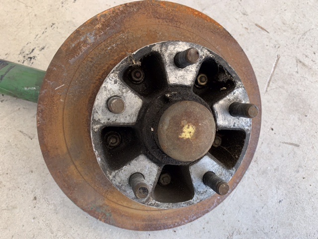

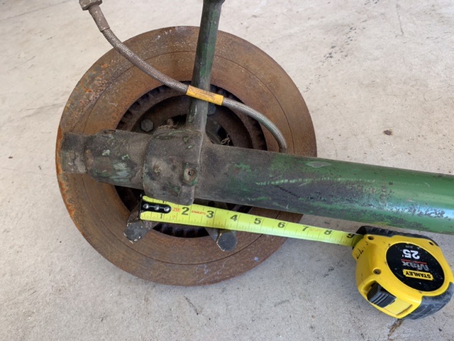

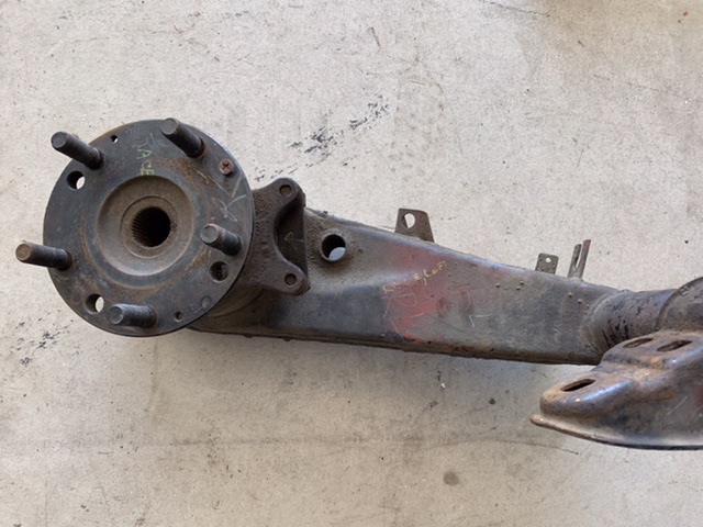

Can someone please help identify what caliper this is, and also if anyone would know the year of this stunt assembly?
All I know it is a 3.5 bolt pattern bilstein. (IMG:style_emoticons/default/confused24.gif)
Would like to use this set up for a 5 lug conversion on my 74. I am planning to buy new rotor, bearings etc..
Thank you.
Attached Image Attached Image Attached Image Attached Image Attached Image Attached Image
914Sixer
post May 31 2021, 06:48 AM
Post #140
Posts: 9,600
Joined: 17-January 05
From: San Angelo Texas
Member No.: 3,457
Those are 74- Bilsten with 3 1/2" A calipers.
