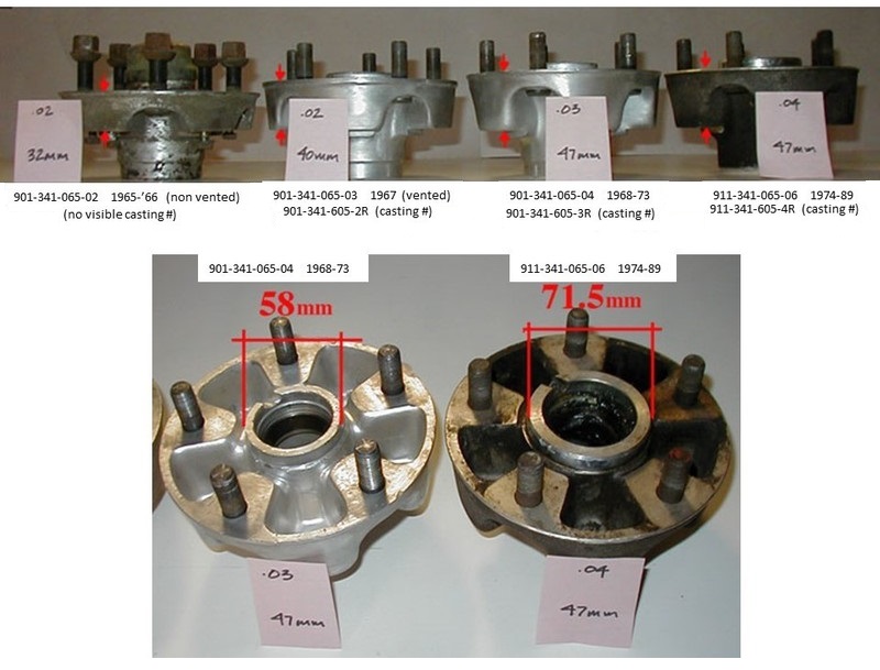

Ok so here is my semi-annual bump & addition to this classic thread.
The interest in converting to, or using 911 rolling gear on the 914 never wanes.
After re-reading this thread (& having a chuckle) it seems the one area that @Eric Shea you left out was the variety of front hubs of different dimension that are available.
In many cases when folks choose this path they are also adding flares so there may be less need to scrutinize wheel to fender fitment, but what about when keeping an narrow body car?
Is there a matrix when using OE Porsche Fuchs, ATS ect. wheels in combination with the proper size hubs to allow the optimal tire to fender clearance? (IMG:style_emoticons/default/idea.gif)

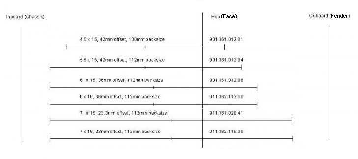

I just posted this in another thread, but might be good to have it here with your hub info!
NARP74

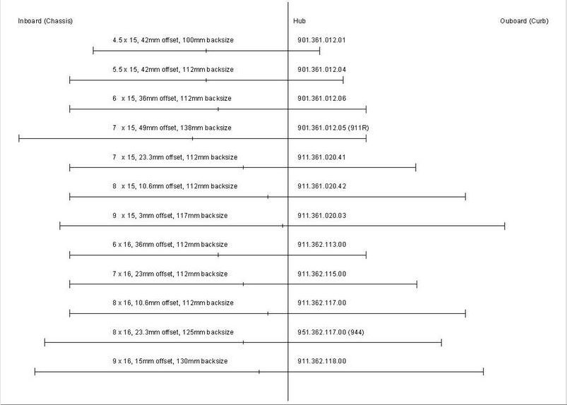

Nice info @914werke , my conversion was done when I bought the car, but I never knew what parts were used. Maybe I can figure that out now.
@mgarrison , I have seen that chart before. I have wondered if the 951 and 911 7 inch wheels have the same dims since they are not on the chart.

QUOTE(NARP74 @ Feb 16 2023, 11:15 AM) *
The 951 wheels have a different back spacing from the 911 wheels. The 951 wheels fit on a 914 better than the 911 wheels because of the backspacing.
914werke
post Feb 16 2023, 11:40 AM
Post #145
Posts: 11,772
Joined: 22-March 03
From: USofA
Member No.: 453
here is a updated chart for narrow body fitment options

QUOTE(ClayPerrine @ Feb 16 2023, 09:25 AM) *
To make it more confusing there are early & late versions:
so 951. from the 944
Early ->1986 had an offset of 23.3 mm
Late 87-> had an 52.3 mm offset (for ABS )
