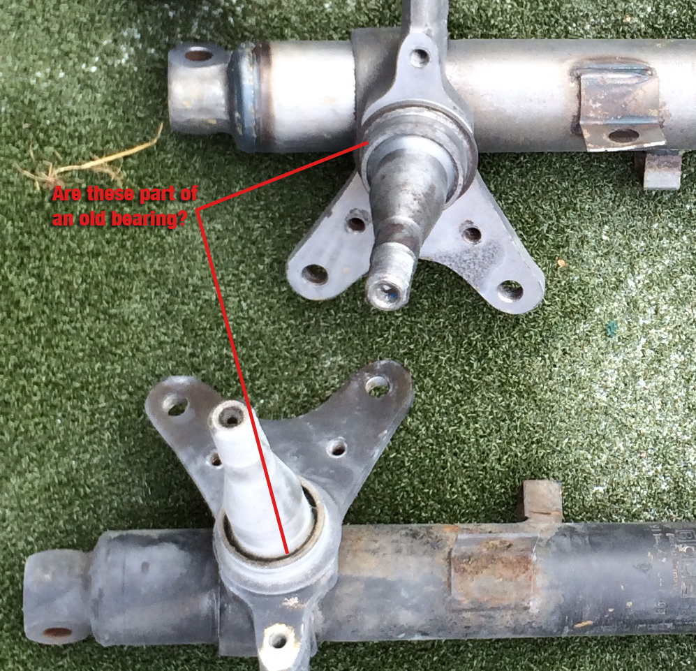

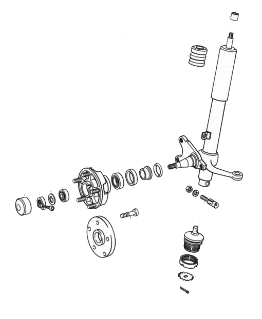

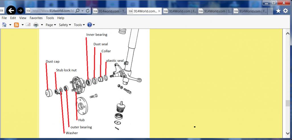

What bearings are needed for 3.5" front struts? I know there's a front and back, but what about the washers and gaskets?
I have a set of Boge struts and it looks like there's a bearing chase stuck on there, but I can't be sure. I want to replace all the bearings, but also want to make sure I buy the right ones. When I look at the parts diagram, there seem to be a number of different pieces needed.

On a 911 the ring needs to stay, the dust seal goes inside the hub and seals up to the ring. The inner wheel bearing sits inside the hub and slides on to the stub axle.
There is a very thin plastic washer under the collar as well that confuses people when looking at the diagram.

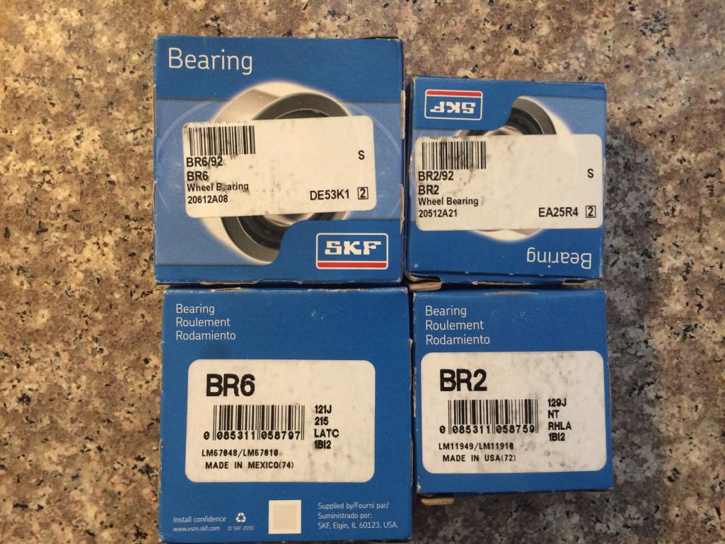

On the subject of front wheel bearings, can someone confirm that these are the WRONG bearings for 911SC struts? The came with the car. I have no clue what they go to.

3.5" struts 3" calipers.
I was able to get "The Google" working on my computer. Those are the correct inner (larger) and outer (smaller) bearings.
