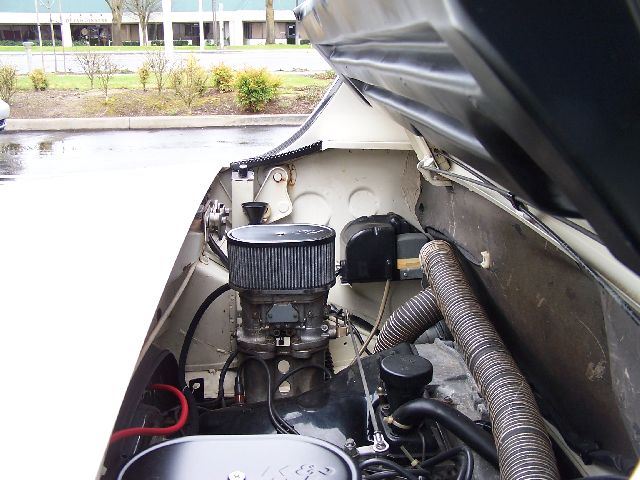

Here's my solution.
(IMG:http://www.914world.com/bbs2/uploads_offsite/lh3.ggpht.com-10752-1271179155.1.JPG)
(IMG:style_emoticons/default/stirthepot.gif)
