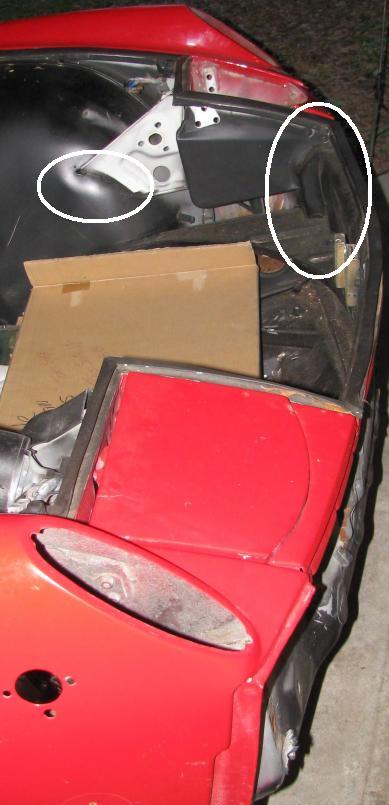

I'm not seeing a kink in this LF Headlight bucket that Rick mentioned - it looks to be a new bucket welded in - compared to the R side one? (IMG:style_emoticons/default/idea.gif) Anyone see what he's talking about? (IMG:style_emoticons/default/confused24.gif)

I do see a kink on the front panel of it in this one - next to the RF Headlight Bucket, but I was hoping to only need the LF bucket & wheel well on the right side of this pic, but then I'm not an expert & was only going by what the 1985 body/paint guy & his qoute from the accident said.
Is that what Rick's talking about, since he's recommending a bucket to bucket splice-in?? (IMG:style_emoticons/default/confused24.gif)

I'm no expert but I don't see anything wrong with the front bucket in the picture and panel. I read where it will probably cost at least 500.00 to set it up on a bench. Thats not getting it pulled out. I would strip all the paint off to make absolutely sure you don't puul it uot a give up on it. My neighbor has a frame straightening fixture in his collision shop. He looked at a 92 extended cab toyota truck I had with a pretty bad kink by the front steering gearbox. He is a friend and said it would cost me 500 to get it pulled by him. I bought another frame for 500 and just moved everything over. That was in 94. Pulling unibodies and frames is very expensive.

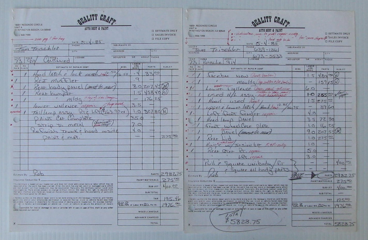

Just for Giggles, here's one of the old 1985 estimates for the F&R accident repair only (back then the party-at-fault's insurance company required 3 estimates) - see below. (IMG:style_emoticons/default/blink.gif)
At that point I'd just recently had the existing rust back then repaired & the current color repaint in Aug. 80
- everything you see rust-wise in this post has festered while sitting in my dry SoCal garage since 1985!!!! (IMG:style_emoticons/default/dry.gif)
Charlie - note that the bench & pull was $400 in `85 - no idea today what they run `round these parts? I need a buddy here, like your neighbor there! (IMG:style_emoticons/default/biggrin.gif)
... Those costs look pretty good today! (IMG:style_emoticons/default/biggrin.gif) Anyone have a time machine?? (IMG:style_emoticons/default/confused24.gif)
I've been using this & the others - as well as my own eyes - in collecting the parts & donor shell so far, since most of the parts on the above quote were new, but are mostly NLA now.
RobW - you may have the right idea on this one! I do know how to do the old school leading techniques from helping my Uncle on his Model A Hot Rod back in the 60's, but nobody here thought that was a good way to fix the smaller rust stuff on it, when I posted that question here in the Garage a while back. However, I've never tried the sawzall & welding patch panels in method, which is why I'd been thinking I need a shop/pro for that!

This is what I spotted as I scrolled through the photos at light speed. Just kinda jumped out at me.
About used parts. Some stuff makes sense like the large section I was able to do with Sandy's car. Front panels are and headlight buckets are NLA making this "worth the investment in time = dollars" to harvest used parts. But things engine shelves, battery trays and stands and the like that you can purchase are worth the labor to harvest the used parts. It takes hours to peel spot welds and clean, grind and prep a used part to make it possible to install.
My money comment was inclusive of stripping the car of parts, repairing the chassis, welding in metal, completing body work and getting the shell in paint. Add to reassemble and any parts that were taken off the car that will now not be nice enough to reinstall.
