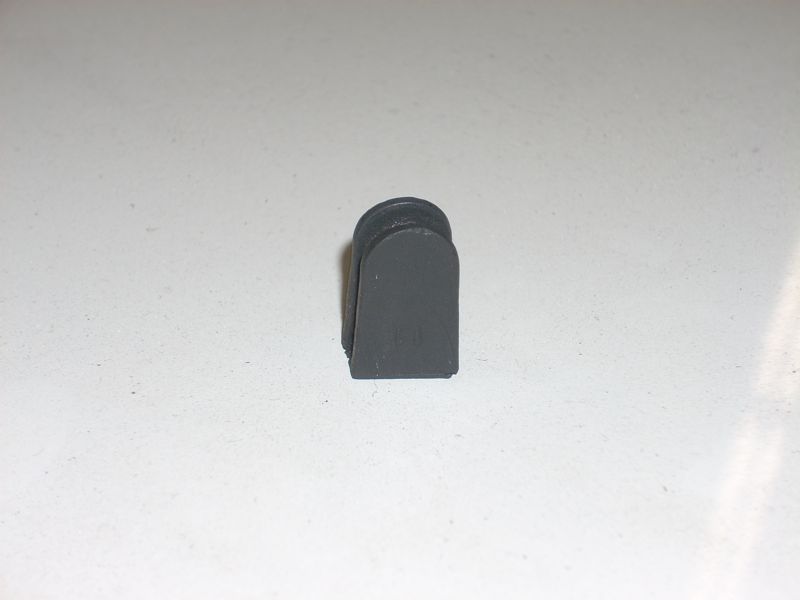

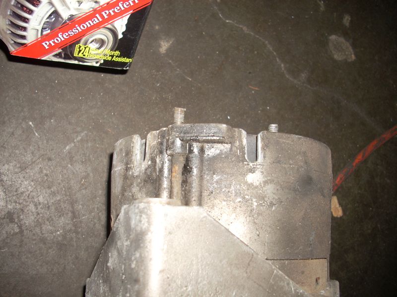

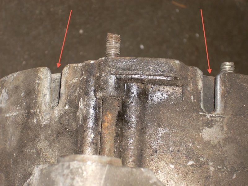

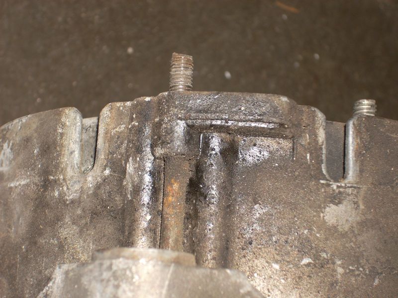

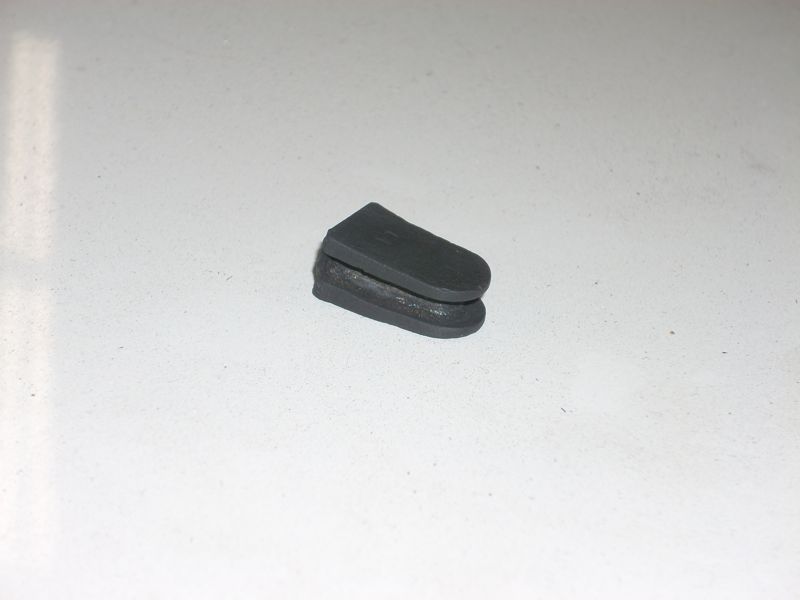

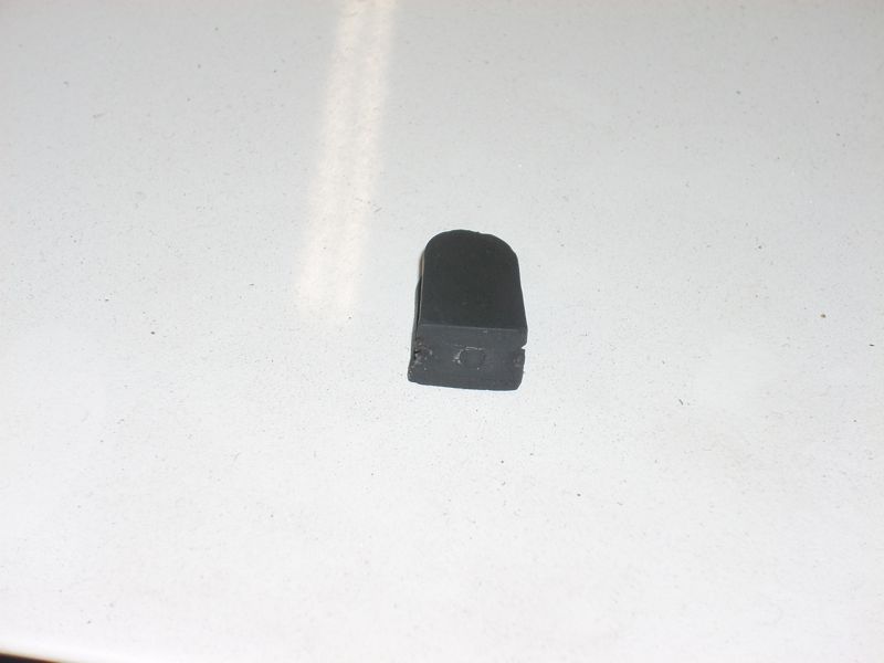

PET Illustration 902-05 Position 8
PET Description: "gasket"
Qty Per Car: 2
This rubber plug fill a void in the alternator body to keep cooling air from leaking out. Leaving this part out could result in increased alternator failure due to heat damage.
