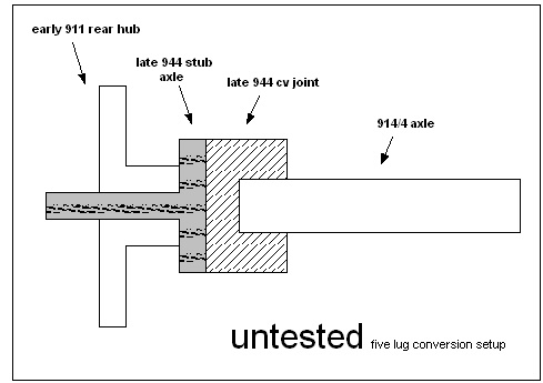

I heard rumors, that you can use stub axles from a later modell 944 (944 s2 or 944 turbo) in combination with early 911 rear hubs.
The trick is , that the splines of the 944 stub axle fits into the early 911 hubs. On the other side it should be possible
to use the outer cv-joints of the same 944 modell which provides splines for the 914/4 axles.
That would be a very cheap alternative to the expensive 914/6 stub axles ...
does anyone is using this combination ?
here's a small sketch of the proposed setup :
greetings ...
Benno
