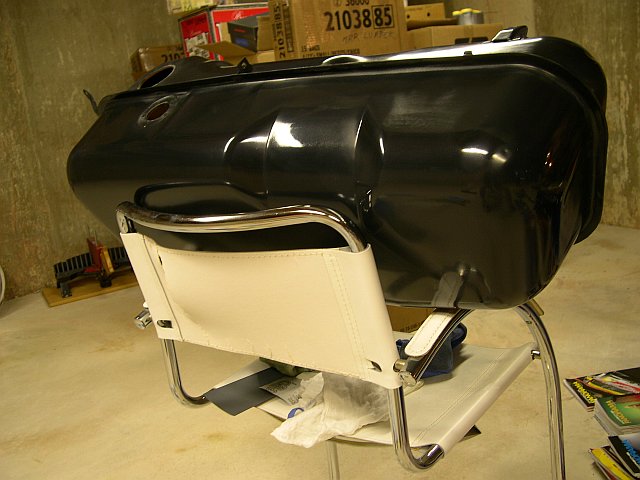

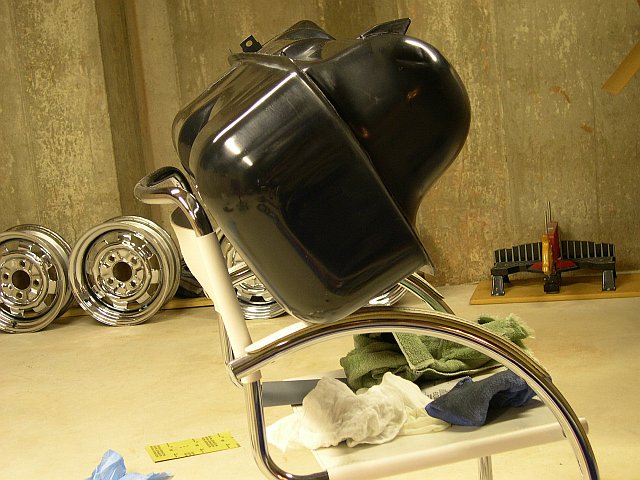

post Jul 9 2010, 04:49 PM
Post #59
Do I or don't I...........?
Posts: 5,900
Joined: 24-March 06
From: SE PA, near Philly
Member No.: 5,765
Well, I went through several days of 95-105 temps in the garage, but finished the wet sanding (2000 grit was the last).
Then I moved everything to my 62 degree basement for compounding. Two days lost, but probably 4 days gained overall.
Taking shape. All sanding & compounding complete. Polishing & waxing to take place tomorrow.
Looks pretty good so far, though I'm not 100 percent happy. Should be a damn nice tank after this weekend. Have you noticed that I work slowly & deliberately?
Here are a couple of pics from the "dungeon".
If I can get my original tank done on the inside, without destroying the outter finish, this tank will be redundant...and available.
Final pics should be available Sunday PM.
Pat
Tom_T
post Jul 9 2010, 05:06 PM
Post #60
TMI....
Posts: 8,321
Joined: 19-March 09
From: Orange, CA
Member No.: 10,181
So why aren't those chrome wheels on Fritz?
Tank looks superb! (IMG:style_emoticons/default/drooley.gif)
PS - some of the minute color differences which you & Tod are seeing in the black/dark grey on the tank, & dove grey on the FI intake runners/tubes - could just be color changes over 35-40 years of time &/or slight differences at mix batches at the factory from the outset.
