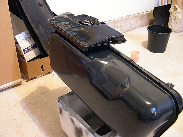

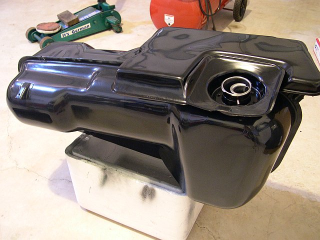

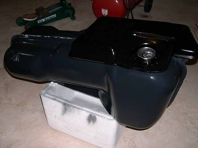

Refinishing complete! Jeez!
All it needs now are two new seals (don't trust the 40 y/o ones), some new fasteners, a new sock & to get it in.
The pics of the finished product are 1) with the flash , showing the diff between the tank and the evap chamberAttached Image. This shade is about 95% correct to my original tank.
The others are just fluff - tank came out pretty decent, though I have some issues and would do things differently.

Well Pat - it looks great on its own, but I can definitely see the color difference that you're talking about with them side-by-side, & I have to fully agree with your prior statements & frustration!
... which leads me to believe that for my tank's/evap's touch-up or repaint, I'll need to find a better color match! (IMG:style_emoticons/default/dry.gif)
You did a great paint job & finishing though! (IMG:style_emoticons/default/biggrin.gif)

(IMG:style_emoticons/default/blink.gif) your gas tank looks better than most peoples cars (IMG:style_emoticons/default/av-943.gif)
Kudos Pat (IMG:style_emoticons/default/beerchug.gif)

Very nice Pat. Tank appears flawless. Drop it in! Tom, if I understand Pat's post, it's the same tank just different camera settings.

Understood Tod, I was just commenting that when you see the repainted fuel tank & OE expansion tank side-by-side, that you can really see the difference in the paint color, which I agree is not a perfect color match as Pat said.
The 1st pic with the flash on really brings out the difference.

Scottster - thanks for the kind comments. I agree, not too bad for a rattle can version.
But, it is not perfect. I started with a 40 year old tank that was clean inside. The outside was a mess! The purpose was to make this tank a replacement for my original, if necessary. The original is ten times better in appearance than the replacement, but really ugly inside. If I can get the original steamed out without destroying the exterior finish the replacement becomes a boat anchor.
Can you do that? I'll bring it if you can.

You don't quite get it (read ealier posts). I was TRYING to get the gray-black finish on the tank. It's the same finish as my original tank for my 72. Yep, the expansion tank and filler collar were satin black, but the tank was gray-black (thanks Tod914!!!). And yes, I've overpolished everything - sorry.
Just hope I don't need to use this tank.

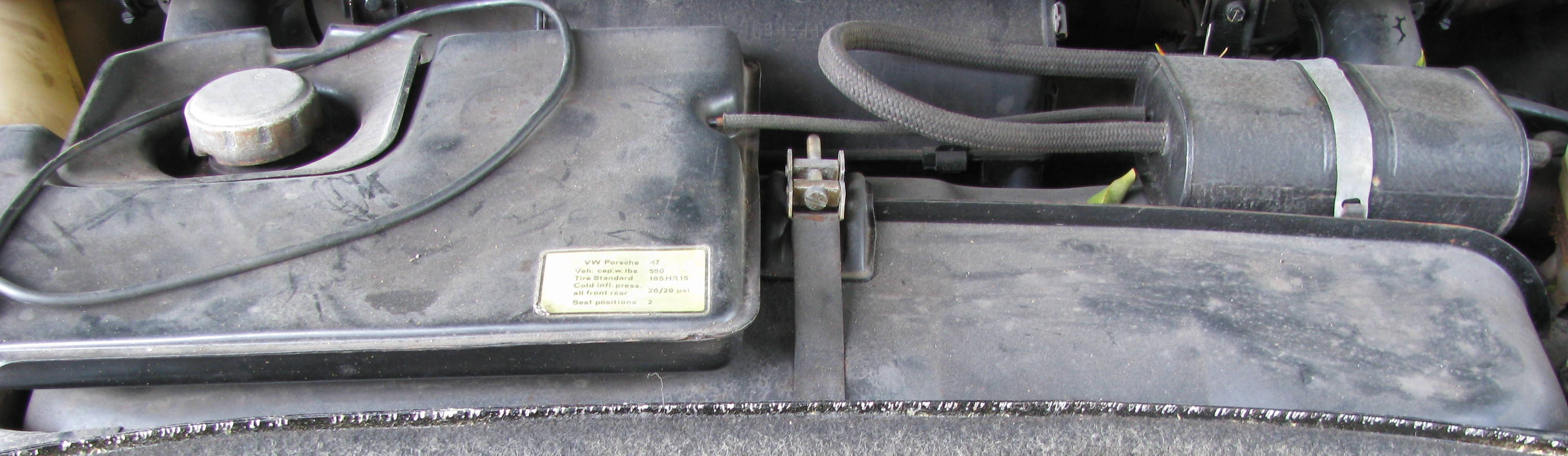

Pat - I just meant that in my 73 914-2.0's tank & evap appears both to be the darker satin black as is the evap in your pix, but I will do a side-by-side with the L43 to make sure. I'm pretty sure, because my tank & evap/collar appear to match colors/shades of black -but I will check it carefully & match to original color.
Wolfsburg West is about a 1/2 hour drive from me, so I can go in there in person if need be! (IMG:style_emoticons/default/biggrin.gif)
Unfortunately the only pic I have of the tank right now is still covered in 25 years of dust, but I wiped a spot off & they appear to both be the same black. If you were closer, then I might sublet it out to you, as the master tank restorer! (IMG:style_emoticons/default/biggrin.gif)
... as I said - reeeeaaalllly dirty now, as I'm still in the process of stripping the car to shell for the body work & rust repairs to media-blast/prime/repaint - so it's a detail item further down the road! (IMG:style_emoticons/default/shades.gif)
