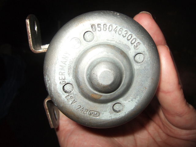

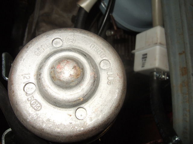

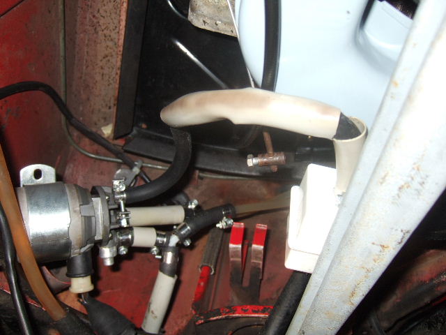

tod914
post May 26 2010, 08:28 PM
Posts: 3,755
Joined: 19-January 03
From: Lincoln Park, NJ
Member No.: 170
Here's some shots if you guys don't mind double checking my hookup. 1st is the line set up, then the new "hybrid?" pump, then the old bosch pump.
line set up; abit messy due to me pulling the pump off the mount
new pump case
old pump case

I have 2 3 port pumps - 1 Bosch in the car and a spare I got here. Thought I blew the Bosch, but I did not. Tested both last week. Both work fine.
BOSCH - it is hooked up as you show in your pic and it works.
Center hose goes back into the tank. S(upply) hose comes from tank with a filter inline pointing flow at the pump.
Hose from the engine does that triple t thing and hits the pump on the aluminum tip covered side opposite the S tip.
Think I got that right the second and third time I redid the hoses this spring.

Yeah, I'm the one that had the crazy Chinese fuel pump. As I e-mailed Tod, the ports weren't marked and the only way it worked was to switch the D & R lines. It leaked around the connector from the start and got worse. Sent it back to AA for an exchange under George's 2 year warranty and got a made in USA (California) rebuilt 3 port. So far, so good. Ports are marked and correct, no leaks, etc, but I've not taken the car for an extended drive yet. Incidentally, the new pump also has "Germany" on the bottom of the case. Probably they just refinish and reuse old good cases in the rebuilding.
