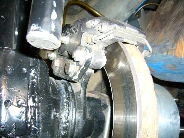

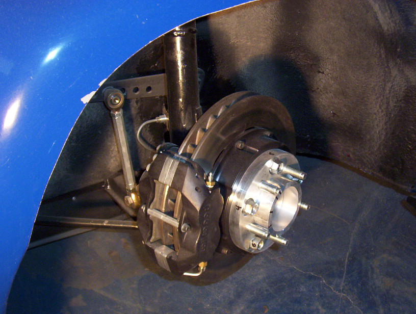

Hey Torque Junkie,
For my $$, you can't beat WILWOOD brakes! On my V8 conversion 914, I'm running 12.19" x 1.25" vented Wilwood rotors ($42 on summit)
(http://www.summitracing.com/parts/WIL-160-2895/ (left) &
http://www.summitracing.com/parts/WIL-160-2894/ (right)
and the 4-piston Dynalite Calipers (http://www.summitracing.com/parts/WIL-120-6804/) $125.
All you have to do is find the right aluminum rotor-hat to fit your application, drill them to you bolt pattern and make a very simple caliper mounting bracket.
Don't be scared! When I mount the rotors, I use a dial indicator to get them centered within 0.005" and tighten them up.
The bracket is also TOO simple..check out my pics and see.
BTW: I did ALL this fabrication myself in my garage with only a drill press and a wire-feed welder.
With the extra Chevy engine weight + driver, my rig weighs 2800 lbs and after a hard session on the Streets of Willow Springs, the front rotor only reach 420 deg. F., while the rears run at 300 deg. F.
Enjoy,
Terry

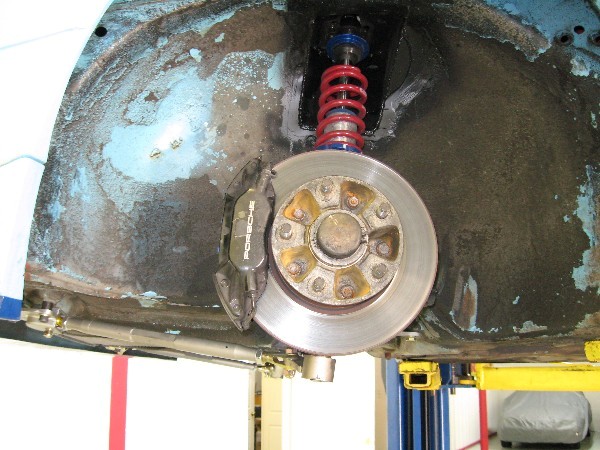

Depending how extreme your car is, and your use for it, the S caliper setup may be just fine. Regardless, you will not want to go any bigger in front without doing something in back as well.
You are most likely adding significant unsprung weight with any brake upgrade, so that also needs to be taken into consideration.
I don't need a setup as wild as Terry's since I have much less grip and aero and weight, but I may go to a Boxster setup when I add flares and go somewhat wider on tires. Right now I have a 911SC "A" caliper setup which is the same as your "S" calipers except steel vs. aluminum. It works very well on my narrow-bodied car.

Hi camaroz1985,
The rotor hats slide on the wheel studs.
In my case, I have adapter-spacers that bolt onto the Porsche 5-bolt pattern, retaining the rotor& hat with 5 studs sticking out in a Mustang pattern. Thus, I can set up the rotor position with a dial indicator, tighten the adapter and have the freedom to remove the wheels without disturbing the setup.
I could easily see 914s using Porsche-Porsche pattern spacers to do the same thing.

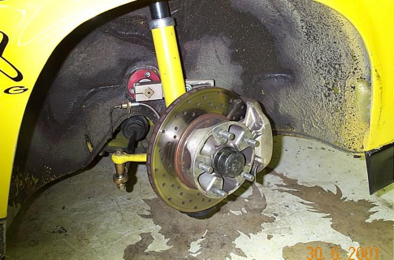

Hi Rick:
I'm running the same 911 hubs as in the photo of the Yellow 914. For rotor hats
I'm using Wilwood P/N 171-3758 in front and P/N 170-0764 in the rear. Per the Wilwood Drwg, the ID of these hats is 6.82". I drilled the 911 pattern holes in the hats on my drill press allowing a loose fit. Then I sandwiched the hats between the 911 hubs and my wheel adapters, snugged the nut a bit and then centered the hat/rotor assy with a dial inidcator (Harbor Freight has been selling them for $7).
I hope this helps,
Terry

just to add to this, I have 993 rear calipers on the front of both my race and Targa cars, stock carrera rears on the back. I really like the brake feel - feels like my 993 street car, and can out-brake anyone on the track. No fade, no heat problems, nothing. Use Hawk Blue for racing, straight Porsche/Mintex for street.
Rotors are stock from the 5 lug Carrera set up I took them off of. (yes, my wheel wells could use some cleaning up)
