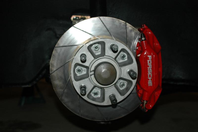

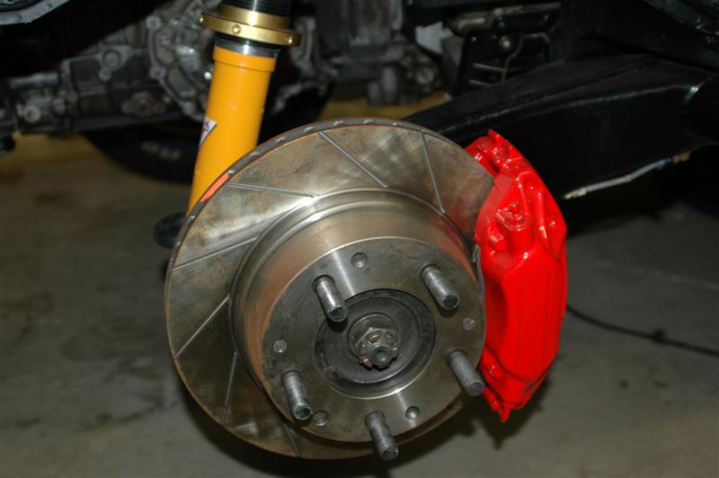

OK..there are lots of brake "upgrades" that can be done. I feel that the "big reds" are overkill for a 914. What I used on my six conversion is this. I built it for DE's and maybe future club racing, but most of the miles will be street miles.
Front: C2 calipers, Carrera slotted rotors that were "frozen", Hawk street pads for the street and Hawk "blue" pads for the track. The front brakes are cooled with a cooling kit and block off plates.
Rear: C2 Turbo calipers, Carrera slotted rotors that were "frozen", Hawk street pads/"blue" track pads.
19mm master cyl. and Tilton proportioning valve.
Some may agree/disagree with this setup, but it has worked great at the three DE's I've been to with no fade and great stopping power. Using 15" wheels with this set up.....
Fronts:
Rears:
