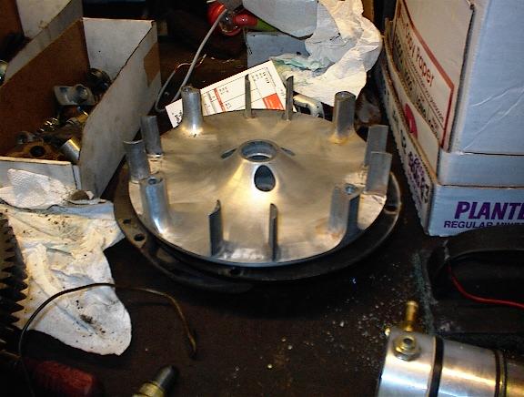

Just separated the fan wheel from the big steel pulley ring. FYI, it takes the same 8mm 12pt bit that the CV uses. They were harder to get out than the CV bolts.
Anyway, I don't think I have a saw or airtool that will get in-between those blades. There is only like 6mm in between. Any suggestions?

pliers or a screwdriver...the blades should break off near the bottom.....

Lotsa racers do it so the engine will rev better...
Dave, I imagine this would work:
(IMG:http://www.powertoolsonline.net/ProductImages/tools/1051-1100/TL1052.jpg)
usually called an air body saw, basically an air powered mini sawsall...useful for many other things also...

I removed some of my blades. I'll post a pic tonight. One was already broken off so I removed the one across from it to balance it out.
The thorey is it will make the fan lighter but you'll be removing very little weight by removing blades. Crank, rods, pistons, flywheel are where the bulk of the weight is.
An aluminum blade don't weight much.
I know, I know, every oz counts. Look who's talking. (IMG:style_emoticons/default/laugh.gif)

there are many who feel the OEM fan is -too- efficient for high speed operation, and actually tries to pump more air than can be pushed through the available openings. it's not efficient to compress air wit this kind of fan.
so the racers remove 'some' blades to balance the air delivery with what can be squoze out.
so it doesn't cool any worse at the high speeds that race-track cars operate at, but it does consume way less power.
they do tend to run hotter at idle.
in general (broadstrokes generality warning) aircooled engines are overcooled at idle so they'll be at proper operating temp at cruise. watercooled engines are undercooled at idle which is why they used to have so many overheating in traffic problems - before the widespread adaptation of the thermostatically switched electric fan. pretty much for the same reasons - it takes a lot of power to turn the fan...

the stock fan is made to run optimally at <4000 rpm. A race motor lives above 5000 rpm where the fan cavitates and looses efficiency. Removing blades puts less of a load on the motor and allows better flow at high rpm.
Its really not about weight.
The pic is not what mine looks like.... yet.

They air moves differently through the blades and my computer sensors pick the air up as imbalance. I have to make a cover for the fan inlet and cover the blades with masking tape to actually get balance numbers...

The balancer rotates at 500 RPM, but the air disturbs it enough to aggrevate me.

Is there a optimal number of blades to remove?
What pattern do you use?
I had previously see the pictured blower blade, but I thought it excessively radical.

I normally remove every other blade, but have ran some with only the 4 impellers that hold the fan together!
My track fan for my car has every other one removed...
