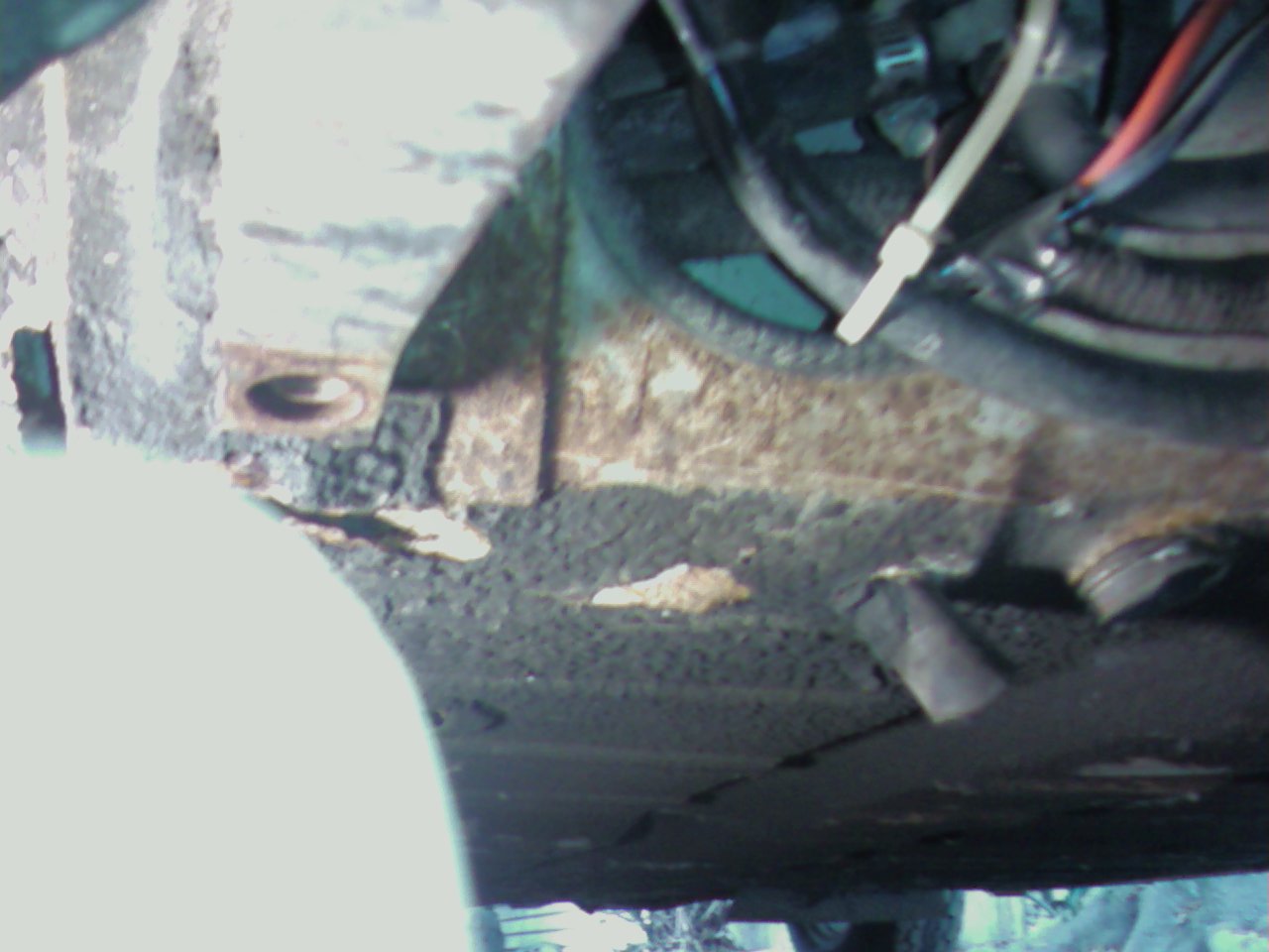

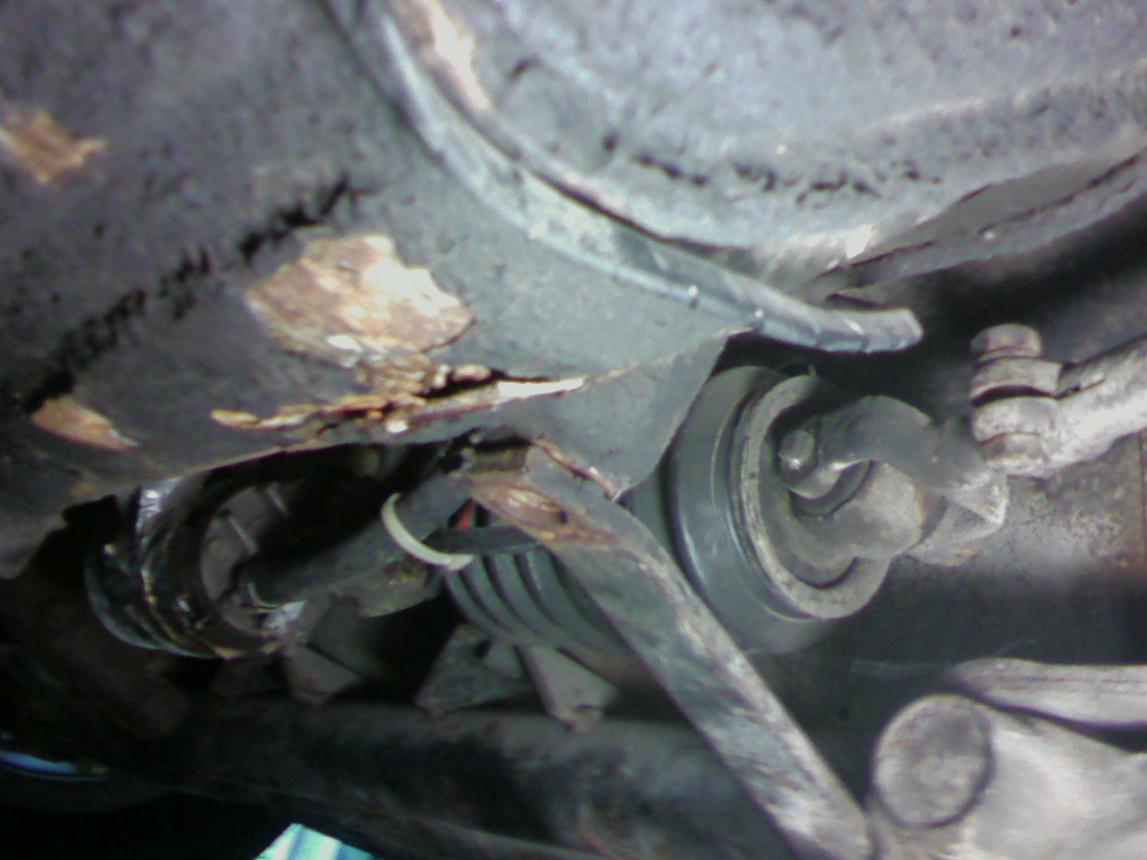

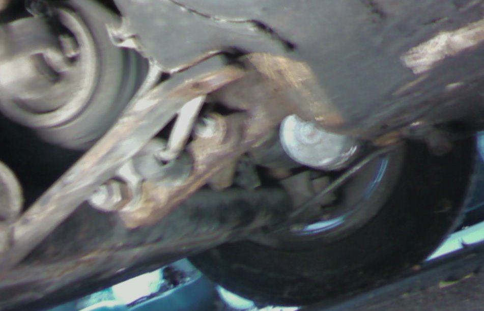

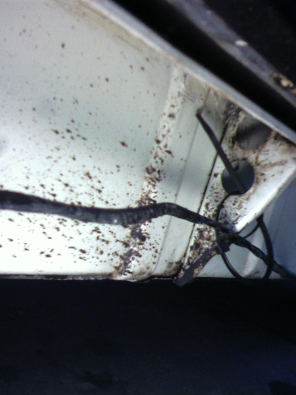

Here are some pix from mine as I'm opening it up for the resto, but it's not pretty after sitting on blocks in my garage for the past 25 years - so "please excuse out dust, rust & grime!"
- FP wiring behind pass. rocker cover panel
- Looking at FP from behind F pass tire side
- FP connections at floor pan/tunnel access portal
- Looking at FP from behind F driver tire side
