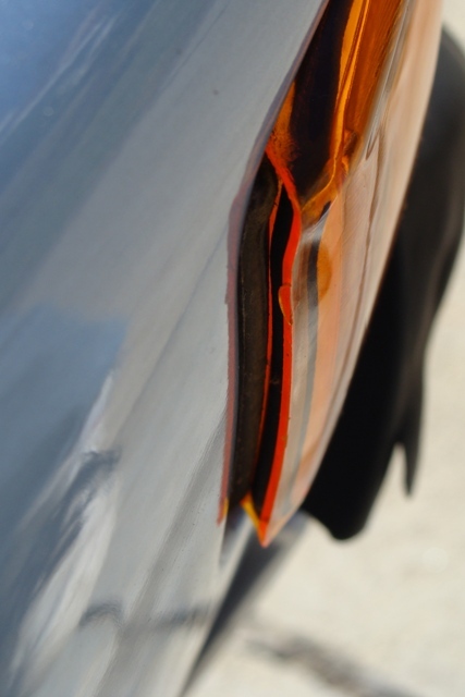

post Feb 26 2011, 04:46 PM
Post #470
Posts: 328
Joined: 10-March 08
From: Thousand Oaks, CA
Member No.: 8,791

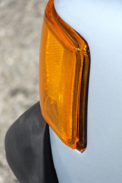

Passenger side didn't fit as well as the driver side. Both are on fine now though.
Before:
(IMG:http://www.914world.com/bbs2/uploads_offsite/i185.photobucket.com-8791-1298760588.1.jpg)
After:
(IMG:http://www.914world.com/bbs2/uploads_offsite/i185.photobucket.com-8791-1298760405.2.jpg)
Much better. Put all new LED bulbs in but I didn't spend the big bucks on the 40+ bulbs and just got the 19's. Works and lights up quickly like LED's do but does not fill the lens.

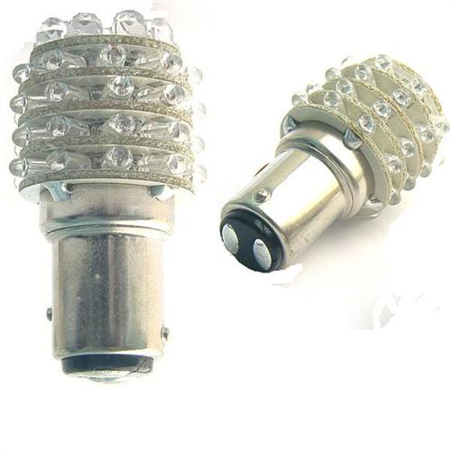

yupp, that's pretty clear - you use a LED type that only emittes light in one direction
much better when using this type:
a friend already uses this one and it fills the lenses just the same than standard bulbs

post Feb 27 2011, 10:35 AM
Post #474
Posts: 328
Joined: 10-March 08
Member No.: 8,791
Yes the gaps are present. I was going to wait for a hot day and tighten the out side screw slowly and see if it starts to conform.
(IMG:http://www.914world.com/bbs2/uploads_offsite/i185.photobucket.com-8791-1298824825.1.jpg)
(IMG:http://www.914world.com/bbs2/uploads_offsite/i185.photobucket.com-8791-1298824825.2.jpg)

Guys!
I had the same problem for 5 min, till i walked around the front and looked back. I noticed exactly what you are pointing out. All i did was remove the nuts, tuck the outside edge in first tight and smooth. (sorta like installing the lense at a 30 degree angle) and then while holding the outside edge into position... i slowly pressed the lense flush and attached the plastic nuts. It was the same for both sides.
They fit perfect after i did this procedure on both sides.
