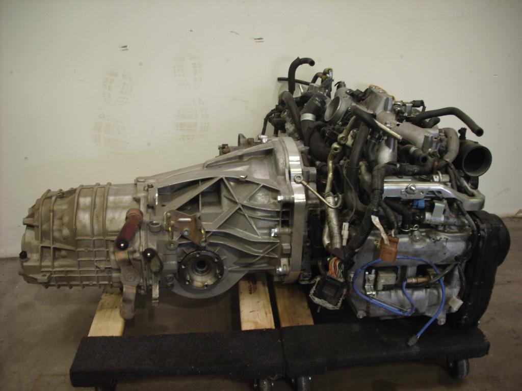

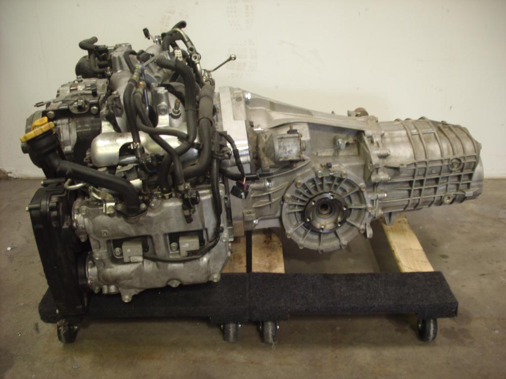

I know there may not be a lot of people on here who will be interested in this for their car, but it will be nice to have more options for people who want more power, and a modern shifting mid-engine transaxle. These pictures are of a 6 speed version, but the 5 speed will use the same adapter plate and flywheel.

daveyboybadion

the shoe prints on the wall - big distraction : )

Did you have to notch the bellhousing to get the starter to fit?

QUOTE(andys @ Jul 26 2010, 04:36 PM) *
Andys
Yes

I wonder what is the torque specs for the boxter 6 speed and what is the first gear ratio? If the boxter 5spd is higher than 300 ft lbs torque rating it may be a worthwhile investment. It costs about 3500 to upgrade a suby 5spd I think to handle 450 ft lbs where the case becomes to weak part. At any rate it is nice to have a alternative as this should also fit the suby 6. What is the distance from the center of the axle to the motor bellhousing flange? The adapter also appears to move the motor further forward which is good I think. Also the tranny looks more robust in the case webbing than a suby tranny.

will this use the cable shifter from the Boxster? or a custom setup?

QUOTE(tommy914 @ Jul 27 2010, 07:52 AM) *
I'm pretty confident I can make the stock Boxster cable shifter system work in a 914, but won't know until I try. Cable length will be the deciding factor. Regardless, there's no reason not to use the shifter itself. It would just be a matter of some custom cables. The first conversion will happen in a Boxster S that will be a track car. As long as all goes well in that car on the track, I will venture out to a 914 chassis.

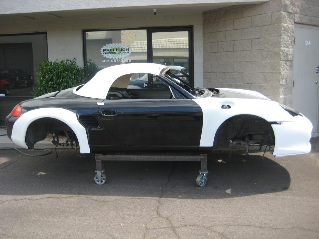

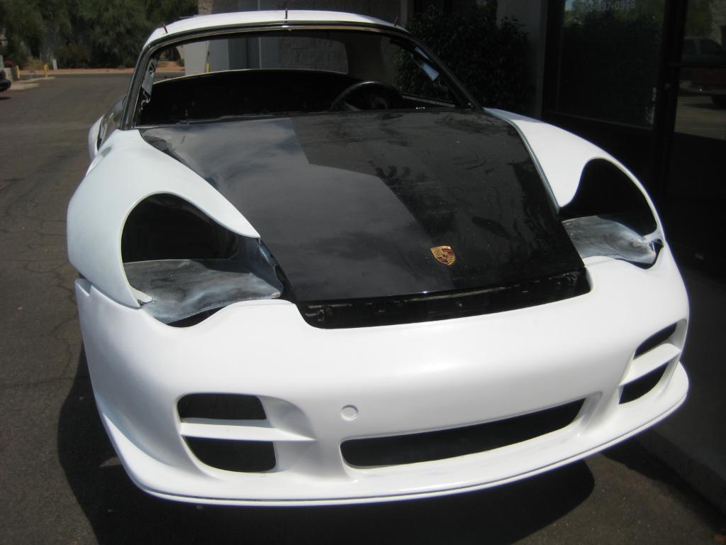

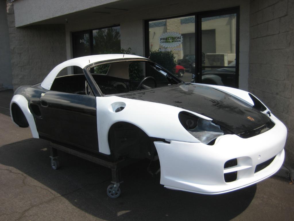

New body work mocked-up on test car...
