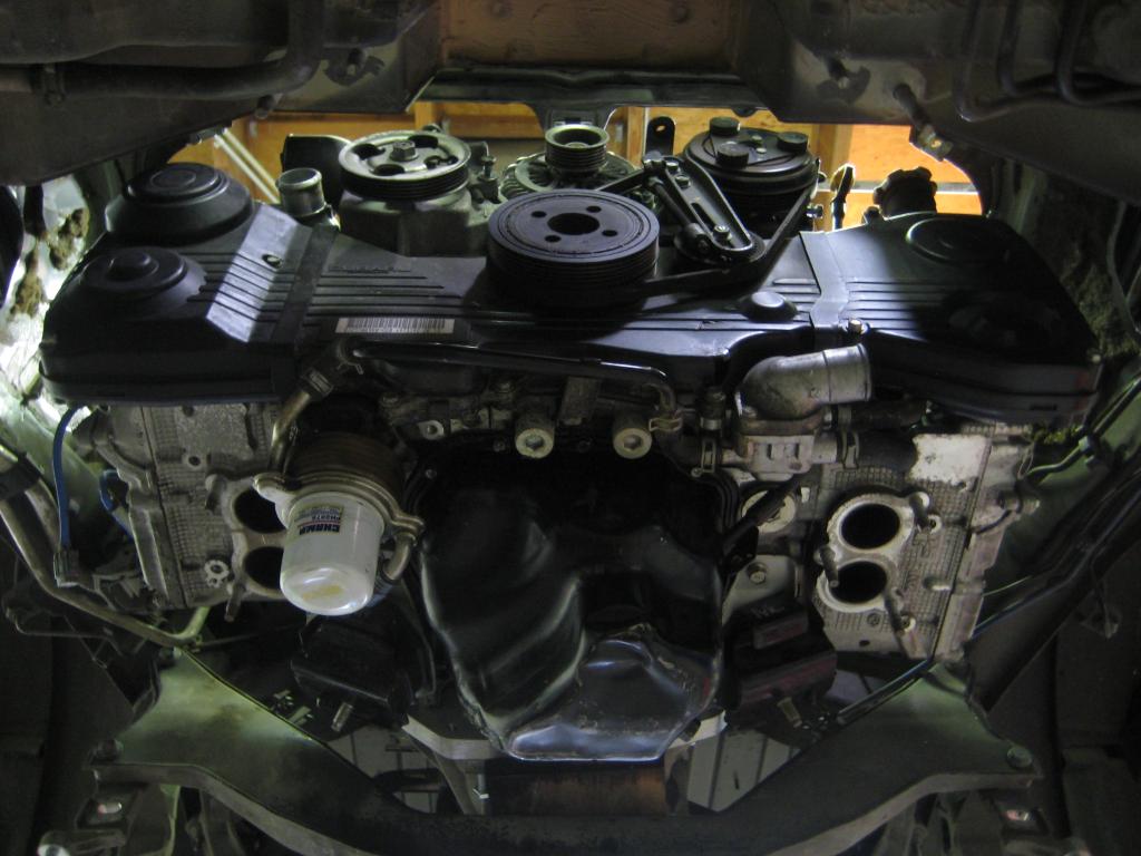

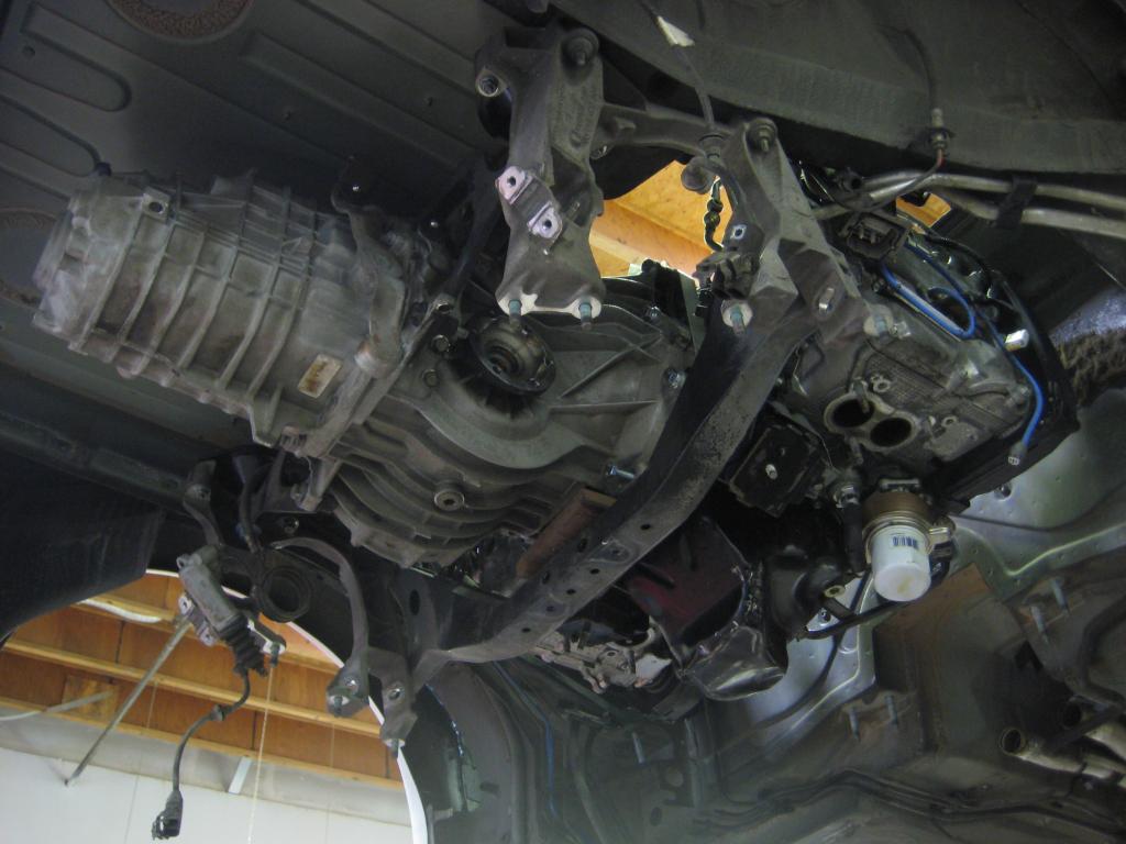

I know there may not be a lot of people on here who will be interested in this for their car, but it will be nice to have more options for people who want more power, and a modern shifting mid-engine transaxle. These pictures are of a 6 speed version, but the 5 speed will use the same adapter plate and flywheel.
(IMG:http://www.914world.com/bbs2/uploads_offsite/i180.photobucket.com-11979-1280185725.1.jpg)
(IMG:http://www.914world.com/bbs2/uploads_offsite/i180.photobucket.com-11979-1280185729.2.jpg)
(IMG:http://www.914world.com/bbs2/uploads_offsite/i180.photobucket.com-11979-1280185731.3.jpg)

andys   Did you have to notch the bellhousing to get the s...   Jul 26 2010, 05:36 PM
precisionchassis   Did you have to notch the bellhousing to get the ...   Jul 26 2010, 05:42 PM

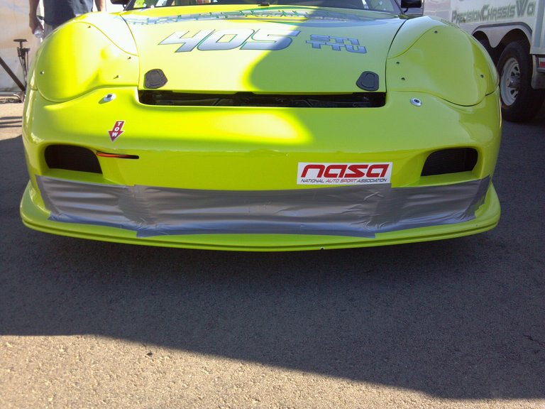

precisionchassis   New body work mocked-up on test car... http://www...   Jul 29 2010, 03:54 PM

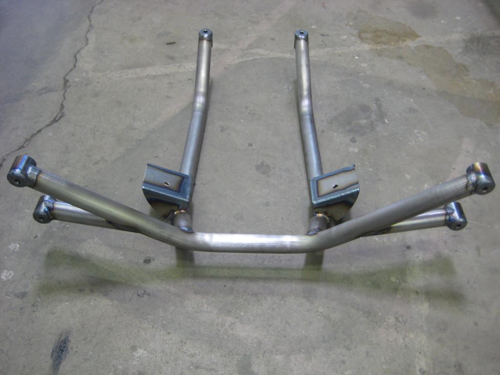

precisionchassis   Prototype motor mount/cradle is finished. It mount...   Aug 14 2010, 05:37 PM

RJMII   That really does look like it belongs there. :)   Aug 14 2010, 06:49 PM
precisionchassis   Yeah, the 914 will be next.   Aug 14 2010, 07:02 PM
okieflyr   That is a cool conversion. But now I'm going t...   Aug 14 2010, 08:20 PM
jimkelly   sweet cradle : ) love all the photos of the boxst...   Aug 15 2010, 07:53 AM

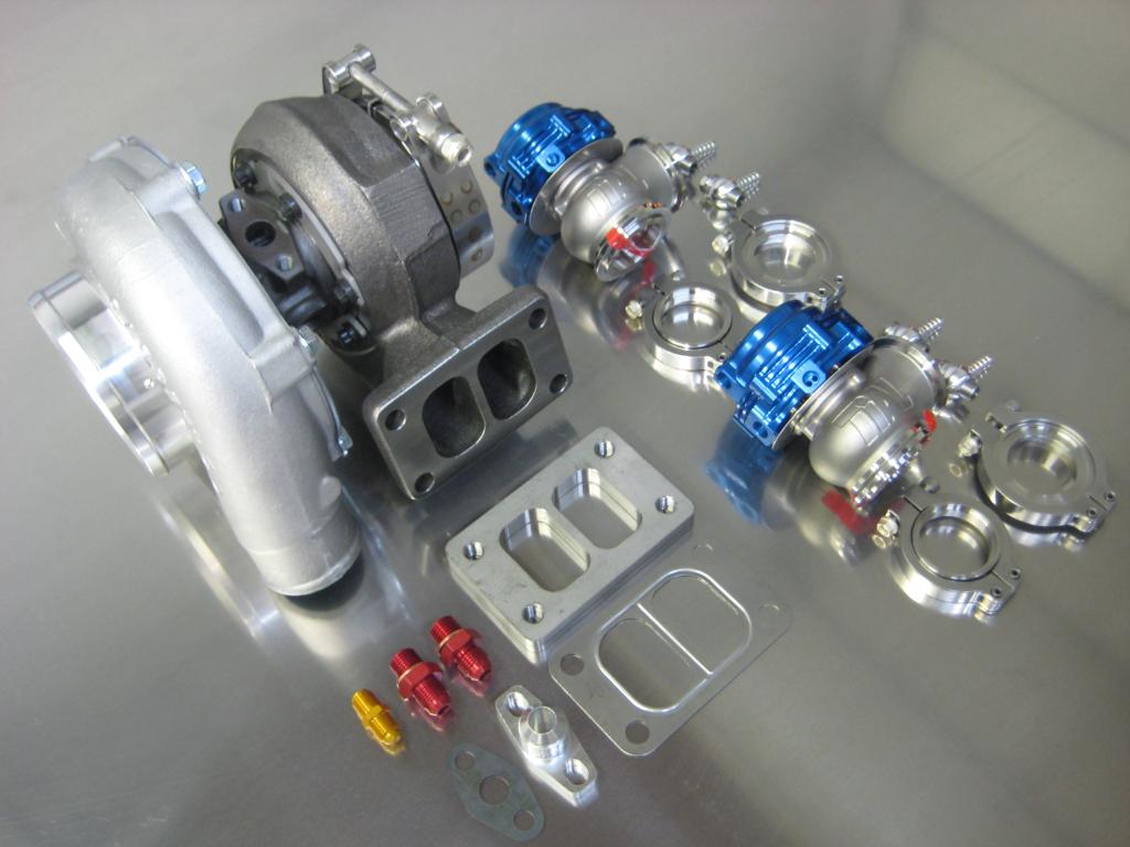

precisionchassis   Turbo and supporting pieces... http://www.914worl...   Aug 25 2010, 04:06 AM
Phoenix 914-6GT   Wow.... you do some very nice work and use choice ...   Aug 25 2010, 01:42 PM
charliew   Twin scroll, will you be able to use a factory hea...   Aug 26 2010, 03:44 PM
precisionchassis   Twin scroll, will you be able to use a factory he...   Aug 26 2010, 05:30 PM

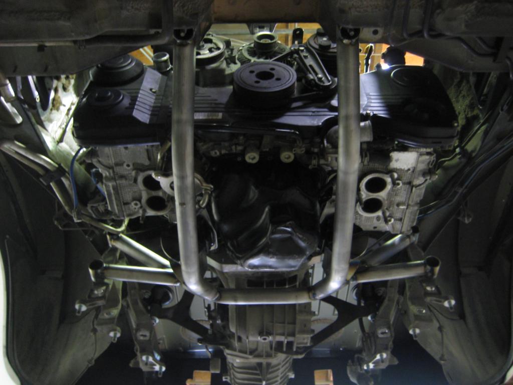

precisionchassis   I finally got the exhaust finished today. I'm ...   Sep 3 2010, 07:59 PM
Zaney   I finally got the exhaust finished today. I'm...   Sep 4 2010, 09:15 PM
Rotary'14   :blink: :drooley: :drooley: That's a work ...   Sep 3 2010, 08:03 PM
charliew   The welds look good. Do you think the long tubes w...   Sep 3 2010, 09:23 PM
precisionchassis   The welds look good. Do you think the long tubes ...   Sep 4 2010, 09:37 AM
ottox914   The welds look good. Do you think the long tubes ...   Sep 5 2010, 06:58 AM
