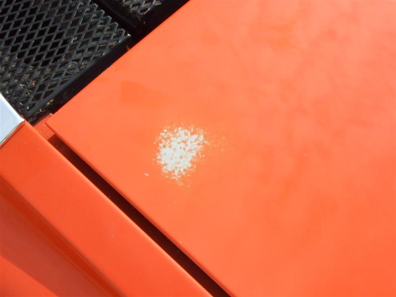

FWIW, the original paint seems kinda thin... a local teener used a buffer on his original car recently.. with only a few seconds too long in one spot, his orange paint faded in the spot down to primer...
so be careful with an electric buffer...

yes, that looks like more than a few secs with a cutting paste. With the 3m products esp their polish is hard to do that! The buffing pad does alot of the work as its wool so a little bit of the polish shines up most paint

If using a high speed wheel, it's important to know a few things.
First, don't attempt unless you've been trained and have done it before. No way in hell I'd attempt on my car unless I practiced a bunch on a junker ect. You can burn through just like in the pic above in a moment.
