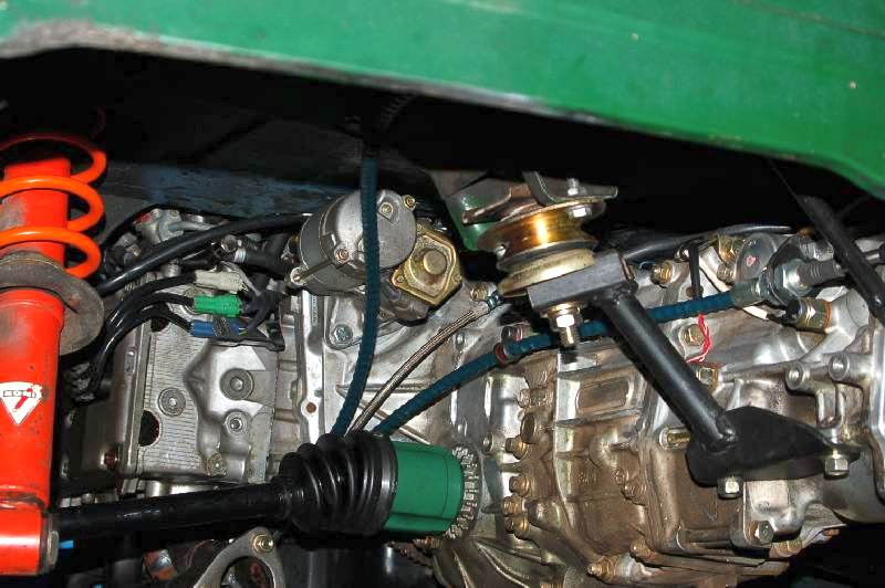

I'm having mine sent to Dutchman Motorsports. Using everything you're suggesting.

Had Dutchman do the work for me also. I used 911 axles and had them cut for the subaru inter CV. The 911 axles are far bigger diameter than the subaru axles.
I have also found a shop in the Atlanta area that can do the work at about half the price
