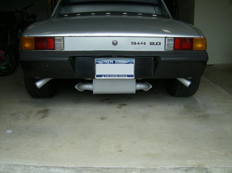

So now it has 96mm KB pistons and AA cylinders (which, BTW suck. AA used to have decent cylinders). It is now a 2056 with 40IDFs and what appears to be an old S&S exhaust setup. I put the lowest profile tires I could find on the crappy set of cookie cutters we had.

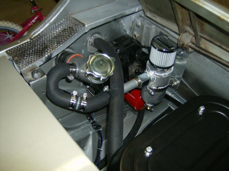

tomeric914   Update: Finally done with the breather. There...   May 28 2011, 11:06 AM

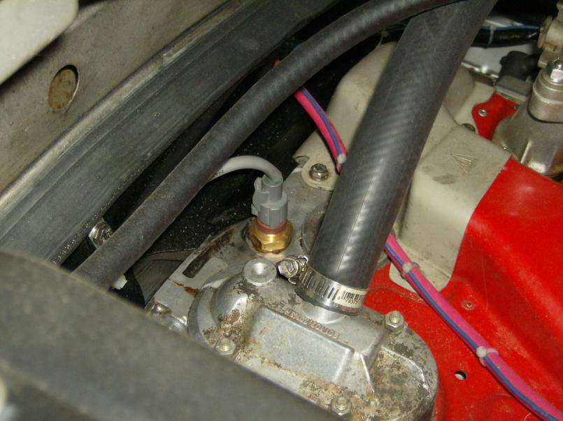

tomeric914   My solution to turn the oil cooler fan on: Honda ...   Jun 15 2011, 09:27 PM

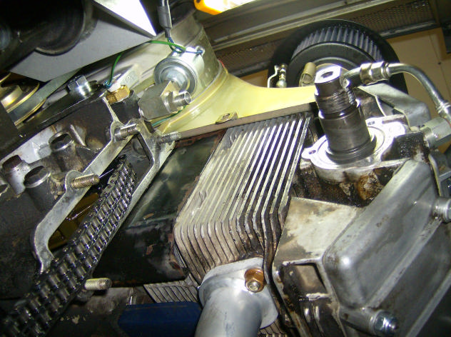

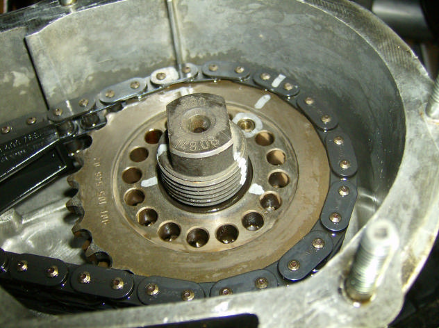

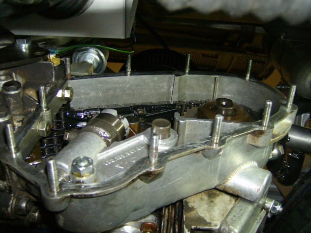

tomeric914   So I tackled the oil leaks from my chain boxes wit...   Jun 26 2011, 09:16 PM
