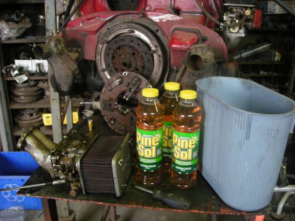

With the release bearing exploding in my '67 bus, taking out the pressure plate I decided now was the time to clean and service my Weber 42 DCNF's...of course I got carried away and had to clean my /6 40 IDA's as well. I've been reading on the internet (and I've heard mention of it here) about using Pine-Sol cleaner to clean carbs, so I felt i'd document my job for this site.
Pro's: it's very cheap and most important it cleans like a champ!. (IMG:style_emoticons/default/smilie_pokal.gif)
It's amazing how well it works in all the nooks and crannies.
Although it's slightly caustic it's no where near as nasty as most carb cleaning chemicals and it doesn't seem to hurt rubber parts like diaphragms.
Nice fresh pine scent .
Big safety plus it's Nonflammable!
Con's: It does seem to react with cadmium plating, it doesn't seem to bother the Weber plated parts too much, but my Gene Berg DCNF stacks really reacted to it.
Leaves a film on brass parts, remove them or you have to polish them afterwards, but it does not harm them.
It smell's like pine, real strong, in fact it smells like the janitors room. If you have an attached garage I'd do it outside.
You will get it on you and you will also smell Pine-Sol fresh, wear the gloves and some old clothes.
Loses it's "oomph" after about 3 days, I got 3 carbs done.
You must fully immerse the parts or it can leave a scum line.
You really need a compressor to blow out the passages when done.
No real rocket science here, I got the Pine-Sol and mixed it 2 parts Pine Sol to 1 part water. I used 4 liters (quarts) of pinesol. I found that this plastic waste basket was just the perfect size for the IDA /6 carbs. I had a handful of latex gloves, a couple of toothbrushes, some tools, compressor,
a table and a bag of rags.
You must throughly rinse with water and dry (blow out) the carbs when done.

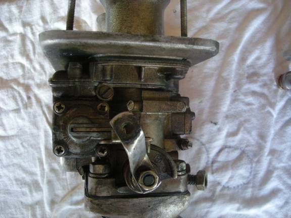

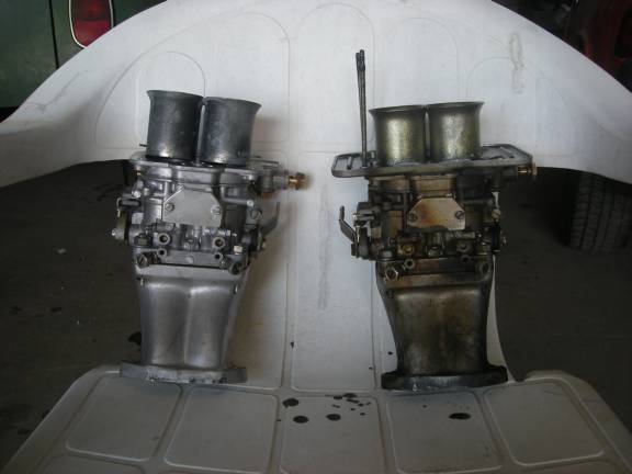

My first victim of neglect, I haven't cleaned these puppies in at least 4 years (IMG:style_emoticons/default/rolleyes.gif)

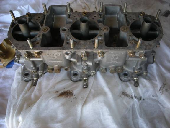

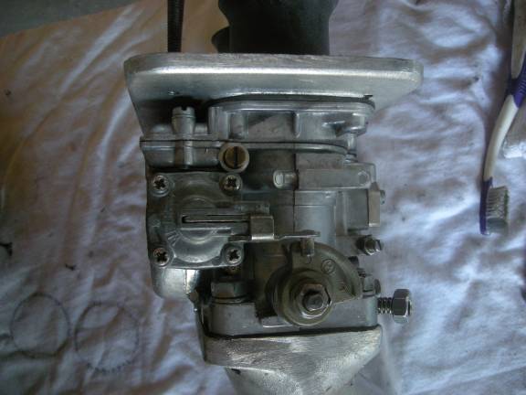

I'll get right to the before and after shots (IMG:style_emoticons/default/shades.gif)
Got to love that pine freash scent!.....oh fuch does it sell like pine! wow that's strong! (IMG:style_emoticons/default/blink.gif)

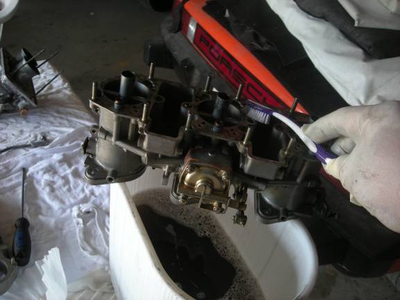

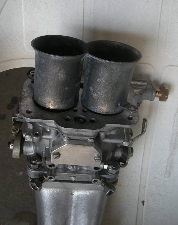

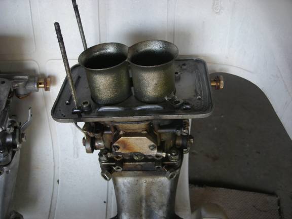

Let it soak, I tried it overnight but really you only need to soak it for a couple of hours.
It doesn't need much help, but you still need to do a once over with the toothbrush.
Note on this one I didn't even take it apart till it had soaked a bit.

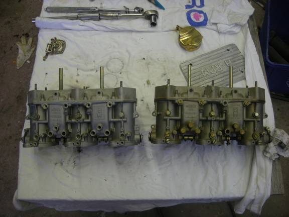

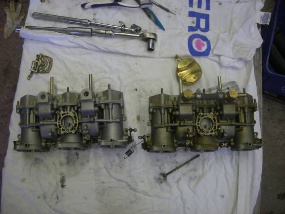

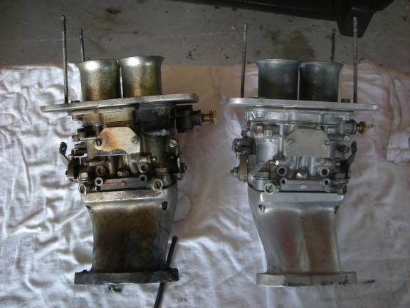

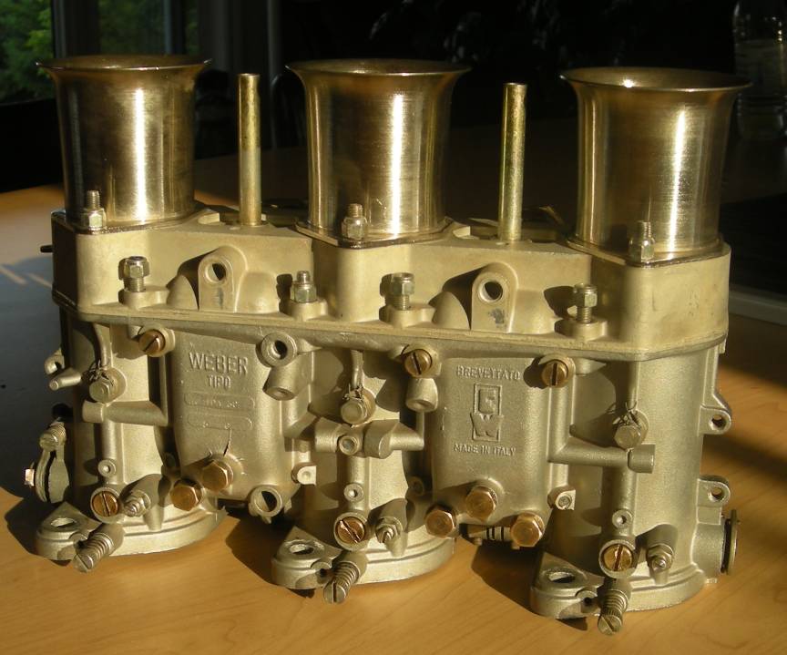

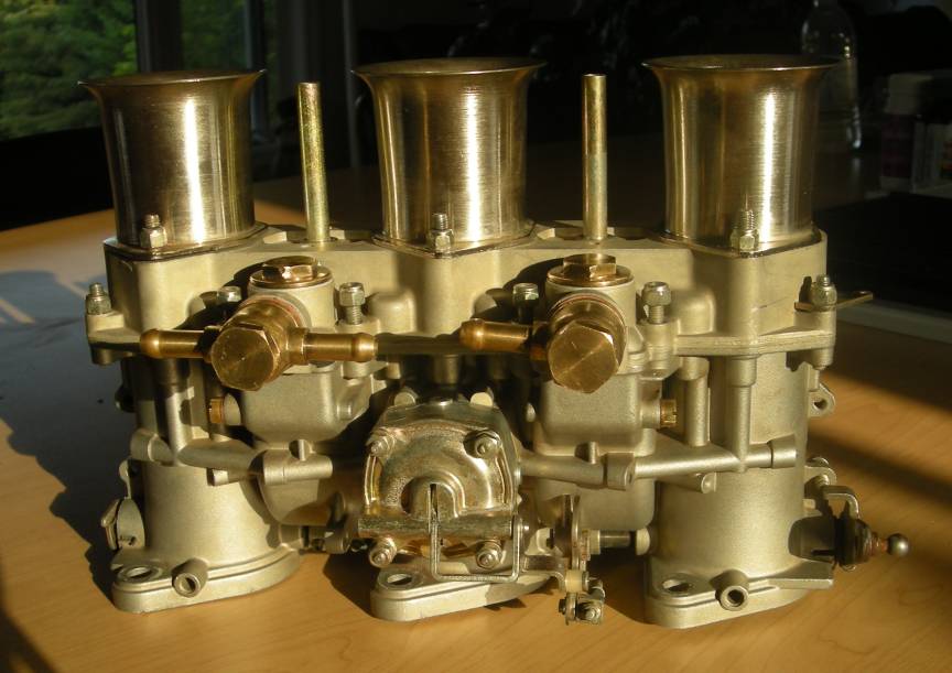

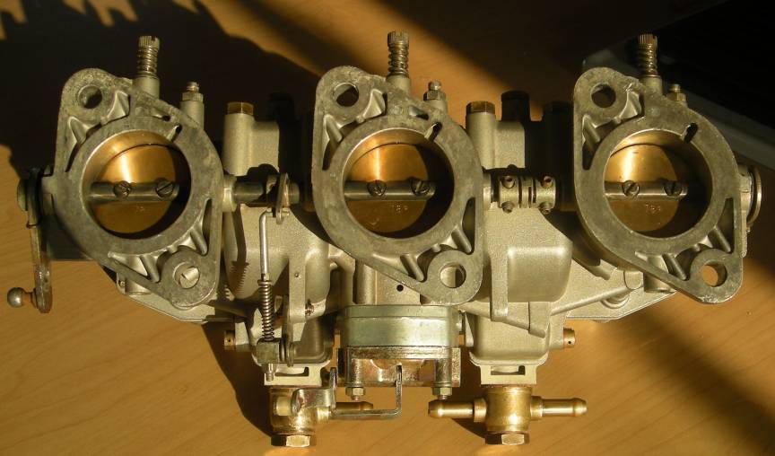

Before and after pic's of the 40's
Mark Henry
post Aug 1 2010, 09:30 PM
that's what I do!
Posts: 20,065
Joined: 27-December 02
From: Port Hope, Ontario
Member No.: 26
Although the 40's don't look that dirty they are. That dirt you see is from the bowls

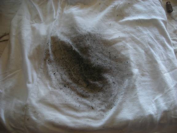

This is the filth from one carb. (IMG:style_emoticons/default/icon8.gif)

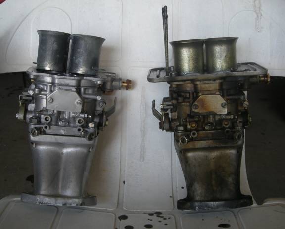

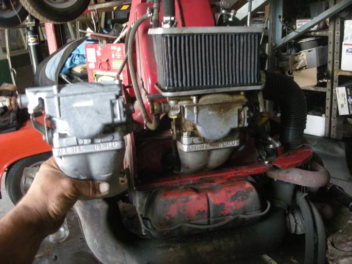

Here's the bad, first this is not a Weber OE part. They are stacks that were made by Gene Berg, I don't know for sure if it is cadmium plating but it reacted strongly with the Pine-Sol.
The one on the right is how it should look, but I did notice till it was too late that it was turning black. the second one I watched carefully and it started to bubble right away. Within a couple of minutes it went from a goldish colour to silver. If I had of left it in much longer it would have gone black like this one. So far I haven't been able to remove this tarnish.
So you should test small areas before you dive in.

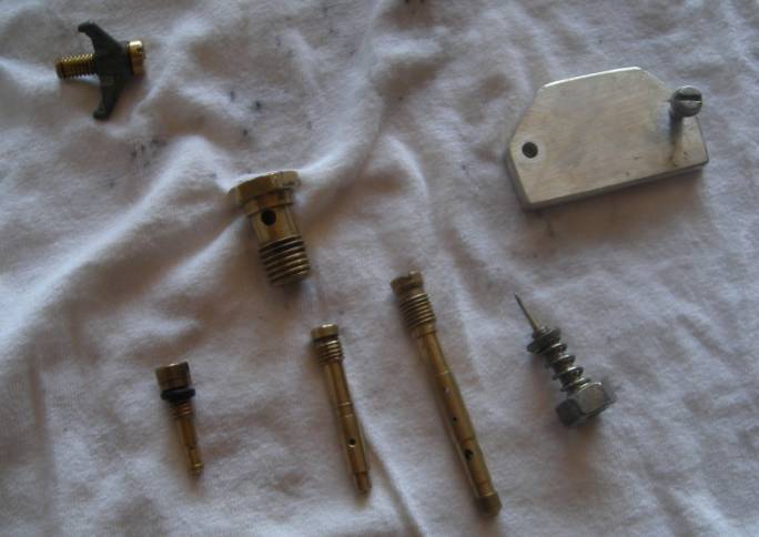

Once I had them clean I throughly rinsed them in water and blew each part out.
The jets didn't come as clean, but with just a few seconds of polishing them with a rag they were clean as a whistle.
