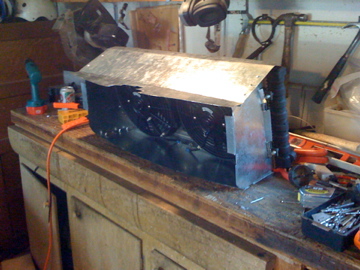

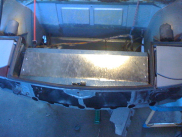

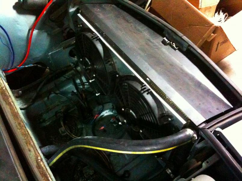

malaga_red75   So, I re-did the cooling system, bringing the fans...   Aug 10 2010, 10:37 PM
kg6dxn   So, I re-did the cooling system, bringing the fan...   Aug 10 2010, 11:00 PM
malaga_red75   Looking at your picture, You may also want to c...   Aug 10 2010, 11:39 PM
kg6dxn   Looking at your picture, You may also want to ...   Aug 11 2010, 07:45 AM
