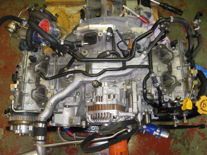

QUOTE(malaga_red75 @ Aug 14 2010, 07:35 PM) *
budman-
First, when i did the tstat test, the new thermostat opened much quicker than the old. However, once both were open, they looked like they had opened the same amount. so, despite realizing that the thermostat was fine, I installed the new one anyways.
re: recirculation lines
I guess my answer is that no, I do not have any return lines to the engine while the Tstat is closed. My expansion tank is connected to the heater return line (just on the inside of the thermostat) and then there is the incoming radiator line on the outside of the thermostat.
Basically, I fill the system via gravity through the expansion tank into the heater return line... then the fluid goes through the engine, out to the radiator, then back to the thermostat.
So, how would I setup the system to have a recirculation line? If I used the heater return line, say connected to a port at the top of the crossover pipe, where would I run my expansion tank?
I only know of 1 recirculation line, which is just on the inside of the heater return, which is where my expansion tank is currently hooked up. where is the second?
Thanks budman, I know you know your subaru stuff. especially cooling, living in AZ.
-Peter
Peter YOU NAILED IT! congrats! Get that recirculation line back and your problems will be SOLVED!!
There should of been two tubes that go to the stock subaru heater core when it was in the stock subaru car. These are at the rear drivers side of the engine when you have the subie in the 914. Just put those back, put a loop so basically you loop the coolant back to the thermostat. Whatever way you get the top manifold on the engine (hot water) to loop back and feel to the inside engine side of the thermostat is the route. You can T into this line for your expansion tank. When flowing it will just run past your T in the line and back to the water pump. The T in the line will be good for filling and expansion to the overflow etc.
budman5201
post Aug 15 2010, 01:31 PM
Post #39
Posts: 595
Joined: 1-April 07
From: tempe, az
Member No.: 7,635
here is a stolen pic from STI progress thread. shows the route of a turbo recirculation lines. You just need the one the runs from the manifold top and back down the top of the block, through the front area of the engine and to the water pump.
-Peter
Cool, I think I understand. I actually removed on of the pipes, but the other one (the one that comes directly off the crossover pipe) will work just fine. I will get a T fitting, and basically run from there down to the tstat and have it T off up to the expansion tank.
But will this help after the tstat is open? Or are you saying that because there is no circulation, it is constantly trying to open then close then open...etc.?
-peter
budman, i got your message, i might call you tomorrow, but i think i got it figured out.
