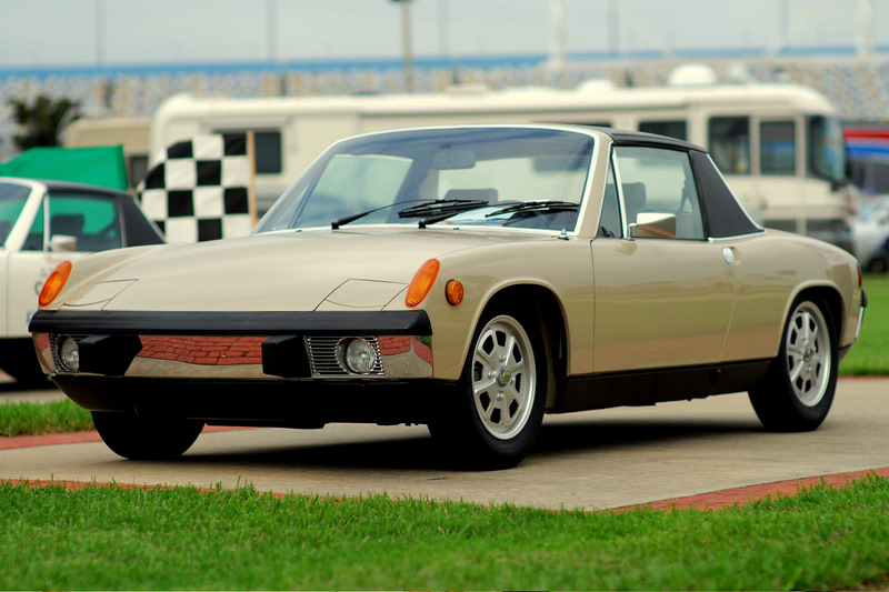

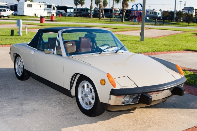

Here's a couple of shots of Steve's Sahara Biege with & without - or before/after his months of undercoating removal - FYI same car with & without for comparison!
